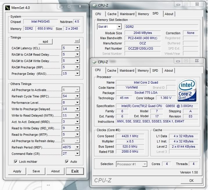

Have some questions to ask. The bios vcore's set to 1.33, but in cpuz, my cpu vcore under load's reflected as 1.30. Which is the true reading?
So i got my q9550 to 471x8.5 stable @ 1.3v (cpuz), but i suspect it could be lower - i'm still quite lost with all the mch/vtt settings. I noticed that at 471FSB, my chip is unstable as hell if my mch is @ 1.3, but once i bump the MCH up to 1.32, it runs 50 rounds of LinX w/o issues.
Any ideas how i can proceed from here to tweak the oc?

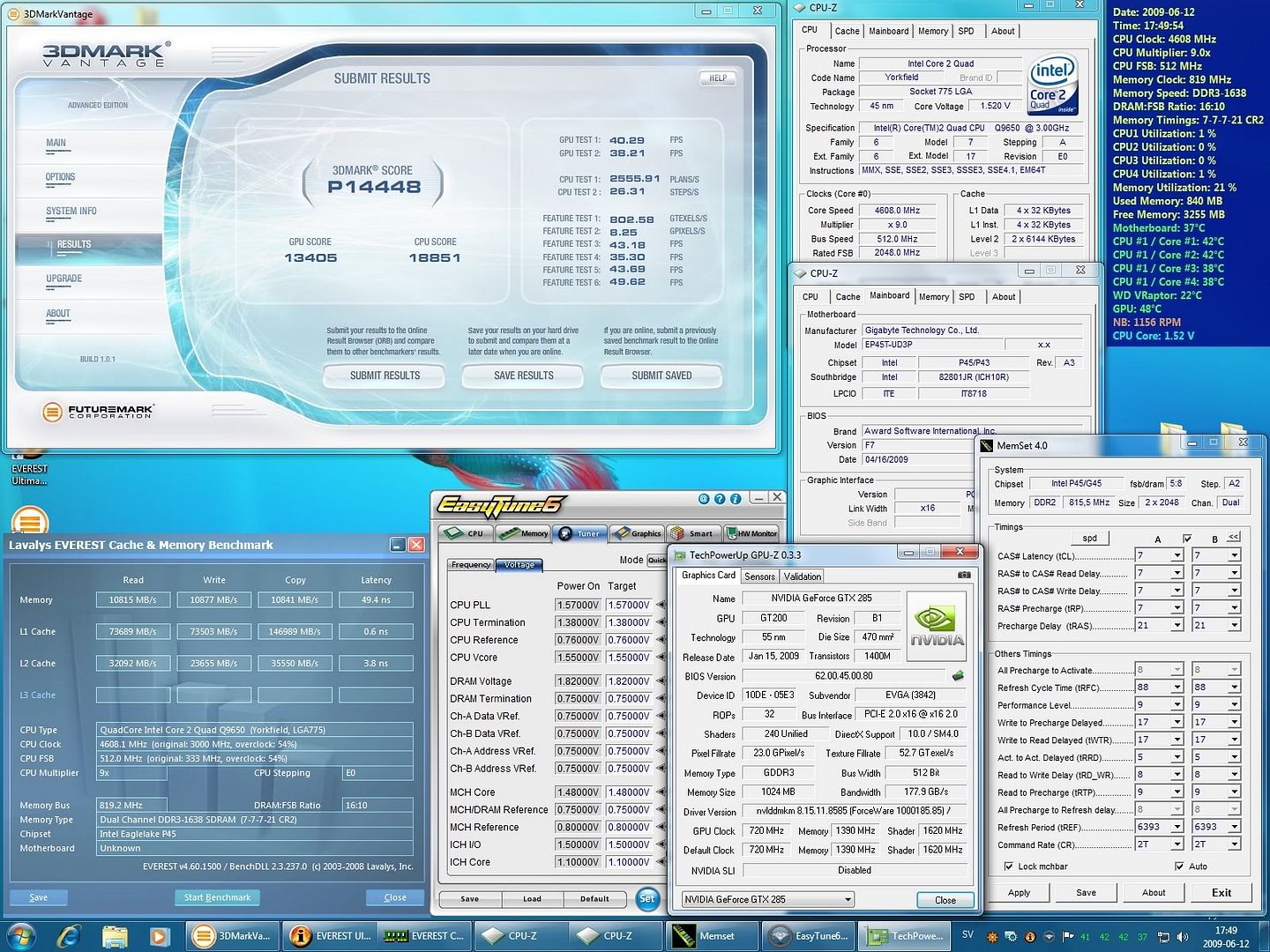

Here ya go, 500*9 @ 1250 5-5-5-15 PL8 in standard mode. Ill run it in turbo later to see if it makes a difference, last time I checked it was only maybe 1 sec faster than standard and virtually no difference in bandwidth. I only have the trial version of everest so I cant post the pretty blue benchmark screen. :( If you really want I can post pics of the individual tests, but its does 10423 R, 10640 W, 10789 C and 49.2 L. :up:
http://i131.photobucket.com/albums/p...mapImage8b.jpg

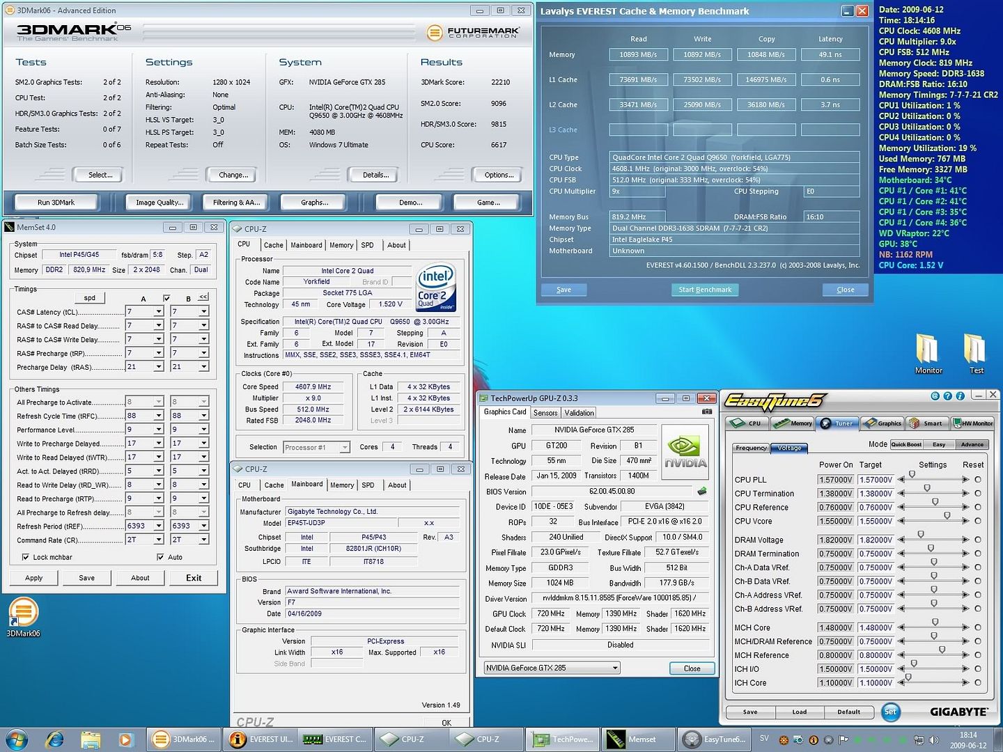

Thank you, much apprecieted, :up: :) really nice to see a DDR2 vs DDR3 P45 comparison with a Q9650 and 2x2Gb ram and both in Windows 7 RC 64bit, if Iīm not misstaken.
So 500 4,5 2x2 DDR3-1600 777 21 tRD9 does almost perform the same as 500 4,5 2x2 DDR2-1250 555 15 tRD8 with Super Pi 32M, itīs pretty close I most say and so is the bandwidth and latency.
Do you care to run some more comparison tests, we stay with the same CPU bus, clock and memory speed as in Super Pi, should be nice to have a test that responds well on ram bandwidth and latency, any suggestions.
My first run was in diagnostic startup mode with Windows 7 RC 64bit (less change to corrupt when run tests) but I did a rerun i normal startup mode to see if it was different but it wasnīt, it was within 1sec.
http://i282.photobucket.com/albums/k...tRD9Turb-2.jpg
Im on 7201 which is probably not going to make a difference vs 7100. This is with the same settings as before just on turbo mode instead of standard. Its only a half second faster so it still doesnt seem like turbo does any good vs standard, bandwidth is also basically the same.
http://i131.photobucket.com/albums/p...apImage11h.jpg

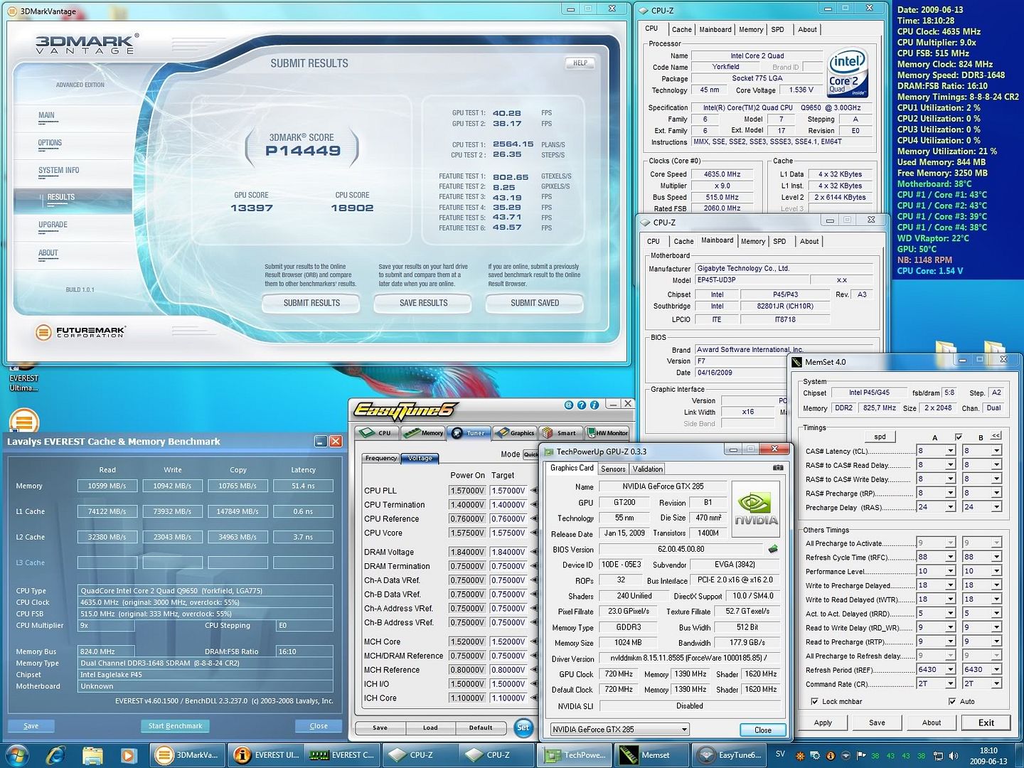

I was having trouble with a UD3P, would get bsod with any OC, ran fine before. Switched out all hardware, tried different case thinking it was a wire grounduing out. Today i get a new UD3P (not an RMA, ordered a new one), put everything together and same thing, boots fine at stock only. tried 2 cpu's 3 sets of ram, different gfx card, 2 different HDD's one with a fresh install, flashed bios. Left the back off of the case to have axcess to all case wires, I tried unplugging fan wires 1 at a time, restart try different wires, and still will not oc. I am stumped. Anyone have any ideas what may be causing this?
Thanks, this is what I used for the spi 32m and prime runs. Its not final yet since im still playing with the ram. :up:
more playing ram at 1275Code:******Motherboard Intelligent Tweaker (M.I.T.)******

Yes! finally I succeeded in running 4500MHz stable. I decided to give it another try, this time with an AC unit blowing in direction of my watercooling rig.
I managed to get my temps down a bit
Before I was runing LinX with 31/ 31/ 37 (stuck) / 29 idle and 81/ 79/ 76/ 76 stressed
But with the AC unit blowing I got 25 / 29 (stuck) / 37 (stuck) /22 idle and 74 / 74 / 71 / 71 stressed
http://www.plaatjesupload.nl/bekijk/...734301-250.jpg
I could even lower vCore a bit, down to 1.425v
http://www.plaatjesupload.nl/bekijk/...735020-050.jpg
So lower ambient temps are key for me running 4500MHz.
After W7 is installed this evening I'll do a Everest run for comparing bandwidth and latency with Ghostleader and Hoss :)
Just some fun run on windows 7 7201 :D
http://img19.imageshack.us/img19/390...pi32x1run4.jpg
Cheers :up:
Sergio

sorry this is my first time i fill a template
cheers :up:Code:******Gigabyte EP45 UD3P******
Robust Graphics Booster.........................[ Turbo ]
CPU Clock Ratio.................................[ 9x ]
Fine CPU Clock Ratio............................[ ]
CPU Frequency 4.60Hz...........................[512x9]
******Clock Chip Control******
CPU Host Clock Control..........................[ enabled ]
CPU Host Frequency (Mhz)........................[ 512 ]
PCI Express Frequency (Mhz).....................[ 102 ]
C.I.A 2 [Disabled]
******Advanced Clock Control******
CPU Clock Drive.................................[ 900mv ]
PCI Express Clock Drive.......................[ 900mv ]
CPU Clock Skew.................................[ 0ps ]
MCH Clock Skew................................[ 50ps ]
******DRAM Performance Control******
Performance Enhance [Turbo]
Extreme Memory Profile (XMP)..................[profile1]
(G) MCH Frequency Latch........................[333mhz ]
System Memory Multipler.........................[2.40B ]
Memory Frequency 1066.........................[1229]
DRAM Timing Selectable..........................[manual]
CAS Latency Time..........................[ 5 ]
tRCD............................................[ 5 ]
tRP..............................................[ 5 ]
tRAS............................................[ 15 ]
******Advanced Timing Control******
tRRD............................................[ 3 ]
tWTR...........................................[ 3 ]
tWR.............................................[ 4 ]
tRFC............................................[ 50 ]
tRTP............................................[ 3 ]
Command Rate (cmd)..............................[ auto ]
******Channel A and B Timing Settings******
Static tRead Value [ 0 ] ................[ 8 ]
tRD Phase0 Adjustment [ 0 ] ................[ auto ]
tRD Phase1 Adjustment [ 0 ] ................[ auto ]
tRD Phase2 Adjustment [ 0 ] ................[ auto ]
tRD Phase3 Adjustment [ 0 ] ................[ auto ]

I finally got My Cpu Stable enough at 4.6Ghz(with 8 Gigs of ram) to run Vnatgae and 3d Mark06 in Win 7 7201
http://i43.tinypic.com/53qlck.jpg
Physics disabled in Vantage
http://i43.tinypic.com/v8j4m1.jpg
Thanks to everyone who helped me get this :up:

Hereīs mine EPT45 Q9650 @ 512 ~4,6GHz with 2x2 ram @ 1638 777 21 tRD 9.
3DMark06 are pretty close, you got better VGA points due to higher core clock but I got higher CPU score probably due to better bandwidth and latency from my ram.
Do you run ram @ 1000 CAS5 and with which tRD?
Screenie of bandwidth and latency maybe?

Hoss31 this is the same run on Win7 7201x64 hughe difference...i just gave a notch of vcore and MCH as i did the other run on XP32 wich needs less volts
when i run 3DM06 Win7 disables color scheme and goes to basic...
this is at 4608/1229 my actual 24/7 with 1,408 vcore
http://img40.imageshack.us/img40/926...293m06run2.jpg
this is at 4635/1236 just a test with 1,42 vcore
http://img40.imageshack.us/img40/502...363m06run1.jpg

With my new OCZ Platinum pc2 9200 1.8v ram i cannot get into windows at 1150 with pl8 L M A O. Been a bad week for me and hardware. Time for a new platform.
My G.Skill 9600 PI 2x2GB 1200Mhz kit just arrived! :up::up::up:
Damn, these babies run hella cool even at 2.1v. http://valid.canardpc.com/show_oc.php?id=585259
Is it possible that the CPU doesn't like a divider and does best at 1:1/200d? I have only run this e8400 using 200d pl9 due to not having a 4gb kit that would go much past 1130. On other boards I have had CPU's that would clock well at 1:1 only and some that seemed to like a divider. I know the chip is good up to 495x9 prime stable 8hrs. Maybe I am wrong about this idk.
Cpuz hw monitor and Everest shows 1.79v when set to 1.82v in bios, maybe needs another bump. Went as high as 1.40v mch but that is to high for 1150.
I also put this ram in my other rig with a q9550 and could not get it to boot into windows at 482x8.5 all the way up to 1.35vcore 1.40v mch, I have run this chip at 500x8.5 1.35v bios 240b prime stable but using a 2x1gb kit of d9's.
Thanks

Looks like Iīm starting to closing in on that wall, it getting harder to get it stable through Vantage in Win 7, hade to rise to CAS 8 @ 1648 with tRD10.
Iīm trying to get above 15k in Vantage without PhysX but itīs a struggle.
This is my latest run.
http://i282.photobucket.com/albums/k...TtRD10Turb.jpg

My chip is a vid 1.25v, maybe something on here can help.
[IMG]http://img193.imageshack.us/img193/5966/p9544014hr.jpg[/IMG]
