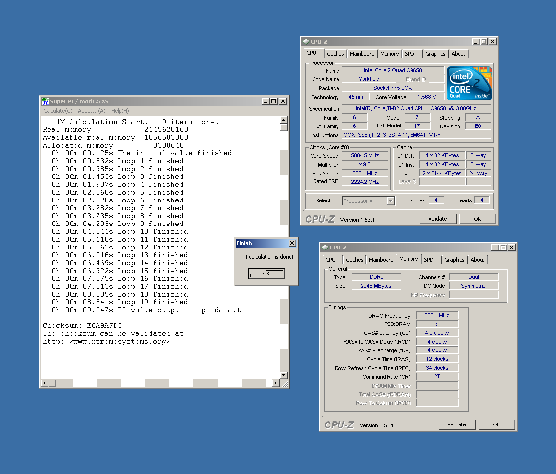

RAM overclocking only ( 4x 1GB Kingston HyperX PC9600 ram kits ).
Booted from bios at 420fsb, bios set 3:5, DDR2-1400, 5-5-5-18-AUTO's, tRD 6,
VTT 1.34, NB 1.44, DIMM 2.36 (memtest with DOS progarm at VTT 1.30, NB 1.36, and DIMM 2.30)
http://img520.imageshack.us/img520/2...2121023ay4.png
ran a 4x SuperPi 8MB to test system memory and overall stability of the system just a little bit before i continue to overclock the ram kit higher.
also using ET6 and Memset programs to up vDimm to 2.44v and increase tRFC value.
http://img516.imageshack.us/img516/9...2120131su0.png
then SetFSB to 445fsb and at DDR1484. and this was about the end of using tRD 6 and this voltage settings.
if i let the tRD value and rest of memory timings loose and use more volts in NB and at the dimms, this ram kits probably can go higher.
http://img520.imageshack.us/img520/6...2122043yb6.png
soory in advance if you feel there is no point in posting this overclock info on here.
and i would just like to add a word of warning anyway, doing this can damage your hardware or installed Windows.
