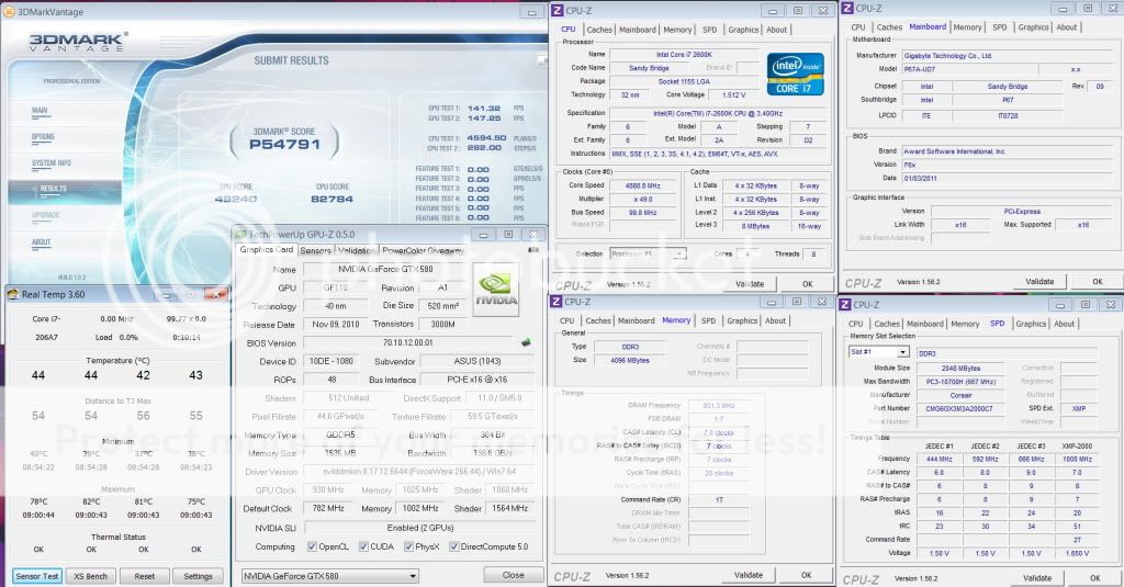

I put the second 460 in to try some 3D. Im pretty happy being able to bench over 5ghz. First test was with a single card, had to lower mem to 1866 to complete the tests at 5.1ghz

Here is my 3DMark 11 result with a single 580 and 2600K @ 5.4Ghz.
http://i24.photobucket.com/albums/c1...hotobucket.jpg

There is a difference running both at 16x, look at the scores.
