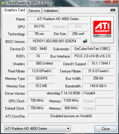

well I just flashed my new gecube 4870 with the techpowerup fix
after doin 790 easy @ ddr5 1100,
changed the gpu to 830 on clock info 3 only (RBE v1.11)
flashed (Ati Winflash 2012)
no display
connect my 8800gts 320
but now cannot get ati winflash2012 to load in vista or xp
RBE v1.11 gives me "YOU HAVE NOT CONNECTED ONE OF YOUR VIDEO CARD POWER CONNECTORS TO THE POWER SUPPLY"

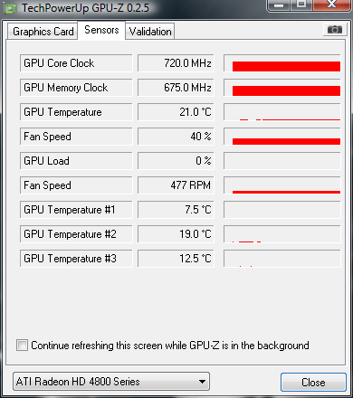

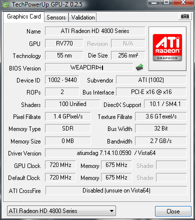

http://gpuz.techpowerup.com/08/07/05/2rp.pnghttp://gpuz.techpowerup.com/08/07/05/a0t.png
help me obi wan

Try making a dos boot disk and use atiflash to flash a stock bios or one you know works. It worked for me to recover a bad flash with winflash.

http://gpuz.techpowerup.com/08/07/06/8qn.png
booted up with a drdos boot cd
ran atiflash -f -newbios -p0 4870.bin from my c: drive
but my default clocks in CCC are 500/900 :confused:
edit: overdrive to 790/1100 running good and cool
