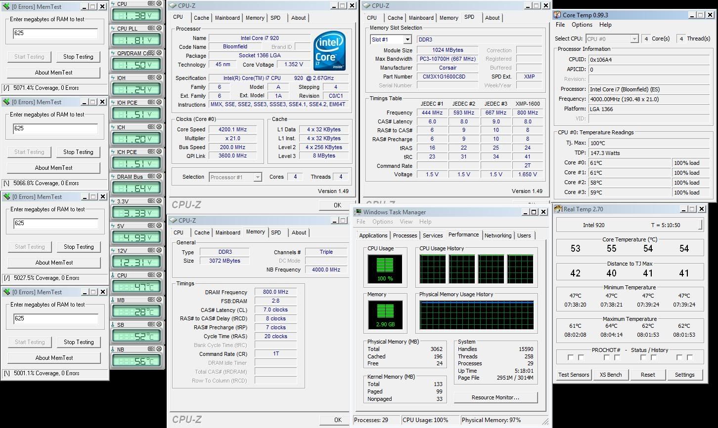

i played today little at air and i got 4.6GHz stable for 3dmark06 and 222bclk
http://www.imagesforme.com/thumb/thumb_75d6f8b3.jpghttp://www.imagesforme.com/thumb/thumb_f50c3ca1.jpg
Hey Domagojx , What temps are you getting with that 4.6 on air my gosh....
I have a Thermalright ultra 120 extreme with 2 fanholders and 2 scythe 1900 RPM push pull setup and im getting the 84 grades at 4.2 + 2k mem on full load ,
Are those temps normal or my thermalright is performing like hell? im using the Tuniq-TX thermalpaste with the little drop on the middle technique.

i just tested , with a multiplier of x16 i can reach a BCLK of 221 max stable with a 108 PCI FREC , 1.40 IOH , and 1.30 ICH . Which is better? 221*19 or 200*21?
idle 30-40° load max 70°
http://www.imagesforme.com/thumb/thumb_0aa21dab.jpghttp://www.imagesforme.com/thumb/thumb_5810370a.jpghttp://www.imagesforme.com/thumb/thumb_707958a5.jpg
i have Ultra 120 extreme to
My God only 70 º at full load with 4.6?
i believe something is wrong with my TRUE then... because it has 2 fans , both are scythes , one is the sflex push , and a scythe slipstream for the exaust. with the fanholders.
as i told you before mine does 84 to 89 º full load. in a 21 grades enviroment temperature and the next settings

First day with new i7 975 X $500.00 .Turbo Disabledhttp://i470.photobucket.com/albums/r.../i7975cpuz.jpg http://i470.photobucket.com/albums/r...zz/i797520.jpg
