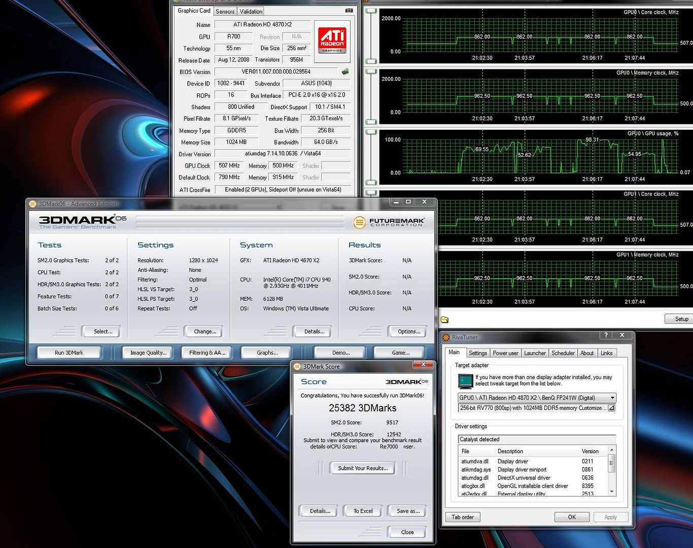

I don't. I want to know why 1.35v is the maximum. A hardmod would take voltages higher, this method should as well.
Its not hitting any limits, OCP causes instant shutdowns. There are two load states. One is as the game is running pulling the most load and the other as it idles at the desktop. If there was any current limit actuating at the higher VID-1.52v, whilst at idle there is still more current headroom. When switched to heavy 'in game' loads at the higher VID-1.52v then it
could reach higher currents and crash, it doesn't. In fact the heavy load current is the same as 1.35v. Indication that 1.35v is the maximum voltage.
Its in the picture as well, the actual voltage never exceeds 1.35v regardless of the VID set.
Another, you see a little variance in load depending on what the game is doing. But loads currents 1.55v=1.35v. Finally default load current @1.26v is a lot lower.
http://img129.imageshack.us/img129/921/43730291lt6.jpg
