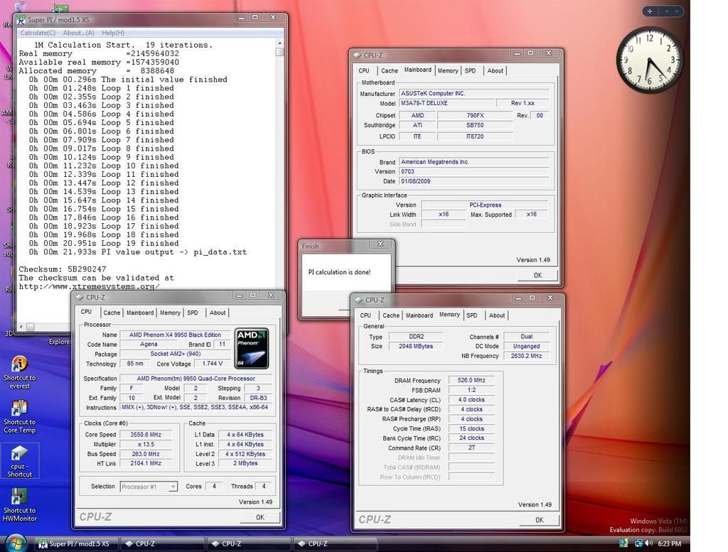

So far so good:
http://img9.imageshack.us/img9/6605/0703cpuzjg4.jpg

0703 installed on first try and all voltages appear to be the same.
0701Beta
http://i168.photobucket.com/albums/u...biosM3A79T.jpg
0703 Official
http://i168.photobucket.com/albums/u...79Tpirun1m.jpg
AOD 0703 ACC +4/ CPU TWEAK/ Idle 35c /Bios reads 34c @ 1.74vcpu/1.66vNb@2630
