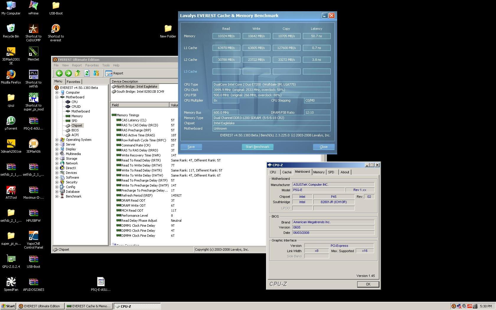

Quick first test: running PL8 at 400fsb 1:1 at stock VID. Doesnt look too bad so far:
http://pix.nofrag.com/2/3/2/3dfa6487...6070681att.jpg
Will test more over the weekend :up:

Talking about the Performance Level (PL) bios option ....
In x38/x48 we can have PL +/- like this :
6 till 350fsb
7 till 450fsb
8 > 450fsb
In the P5Q Deluxe we can have PL +/- like this :
7 till 350fsb
8 till 450fsb
9 > 450fsb
It really sucks.
Is there any solution to this ? Anyone knows if it is a bios problem or a chipset problem ? :(
PS: For me P35 still is the champ in memory bench with Everest.
Now that I bought my own, the problems start to appear :(
Problems with the performance level?
until some bios ago, this problem not appeared
It's not a problem ... it's a feature from the very 1st day ;)

Really guys this PL stuff is a known issue (or whatever you want to call it) and it's more to P45 related as the early Gigabyte boards have the same high PL... think you can compare this board like with the 965 early revs, great FSB but a bit slower than the 975 clock for clock...
Issue or not if you compare eg the P35DS4 with exact same timings and this P5Q Dlx, there really isn't going much and that test is 2 PL difference... also be aware that P45 is so fresh yet performance and stability is already pretty good... more performance will come for sure...
See post 906 and 913 for comperative results... not that bad... In fact I was worried at start too but after doing some comperative stuff it doesn't bother me at all... at the moment I will not be able to beat my old SuperPi times, maybe in the near future...
If you want a good PL you need good ram, as the 1:1 is locked around 9-10, best thing to use a divider and test best PL then...
i think some bios tweaks can be had. it seems to me that 1:1 is completely borked. hopefully they can fix that some how.
otherwise, im content w/ 4ghz pl7 (pl8 w/ all pullins enabled)

I see it maybe more as a hardware limitation, but if you read my previous posts again that there is not much between eg a P35DS4 and this mobo even with higher PL...and those tests were at the same clock speed, ram setings, ...
I'm not declaring here that with newer biosses we will be able to obtain the same PL's as P35 or X48 but the ram speed and co will prolly get a boost for sure... only time will tell...
With my P5K-E (P35) and my Ramage (x48) I get around 10K in the Everest memory bench. With this P5Q Deluxe, with the same cpu speed and same memory speed I get less 900 to 1000 points, because of the PL issue !
This is what's is pissing me off !
