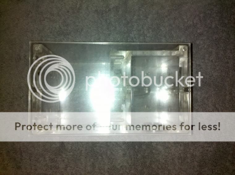

The first being there is no recess from front to back like on the
XSPC Res so that it can slide into most chassis and the only way around that is to snap off the
small 5.25 bay tabs and secondly, the securing hols didn't align to any on the ATCs 840 so new holes needed to be drilled which i'm not sure how some would feel about doing that to a £200+ case.
On further inspection i also noticed that although Vincents fitting would screw into the T3 they leaked due to the fact the the T3 is made purposely to fit their own Ghost Fittings with a
much larger collar than Vincents - again defended by the designer saying "
that recess works to keep the O ring from blowing out when...call it overzealous or inexperienced users over tighten fittings." though id have much rather seen some kind of standard kept in line with other more popular fittings so the choice could be left to the end user rather than having the decision made for us.
One thing that hasn't been picked up on is the back hold down plate which holds the D5 in position i think should be either made from 2 to 3 mm thicker plexi as it hasn't got the strength to apply even pressure on the O ring and i guarantee some will have problems with this as i did on both mine.

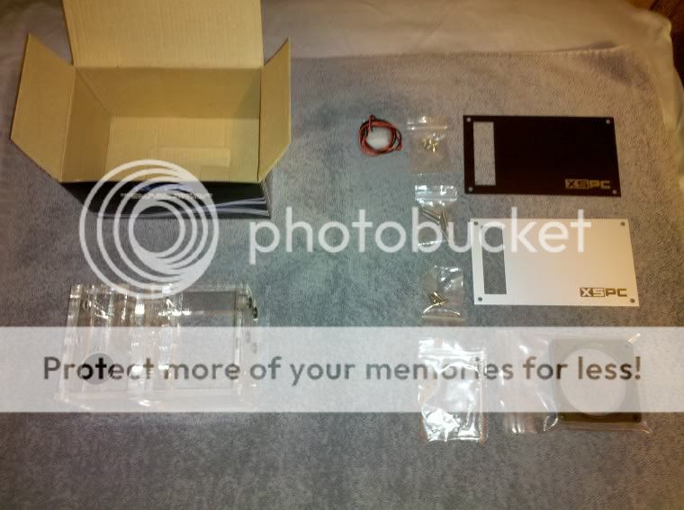

Aesthetically, for me personally i find the actual front of the T3 a little busy looking for my liking though that is only my opinion and would of liked to have seen a much more elegant look as they certainly
didn't look right in the ZOTAC mod at all and the reason why i opted to make new
plexi blanc plates for a much more tidy look in keeping with my particular mod though i do understand new face plates are in the pipeline so although i'm eager to see how they look i still get the impression they won't be to my taste.........but that's just me.
