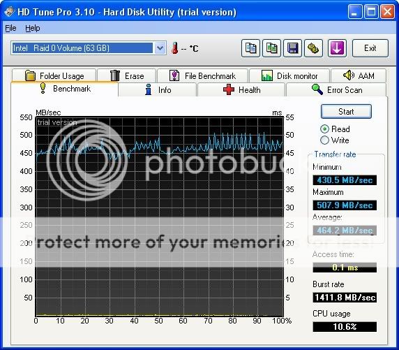

I don't know about this, I have seen higher transfer rates on the ICH family, like for example the half Gb/sec that a pair of X25-E's can achieve:
http://i383.photobucket.com/albums/o...m5-2008/11.jpg
Also, through practice, it has been found that the actual (practical) cap of the ICH10 is ~660Mb/sec, as stated earlier in the thread. For example, three X25-M's that could in theory perform 3*250Mb/sec=750Mb/sec, are capped at:
http://i383.photobucket.com/albums/o...m5-2008/28.jpg
