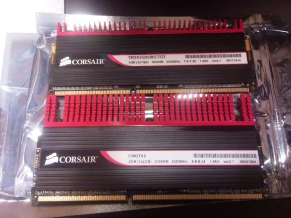

what?:eek:
w00t, CAS7 :droolallovertheplace:
Screens please, preferably 2500MHz :up: :D
i'm looking forward to see results:shocked:
Yes i post that pic in here in case folks didn't know corsair as released GTX2 2250mhz
Lol, haven't noticed the bottom stick is different from top one, where I saw only the 2000C7GT inscription. Thanks for insight :up:
How expensive are we talking about?
EDIT: found, 200$ per 2GB stick. That is expensive :eek:
