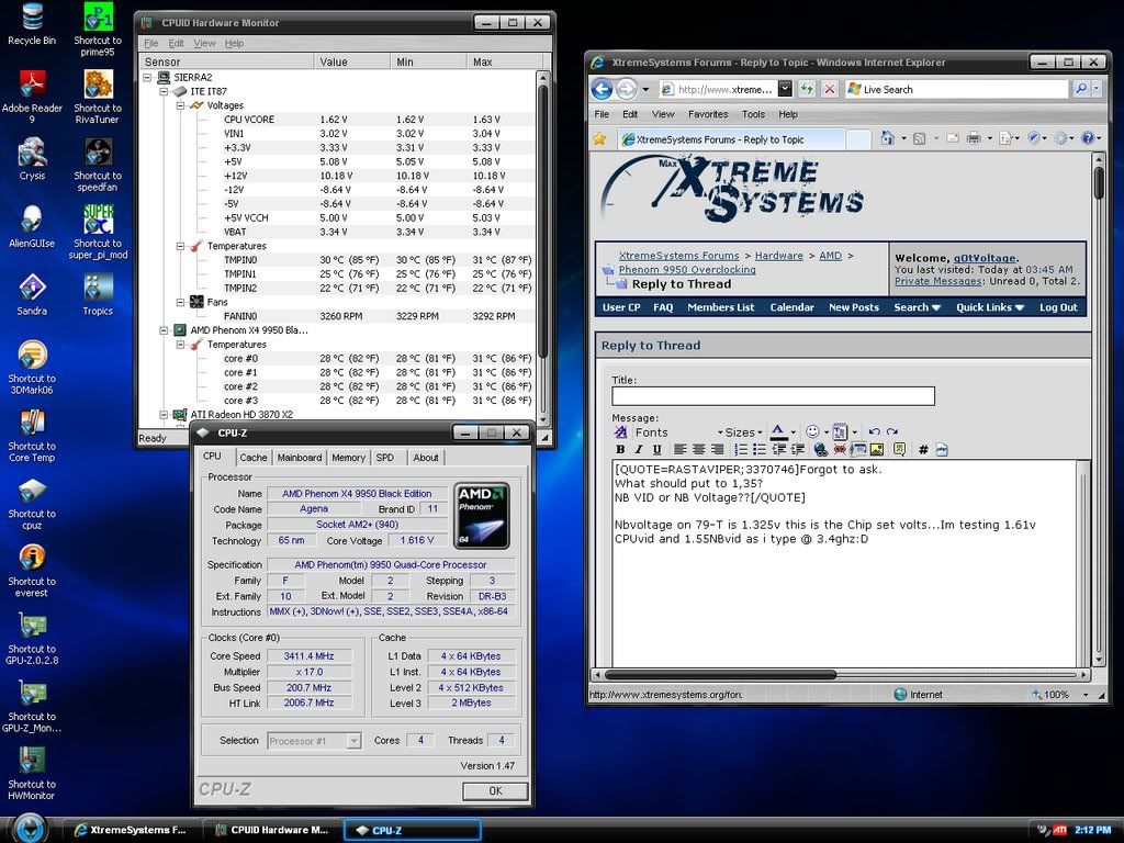

Nbvoltage on 79-T is 1.325v this is the Chip set volts...Im testing 1.61v CPUvid and 1.55NBvid as i type @ 3.4ghz:D
@same voltage i used on the TA770 this 79-T has my chip 2c higher temp wise for CPU.. The Vcore is 100% stable with almost no vdroop for VIDs..The TA770 i had to give 1.64v to get 1.61v.. The 79-T overvolts a little 1.587v = 1.61v
So far ASUS 79-T with 140watt 9950 @ 3.4ghz//2000mhzNB @ 1.61vCPUvid 1.55vNBvid and NO ACC yet.. Im testing the limits before i try ACC...My ram is @ 1067mhz ganged .. Using origanal BIOS..After some more tweaks ill update BIos and see what she really has:D
Havnt tried HTT yet ...I like to see limit with out using first.
http://i168.photobucket.com/albums/u...hz161volts.jpg

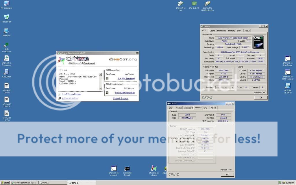

Update: Update: Update:,,
3.5ghz @ 1.6v but the VID dropped down to 1.462v with ACC auto? im so confused right now haaaaha.. But its making progress..Just working on the CPU with out NB for now ...Then ill change the Ram then ill work on NB...My Bios is a little Buggy with 1066 so its taking me time to get used to it. For the Most part to do 3.5 on the TA it took 1.65+ So ACC is working for the Most part on Auto.
http://i168.photobucket.com/albums/u...sus3511mhz.jpg
