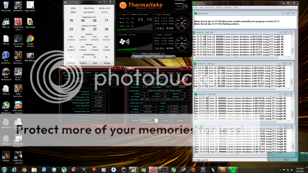

Heres a mild overclock of my 3770k 4.7ghz 1.136v stable on prime 95 6 hours gonna see if i can push it to 5Ghz
batch: 3226c459 anyone else have this batch?
http://i1050.photobucket.com/albums/s414/tpwilko/47.png
very nice chip,surely u can reach 5 ghz...what mobo?
