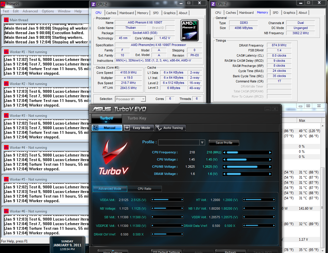

Here's where I am . 3 hours prime 4.06 ghz. Set to 1.385v in bios. With load line went to 1.41v in CPUZ. CPU NB at 2.7 and ram at 1800 CL8
http://farm5.static.flickr.com/4089/...56d6a969_b.jpg
Next up 4.2 Ghz.
Without load line, the board tends to under volt a lot and that kills stability.

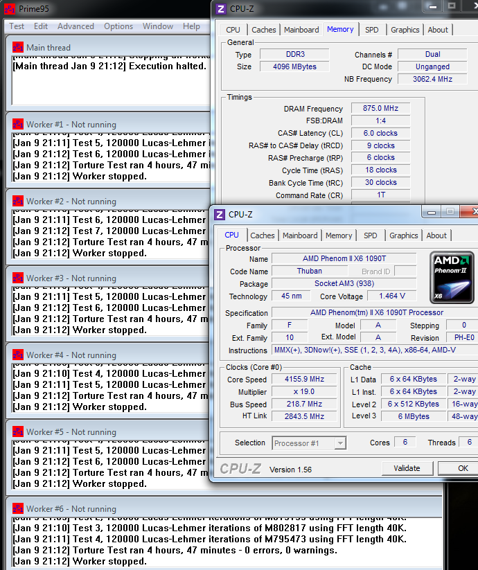

Looking good!:) Noctua NH-D14 cooling, 25c ambients, censor on different room so here might be even warmer cause cpu warms a LOT!
1.475 for CPU from bios.. actual stress-voltage on cpu-z.
http://i10.aijaa.com/b/00133/7131552.png

Finally got this 1090T straightend out. :up:
For some wierd reason it didn't want to play well with my Corsair Hypers reguardless of timings. Swapped it out for a BBSE kit and all is golden!
I can probably tighten mem timings, but after all my hassle with the other kit I wanted to make sure it was out of the equation.
CPU Model: AMD Phenom II X6 1090T BE
CPU Stepping: CCBBE CB 1025 GPWM
CPU Frequency: 4156 MHz
CPU vCore: 1.45V
IMC vCore: 1.265V
CPU Multiplier: 19x
CPU Turbo: Disabled
CPU NB Speed: 3062 MHz
HT Ref Speed: 218 MHz
RAM Speed: DDR3-1750
RAM Timings: 6-9-6-18-1T
RAM Configuration: 4 GB (2 x 2 GB)
RAM vDIMM: 1.6V
Motherboard: ASUS Crosshair IV Formula
Chipset/Socket: AM3, 890FX + SB850
Cooling: Custom Water
Temps: 26C Idle / 49C Load
Operating System: Windows 7
32/64-Bit: 64
Stable/Suicide/Untested: Stable
http://i30.photobucket.com/albums/c3...12hr_Prime.png
Particle: I tightened up Ram timings and let it run this afternoon while I was out (over 4hrs)....
It's your call how you want to list it, but these are much better. :up:
http://i30.photobucket.com/albums/c3...TighterMem.png
