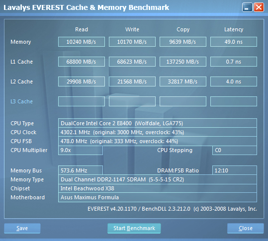

http://shrani.si/f/23/Tv/29jfEExW/4350.jpg
