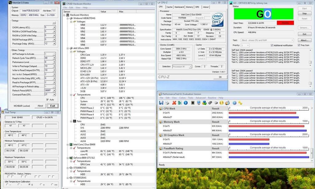

compared to my previous post and after doing the WinXP Tweaks...
am I finally doing this right::confused:
http://img507.imageshack.us/img507/9369/3408pi0.th.jpg
I dunno...this is kinda scary now...any advice or hints what I should do...first time I OC a cpu
http://img530.imageshack.us/img530/2086/3408pb3.th.jpg

Ras# to Cas# Write Delay (tRTC) 5 6
Ras# Precharge (tRP) 5 6
Precharge Delay (tRas) 14 15
All Precharge to Activate 6 7
Refresh Cycle Time (tRFC) 50 (0nly one raised) 46
Performance Level / Read Delay (tRD) 8 9
Write to Precharge Delay 14 15
Write to Read Delay (tWTR) 11 12
Activate to Activate delay (tRRD) 3 3
Read to Write delay (tRD_WR) 8 8
Read to Precharge delay (tRTP) 3 3
All Precharge to Refresh delay 6 7
Refresh Period (tREF) 2600T 2600T
Command Rate (CR) 2T 2T
I think I'm going to settle with 498x8 as that seems to be providing me with the best performance/stability island - details in the pic:

I thought I set the Core Voltage at 1.3 in the BIOS but, it seems to be read by CPUZ @ 1.28, don't know if that's the same one we're discussing.
Remember, I never OC any PC before so this Abit IP35 is taking my virginity away:rofl:

I lowered the Core Voltage to 1.25 I believe...see if you can make a recommendation:
http://img254.imageshack.us/img254/9887/3408vc5.th.jpg
advance thanks
with the E8400, it is about the same as my QX9650...to get a 1000 mhz over stock, i've seen about 1.28-1.30v actual vcore...remember, this is not locked into concrete since every cpu is different when it comes to overclocking...
this below overclock (your image) is using to much vcore, in my opinion...try lower vcore for 3.4 mhz
http://img530.imageshack.us/my.php?image=3408pb3.jpg
yeah I think that's when I was using the uGuru to "play with"...but now I'm doing everything in the BIOS....I'll go back to 1.30v again, let it run for 8hrs and see anything would pop up.
Then I'll probably bring up the Bus Speed...just don't know what's the next number I need to enter...what's next to 334.0 MHz?
Is there a website that tells the next scale number?
That part I didn't find a link to how to scale....
I'm just trying out one parameter at a time.:)
Advance thanks...
