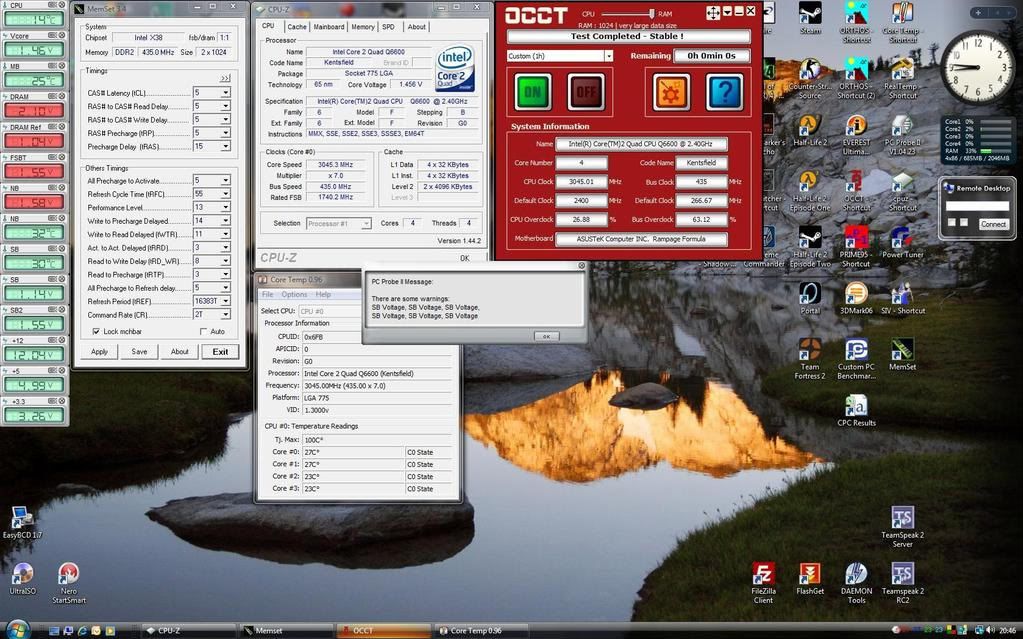

Just flashed from 219, not had any chance to see if there are any improvements here to help hit a stable FSB of over 435MHz, regardless of the multiplier.
Just completed a 1hr OCCT run with the slider over to very large without issues, as soon as I increased the FSB to 440MHz it did the usual of locking up approx 2mins into an OCCT run. My 219 BOIS settings are below, any advice would be appreciated.
Would like to see 450 x 8 for 3.6GHz but just cant get my FSB up there.
I run24/7 at 400MHz x 9 @1066MHz (PL6)
Anybody get the false reading in PC Probe where SB1 Volts jump to 1.58+ & the FSBT reads 0V occasionally?
(Note: the settings below are stable with 8x multiplier, I dropped 1 down to rule out my CPU. I've tried upping the NB to 1.65 & still no joy. Temps arent an issue, I've never seen any core hit 50deg nor my NB go over 36deg)

*Apologies for the screenie, not yet learned how to create a thumbnail :shrug: *
http://i248.photobucket.com/albums/g...z7x219BIOS.jpg
