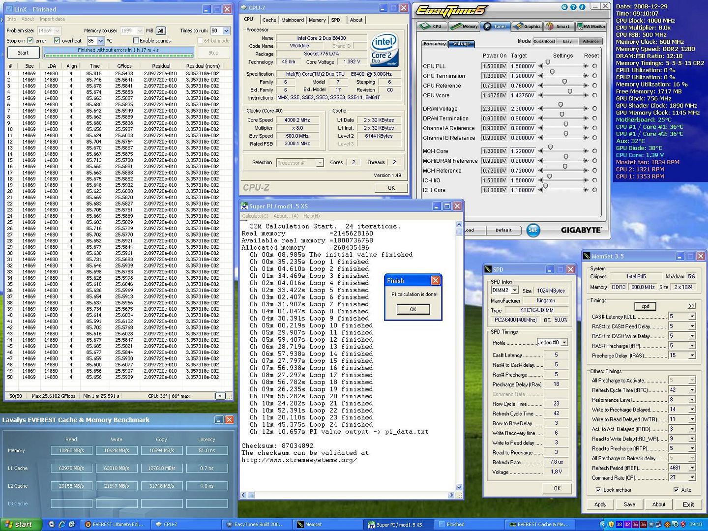

All my RAM sets are okey according to Memtest86+ and since I can run FSB 450 RAM 1200 CAS5 and FSB 500 RAM 1333 CAS5 without error in LinX, Prime95 blend and HCI design Memtest, I reckon thereīs nothing wrong with my RAM, it most be something else.
I remembered when setup FSB 500 RAM 1333 CAS5 I first tried with MCH core 1,40v but no boot, then I tried 1,30v and it boot okey in to Windows.
Well I tried the same with 500 1200 CAS5, start at 1,30, no boot, tried 1,28, no boot and 1,26 and it booted in to Windows.
With P35 and X48 it usually was to low volt if it didnīt boot okey but with this P45 it seems to the other way around, very interresting board this EP45-UD3P.
So with CPU Term 1,28, MCH core 1,22 and MCH ref 63,5% I was running 500 1200 555 15 tRD8 Turbo Stable.
http://i282.photobucket.com/albums/k...20055515tR.jpg
PHP Code:
GIGABYTE GA-EP45-UD3P BIOS F4 E8400 C0 2x1 Kingston HyperX PC9600 Micron D9GKX
MB Intelligent Tweaker(M.I.T.)
Robust Graphics Booster ..................: Auto
CPU Clock Ratio ..........................: 8
Fine CPU Clock Ratio......................: 0
CPU Frequency ............................: 4.00GHz (500x9)
Clock Chip Control
Standard Clock Control
CPU Host Clock Control....................: Enabled
CPU Host Frequency (Mhz) .................: 500
PCI Express Frequency (Mhz) ..............: 100
C.I.A. 2..................................: Disabled
Advanced Clock Control
CPU Clock Drive...........................: 700mv
PCI Express Clock Drive...................: 700mv
CPU Clock Skew (ps).......................: 0ps
MCH Clock Skew (ps).......................: 0ps
DRAM Performance Control
Performance Enhance......................: Turbo Have test Standard
MCH Frequency Latch......................: 333MHz
System Memory Multiplier ................: 2.40B
Memory Frequency (Mhz) ..................: 1200
DRAM Timing Selectable ..................: Manual
Standard Timing Control
CAS Latency Time.........................: 5
tRCD ....................................: 5
tRP......................................: 5
tRAS.....................................: 15
Advanced Timing Control [Press Enter]
tRRD.....................................: 3 [Auto]
tWTR.....................................: 3 [Auto]
tWR......................................: 6 [Auto]
tRFC.....................................: 42 [Auto]
tRTP.....................................: 3 [Auto]
Command Rate (CMD) ......................: 0 [Auto]
Channel A
Channel A Timings Settings
Static tRead Value......................: 8
Channel B
Channel B Timings Settings
Motherboard Voltage Control
Load-Line Calibration.....................: Disabled
CPU Vcore...............1.22500V..........: 1.43750
CPU Termination.........1.200V............: 1.280
CPU PLL.................1.500V............: 1.500
CPU Reference...........0.760V............: 0,810 (63,5%)
MCH/ICH
MCH Core................1.100V............: 1.220
MCH Reference...........0.760V............: 0,72
MCH/DRAM Reference......0.900V............: Auto
ICH I/O.................1.500V............: 1,500
ICH Core................1.100V............: 1,100
DRAM
DRAM Voltage............1.800V............: 2,300
DRAM Termination........0.900V............: Auto
Channel A Address Vref..0.900V............: Auto
Channel B Address Vref..0.900V............: Auto
Advanced Settings
Limit CPUID Max. to 3.....................: Disabled
No-Execute Memory Protect.................: Enabled
CPU Enhanced Halt (C1E)...................: Disabled
C2/C2E State Support......................: Disabled
x C4/C4E State Support....................: Disabled
CPU Thermal Monitor 2(TM2) ...............: Enabled
CPU EIST Function.........................: Disabled
Virtualization Technology.................: Disabled

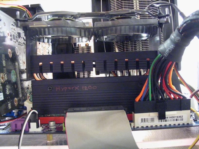

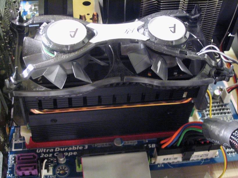

@Ghostleader
Nice result man..want to ask.,do u use active cooler for 2.3v ram?and what cooler do u use..tq
Thank you
Yes, Iīm using active cooling, Arctic cooling RAM Cooler.
I have also change the original heatspreader to Nexus heatspreader.
At 2,30v@1200MHz with original Kingston HyperX heatspreader I was above 60C without fan and with Nexus not above 45C without fan.
So with 2,30v@1200MHz, Nexus heatspreader and Arctic cooling RAM Cooler, around 35C.
This is with a temp probe between the heatspreder and the PCB, this was take with my Rampage Formula Rig.
Iīm running EP45-UD3P in a open bench.
