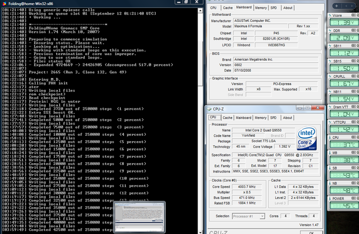

480fsb is very doable on this board, It took me 20 mins maybe to dial in my 4.2GHz settings, all my chips will do 500FSB on this board.
I would recheck your settings
This is my 4200MHz setup
http://i237.photobucket.com/albums/f...200_10loop.jpg
