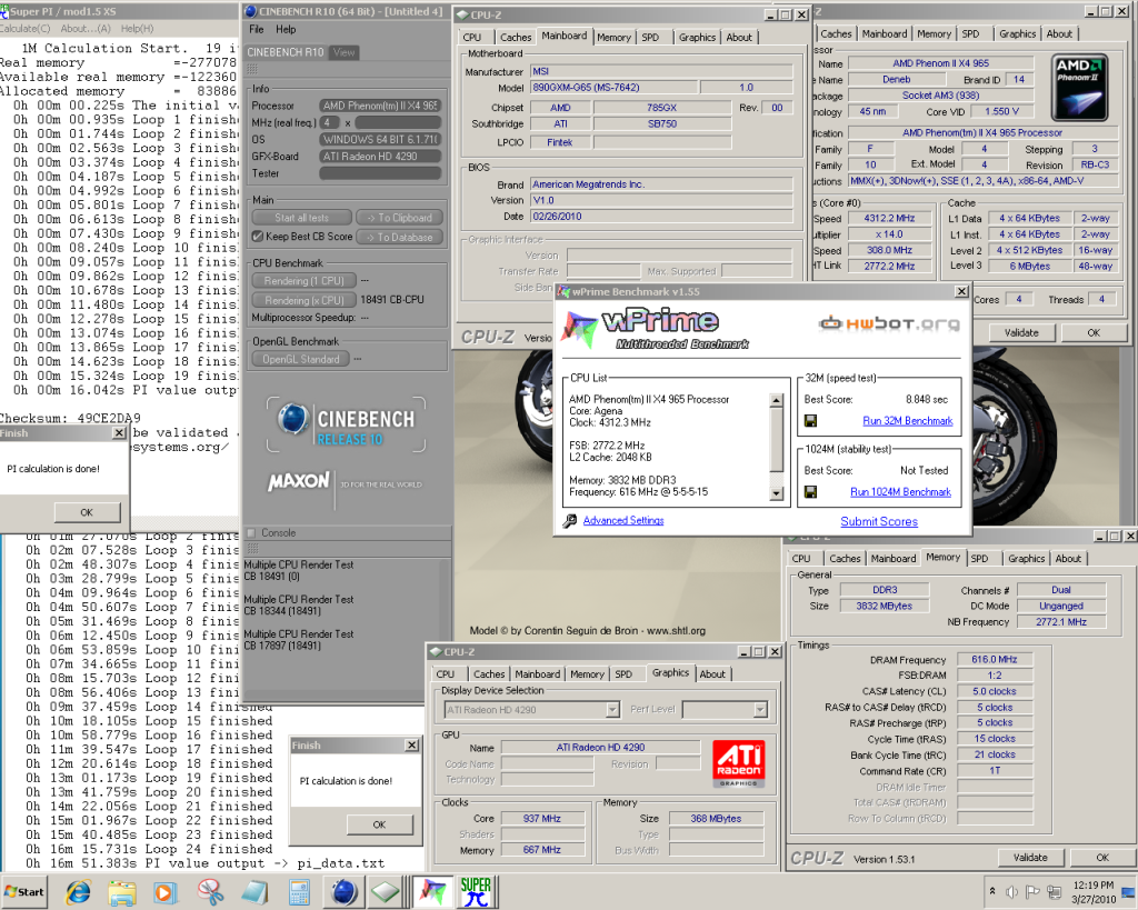

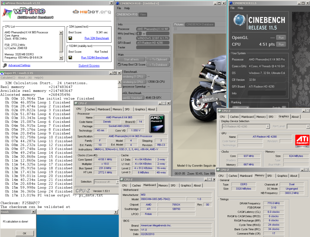

I tested the HT a little more today. I had to drop the memory divider to 1:2 and then the HT cranked on up a bit more.
At 4312MHz 14x308 the system ran wPrime 32m, SPI- 32M and Cinebench 10 repeatedly but it wouldn’t run any 3D tests as the GFX driver would stop working. I lowered the IGP memory speed from 667 to 533 and then the system would run the 3D tests at the above bios settings of 14x308. The 3D scores suffered though I assume from the lower IGP memory speed.
http://i262.photobucket.com/albums/i...SPI-32-and.png

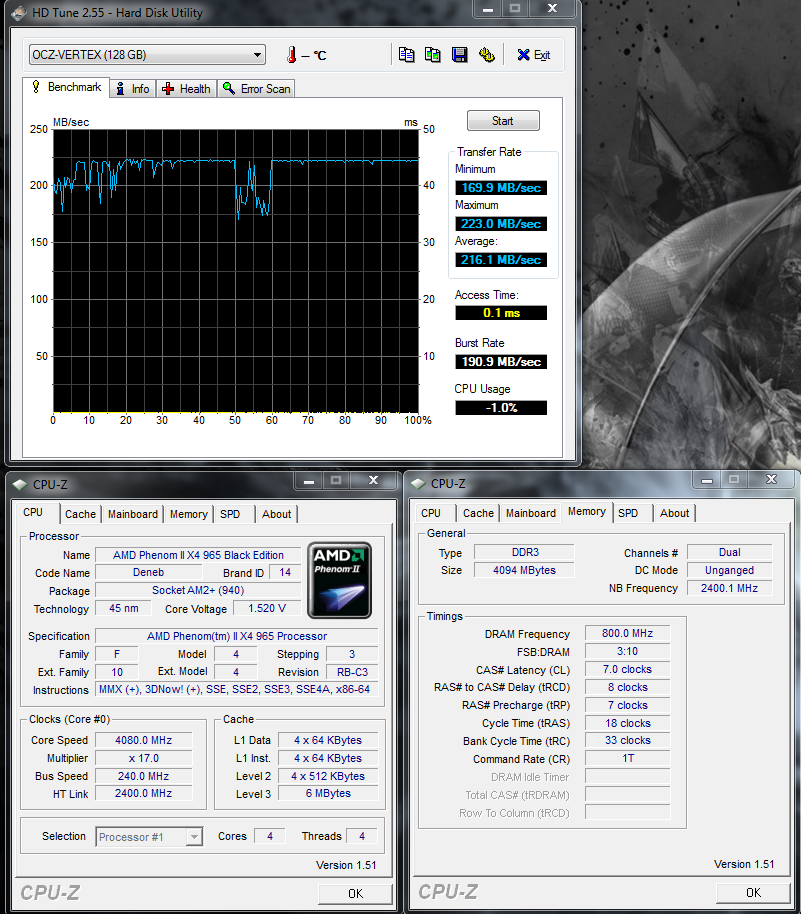

These test are not scientific, just a single HDTune run with different HTRef clocks.
I tried to keep CPU, RAM and IMC as close as possible.
This wasn't a tweaked run or anything, all services and sidebar running (real world kinda thing)...
Actually, I'm kind of surprised there wasn't a difference, nothing that couldn't be attributed to normal variances anyway...

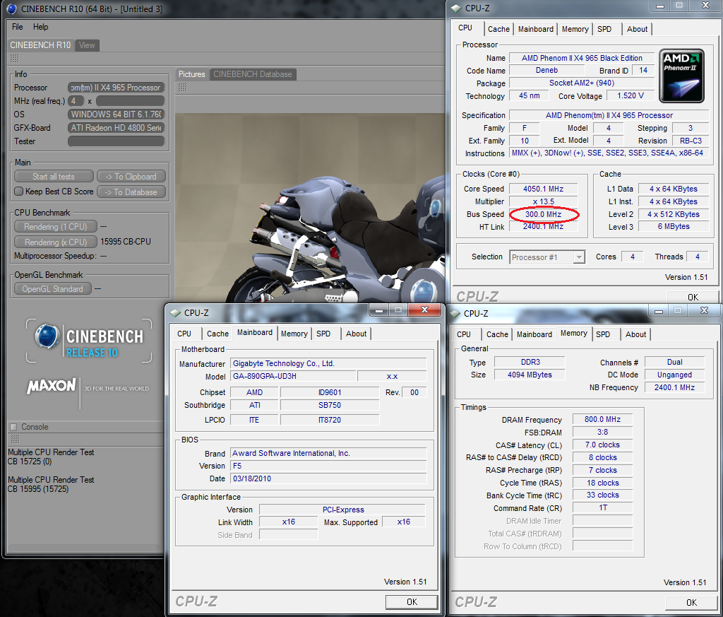

HDTune @ 240 HTRef:
http://i30.photobucket.com/albums/c3...burt/HT240.png
HDTune @ 300 HTRef:
http://i30.photobucket.com/albums/c3...burt/HT300.png
Interesting SSD tests. It looks like your MB handles HT alright Dave. How well does your MB take changes in the bios? This MSI doesn’t like too many changes at one time because if I change say HT and NB bios settings it may not reboot. Where as if I just change the HT bios setting then reboot then reenter the bios and change the NB speed it reboots the next time just fine. :shrug:

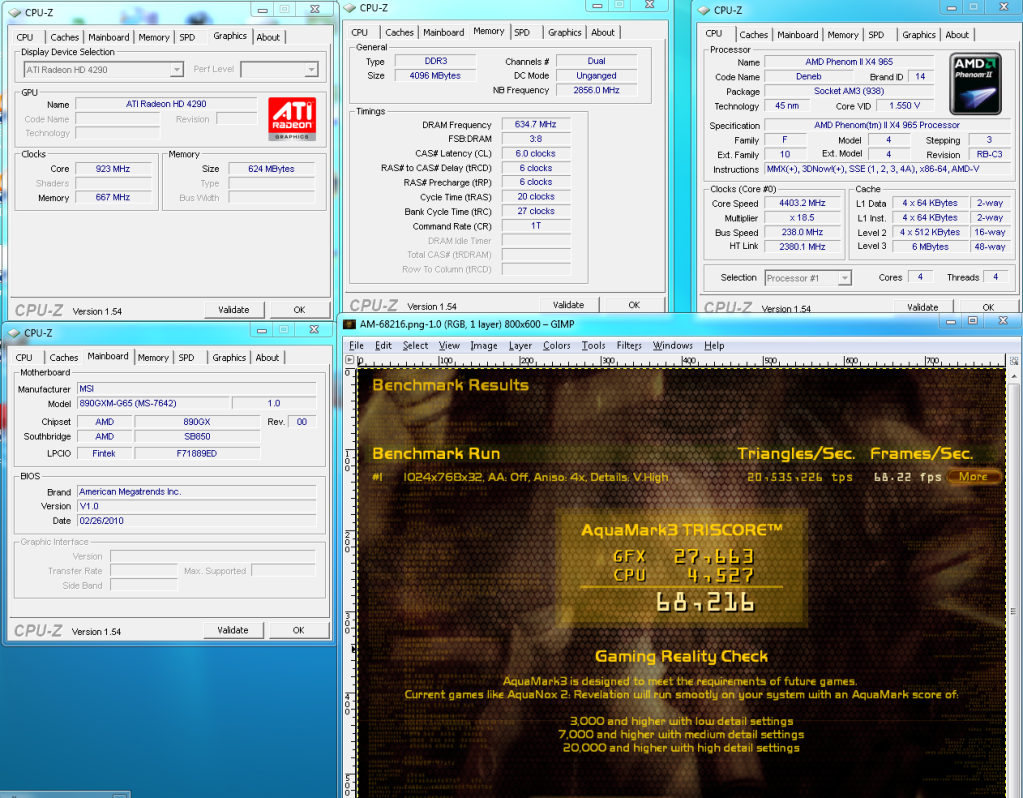

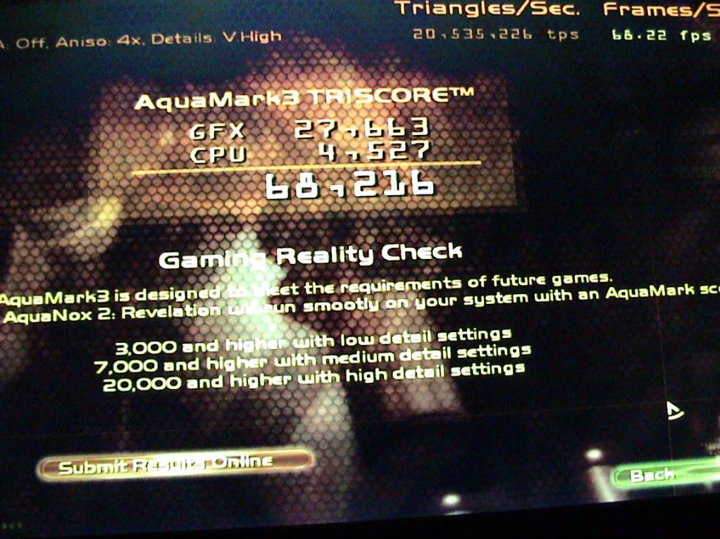

Ok I ran AquaMark3 today and it test fine but I can’t get a screen capture in order to add all the CPUz system info to a full screen shot. AquaMark runs in full screen and when I do a printscreen the paste into paint all I get is a black image. I’ve also tried Alt+printscreen and control+printscreen with the same results in paint a black image.
Do I need to buy the full bench test in order to capture a screen shot?:shrug:
I finally just used a camera to take a picture of the screen which is posted below.
http://i262.photobucket.com/albums/i...M/DSC01078.jpg

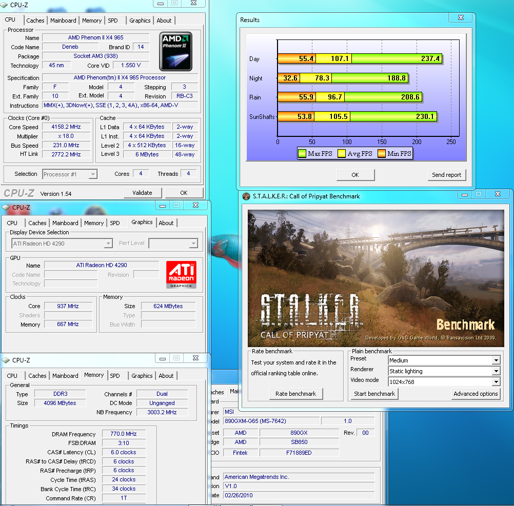

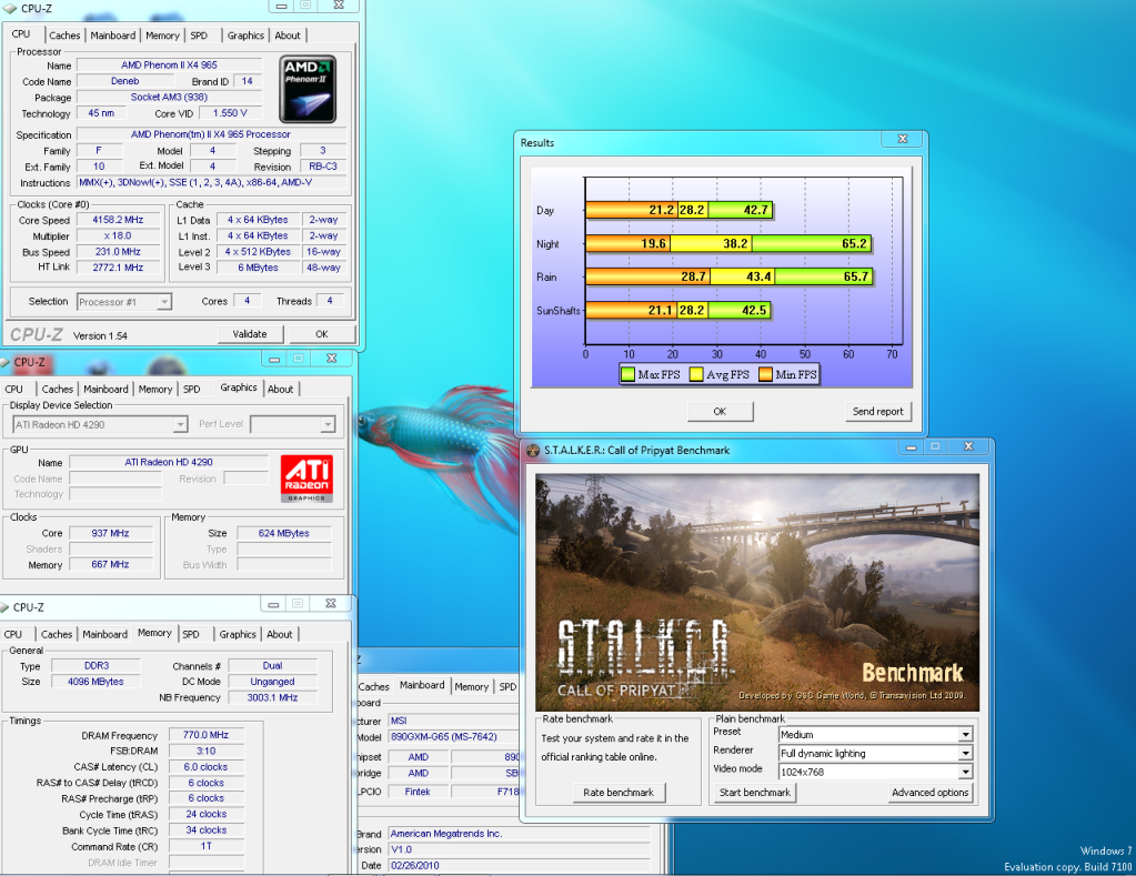

I ran some Stalker bench tests also plus I posted my best CrystalMark score so far on this MB. All these tests were on Windows 7 RC.
Stalker Static lighting
http://i262.photobucket.com/albums/i...GXM/ST-CoP.png
Stalker Full dynamic lighting
http://i262.photobucket.com/albums/i...T-CoPf-d-l.png

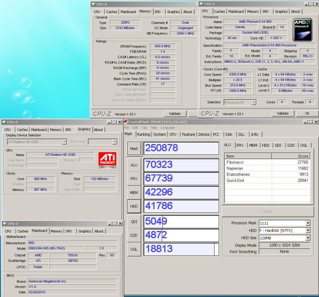

CrystalMark
http://i262.photobucket.com/albums/i...878score-1.png

Thanks for the suggestion chew but I searched for a direct3d.dll without success. This being windows 7 rc may be part of the problem. I've been having trouble with both the 32 and 64-bit versions this time around and I'm not sure why. The 32 snd 64-bit versions refuses to run UT3 even patched plus AquaMark3 won't start on the 64-bit version. I've enjoyed testing Windows7 RC but I guess it's time to move on. I'm installing Vista 32-bit on the MSI right now.
I did find a fix for the AquaMark3 problem though.
AquaMark3 creates a folder in the pictures library and saves the pictures as files with.tga file extension in that folder. Gimp will open these files as seen in the posted screen shot of the AquaMark3 test below.
http://i262.photobucket.com/albums/i...821632-bit.png
