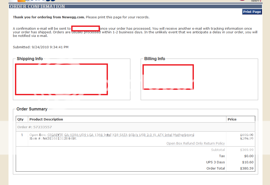

I managed to snag a UD9 on Newegg OB for $370 a few minutes ago. Will definitely compare these two!
http://i747.photobucket.com/albums/x...xx/shhhiii.png

Well guys, the UD9 arrived today. I'll be testing it more tonight and tomorrow in comparison to my RIIIE.
It was open box and I can clearly see why (they provided me with two stickers on the bottom pointing to the problem areas). There are some damaged (exposed) traces. None of them seem to be fully broken, bu I'll definitely be checking all of the voltages with a DMM.
Anyway, here's a quick picture I snapped with my iPhone:
http://i747.photobucket.com/albums/x...x/ed13af97.jpg
