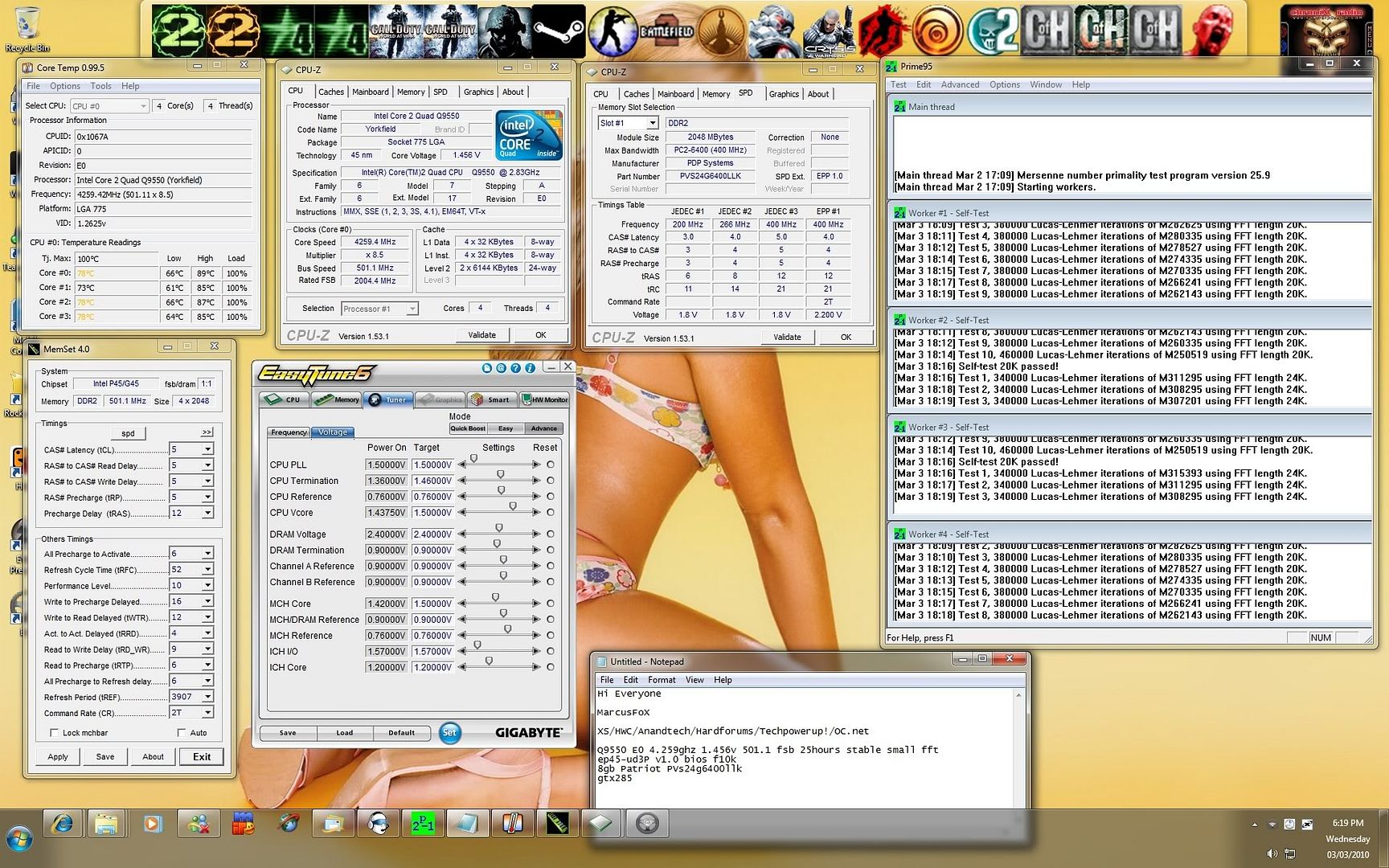

Somthing I finished up at the begining of the month but have been busy with bfbc2 and havent posted.

So far, me likey the Q9550 http://valid.canardpc.com/show_oc.php?id=1083318
are there any templates for a q9650 and a ep45t-ud3lr board for 4.0 and over o/c?
Thanks guys for the templates :)
Hey.....the supply UD3P seems to drying up..my usual haunts don't have any (or UD3R's) that matter. Anyone knows why?? for such a great board!
Hello, I apologize for my English, but use google traslator ...
Gentilemtne tell me that I should set voltages to be rock solid at 4.3 ghz ...
this is my current configuration with 450 x 9, I get to 478 x 9!
how do I set up everything?
******Motherboard Intelligent Tweaker (M.I.T.)******
Robust Graphics Booster.........................[ Turbo ]
CPU Clock Ratio.................................[ 9 ]
Fine CPU Clock Ratio............................[ + 0.0 ]
CPU Frequency 4.5GHz............................[ 450 x 9.0] 478 x 9 ???
