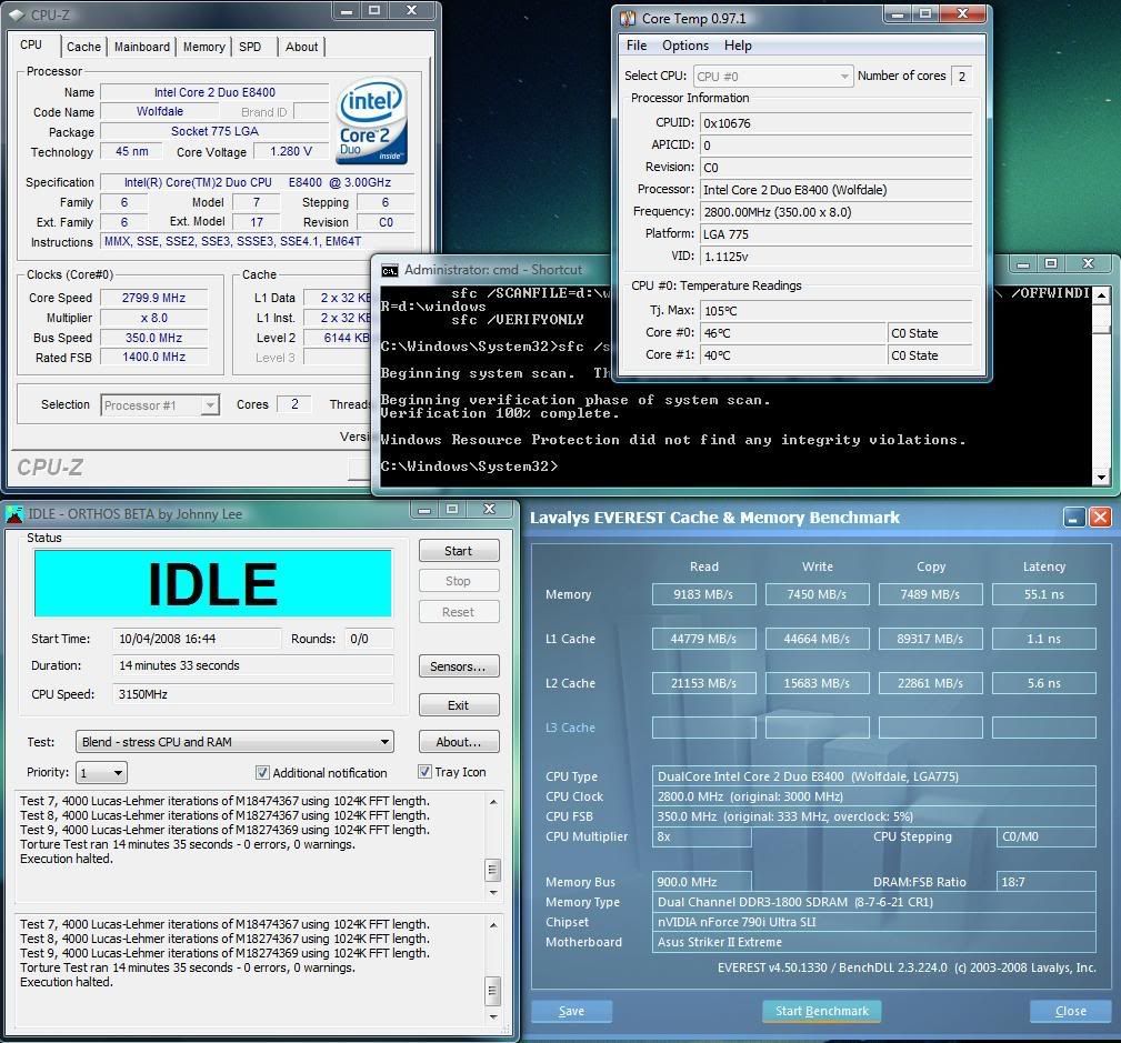

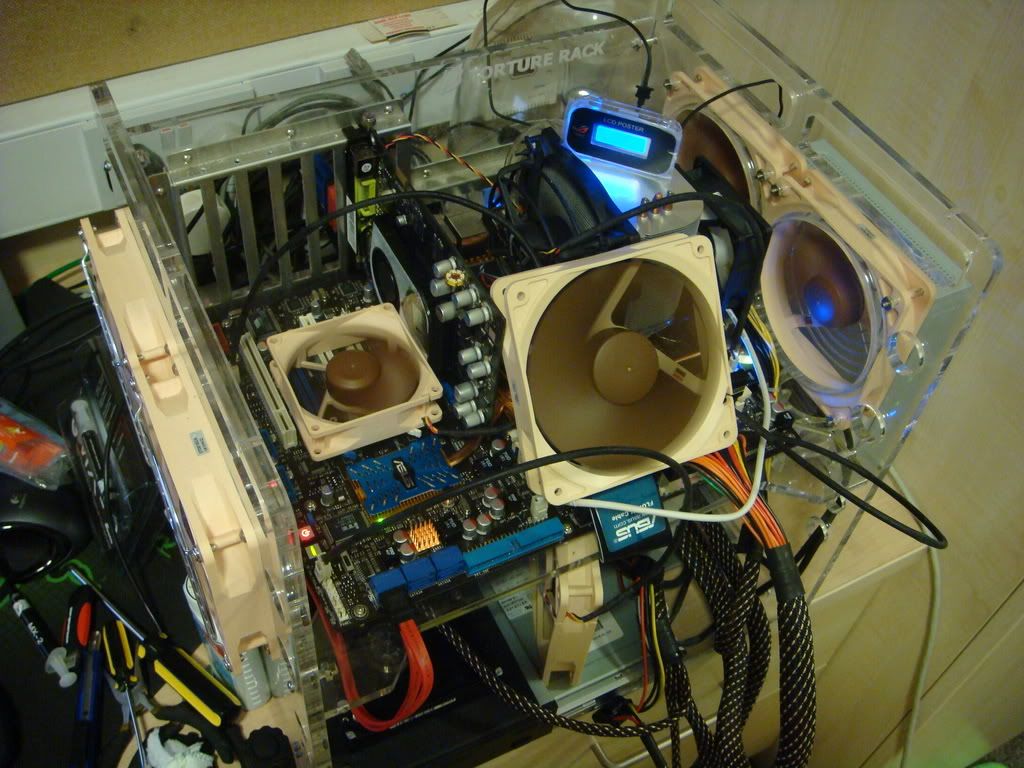

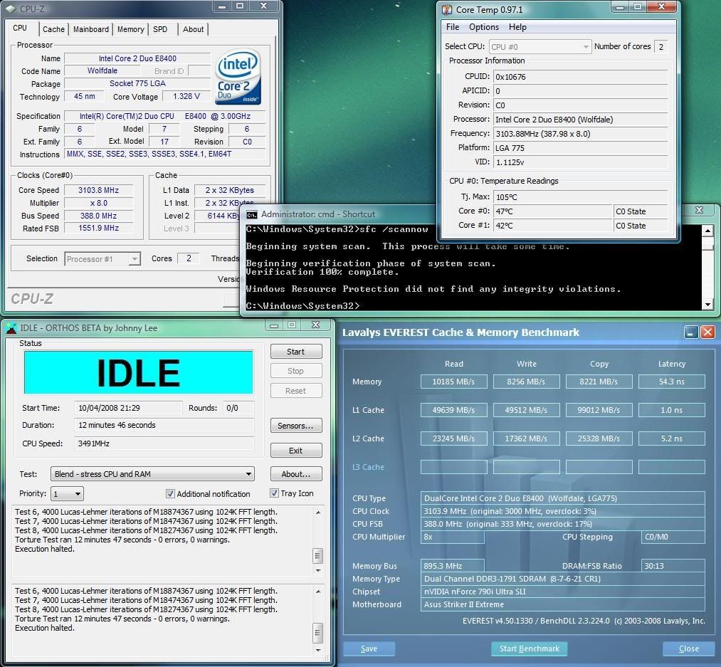

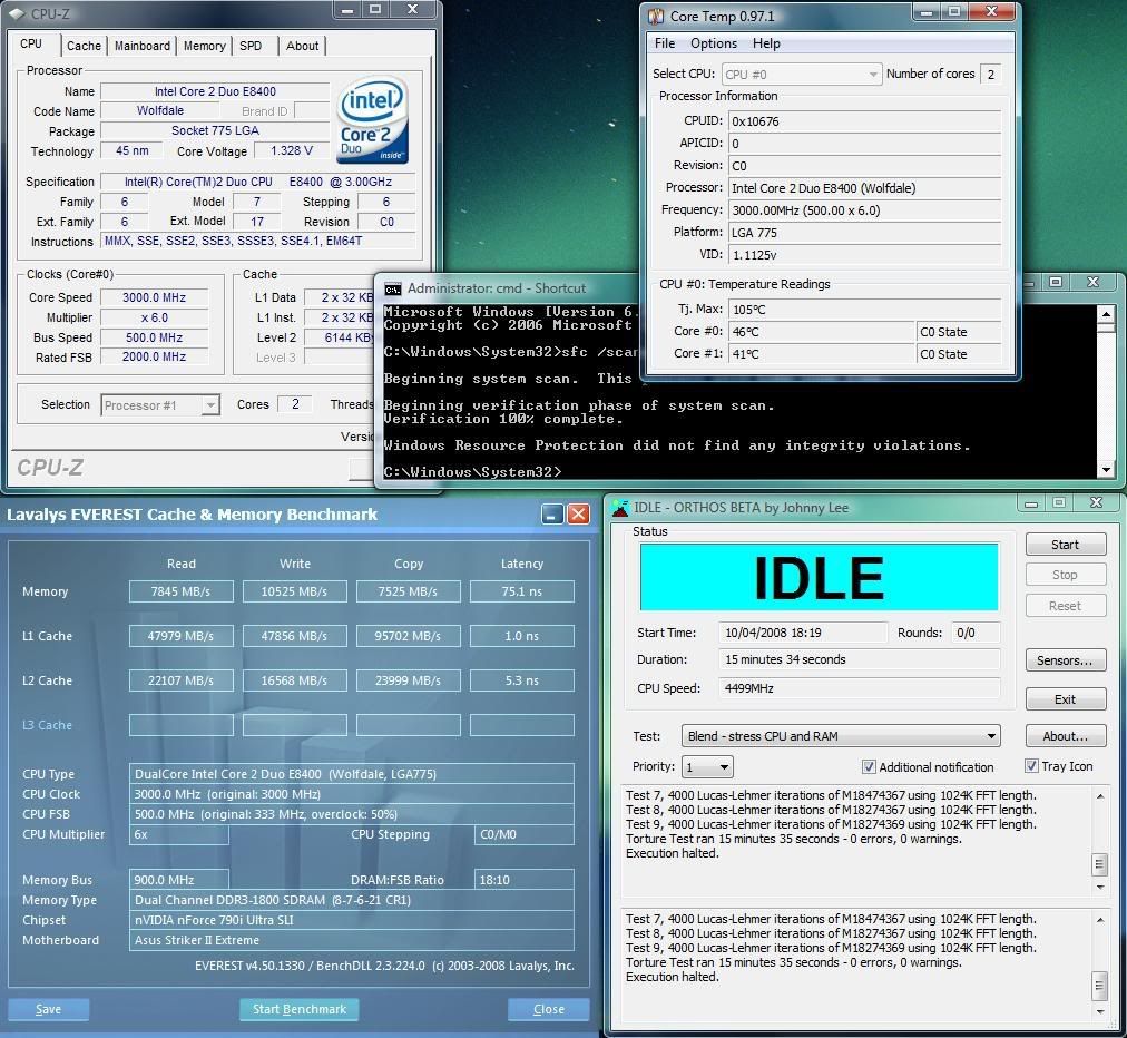

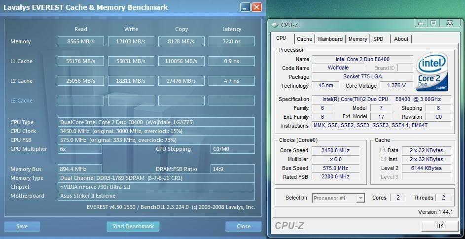

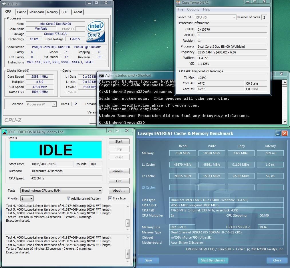

Pulled my S2E out again to play around with my E8400, and have had a better time, although there are some serious FSB holes...
ASUS Striker II Extreme
CellShock DDR3-1800
nVidia 8600GT
WD RaptorX 150GB
ALL AIR COOLED
CPU - Arctic Cooling Freezer Pro 7
S2E - Stock cooling
ALL TEST: Unlinked, Memory speed locked at 1800 8-7-6-21 1.9V
ALL VOLTAGES: AUTO except CPU/RAM and stated otherwise

Here is a little more detailed analyses of the FSB hole on the Striker II Extreme with Intel Core 2 Duo E8400
All of the following will be ran at these configuration and settings;
ASUS Striker II Extreme nForce 790i Ultra
CellShock DDR3-1800
XFX 8600GT XXX Edition
WD RaptorX 10K RPM 150GB
Enermax PRO 82+ 625W
DD Torture Rack
Cooling;
CPU: Arctic Cooling Freezer Pro 7
Motherboard: original heatpipe cooler, reseated with MX-2
BIOS Settings;
CPU multiplier adjusted to maintain as close to 3Ghz as possible.
Memory set UNLINKED at 1800 8-7-6-21 1t P1&P2: AUTO
Voltage: CPU set at 1.35V in BIOS, 1.312 CPU-Z
Memory set at 1.9V
All other settings left on AUTO unless stated otherwise.
http://i225.photobucket.com/albums/d...6/DSC00720.jpg
Upon loading Windows Vista 64, a memory benchmark is performed.
A short run of ORTHOS BLEND of around 10 minute is performed to establish preliminary stability.
A system files integrity check is performed after the ORTHOS run to check for file corruption.
FSB are checked in 25Mhz increments. Where one FSB works and the next setting does not, further FSB speeds are ran with settings in between to establish the starting point of the FSB hole.
FSB350 - boot - window loaded - stable
http://i225.photobucket.com/albums/d...asy_86/350.jpg
FSB375 - boot - window loaded - stable
http://i225.photobucket.com/albums/d...asy_86/375.jpg
FSB388 - boot - window loaded - stable
http://i225.photobucket.com/albums/d...asy_86/388.jpg

FSB476 - Boot - window loaded - stable
http://i225.photobucket.com/albums/d...asy_86/476.jpg
FSB500 - boot - window loaded - stable
http://i225.photobucket.com/albums/d...asy_86/500.jpg

FSB575 - boot - window loaded - manual voltage increase needed and didnt get it stable enough for ORTHOS run
http://i225.photobucket.com/albums/d...asy_86/575.jpg

Wow, I cant believe that less than 400mhz FSB (388Mhz) still beats 500,525 and 550Mhz FSB in memory read/writing and latencies with L1 and L2 cache. One thing I hate from NVIDIA chipsets.
Is 400Mhz FSB a hole with Yorkfields? Because I might want to keep mines at 400Mhz FSB since it will still be decently OC @ 3.2Ghz with good latency reading/writing speeds.
