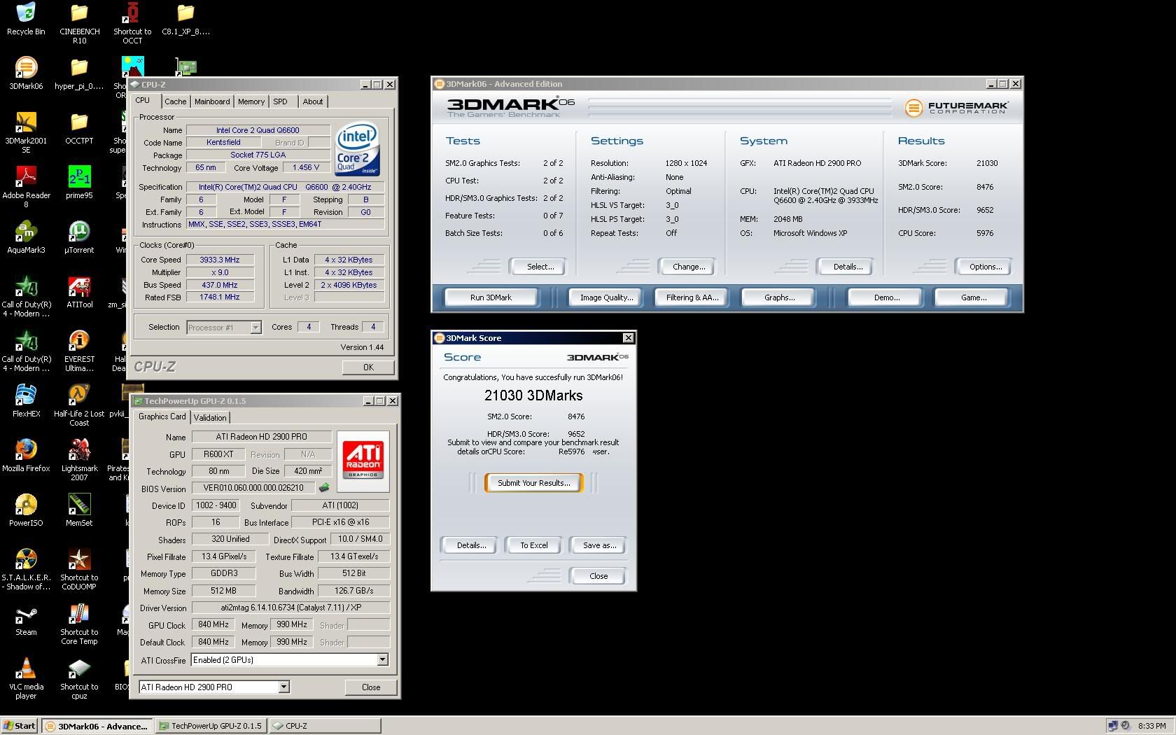

on a side note... i just entered the 21k 3dmark06 club :up:
http://i48.photobucket.com/albums/f2...n22976/21k.jpg
boyakka!
http://service.futuremark.com/compare?3dm06=5303203
