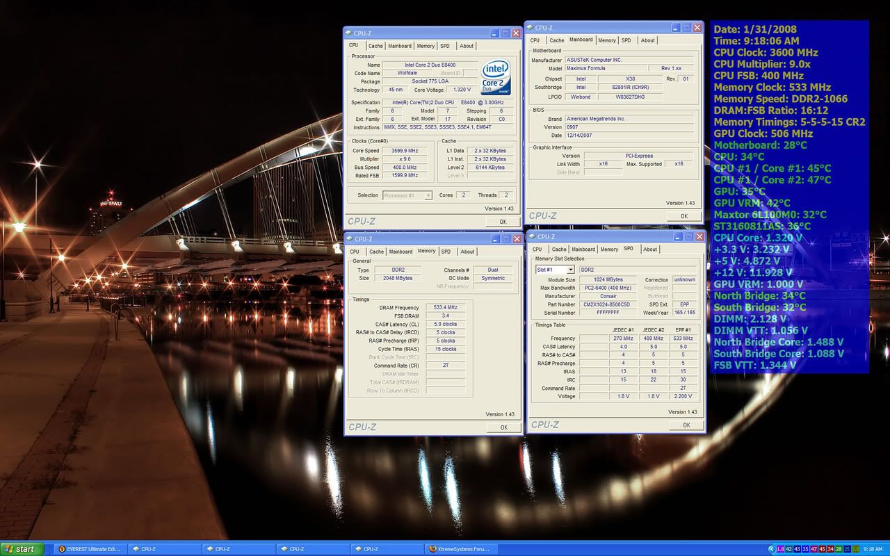

http://i11.photobucket.com/albums/a1...MaxFormula.jpg
It's Everest's OSD. Go to Preferences and setup your OSD (on screen display...I think)

I have a question of my own. I'm currently at 9x400 at 1.35v vcore with vdrop pencil mod on the board, as described on the OP. Works great :)
It's perfectly stable and when I get back from work I'm going to continue pushing it.
However since I attached my older drives it takes a much longer time to get past the hardware detection screen. The system stalls after finding my USB mouse, which is after the memory detection. I hear one of my drives do a little work and no matter what I change in the bios it always does this. The stall takes about 20 seconds. I also tried playing with the ATA(PI) detection time but that doesn't change anything, like I said.
With my E8400 i have problem running with 8.5x multi.
It is stable with 9x425 but not with 8.5x450.
Bios is latest 0907.
Yup that sure boosted it, thanks! :D
