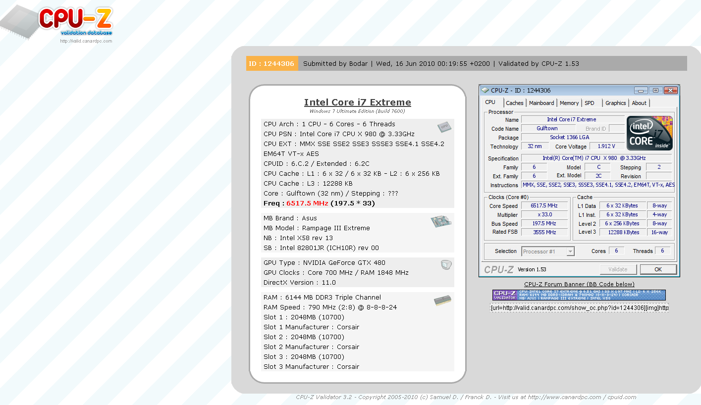

Out of all the chips tested this is the 2nd best so far... http://i43.photobucket.com/albums/e3...t/06630ghz.png

Thanks man! I decided to basically test 20 chips total.. Not all where 980x's A couple x5660's and a xeon w3680 as well.. This time I tried to get the same batch number for all 980x's.. This batch is great! So far the
lowest clock I've seen on this batch is 6400mhz.. There's 2 chips that I really like but I'll probably sell the rest.. Just decided to go nuts this time.. Hope to make a little money back once I sell them. cheers!! -Beaux
Sorry I referred to you as Austin instead of Bodar, I was looking at your location and it stuck in my mind lol.
I assume you are using LN2 to cool these chips at that speed?
Don't think there's any other way to go over 6ghz with a GT...
