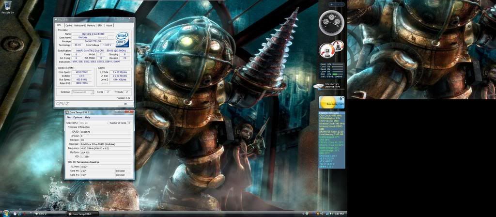

Sup all.
Got my Q6600 running at 389X9 for an even 3.5GHz, stable.
I'm a bit worried about the vcore I have to use to get it there, probably due to the high VID of 1.3250v.
I tried lower vcore's but it will lock up on the desktop and reboot or give me a BSOD and reboot.
I can get it to 400x9 for a nice 3.6GHz but temps go too high and it fails prime.
I also tried 438x8 for 3.5GHz but having trouble keeping it stable, NB temp goes over 47 and upon booting it fails the OC with either no display init or just hangs at detram.
I have removed the cooling assembly when I received my Maximus (freezer popped right off) I have applied AS5.
My TRUE and Q6600 are lapped with AS5, also using a push/pull configuration.
I would just like some input on my high vcore and my settings if theres anything I might need to change.
Here are my settings and screen shots of temps below.

http://img245.imageshack.us/img245/8...3500jz2.th.jpg
