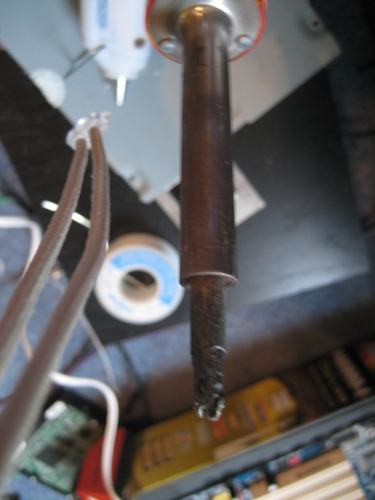

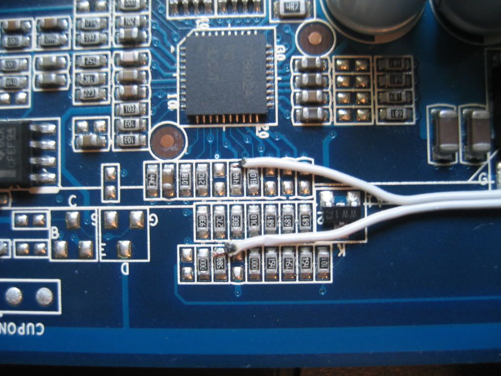

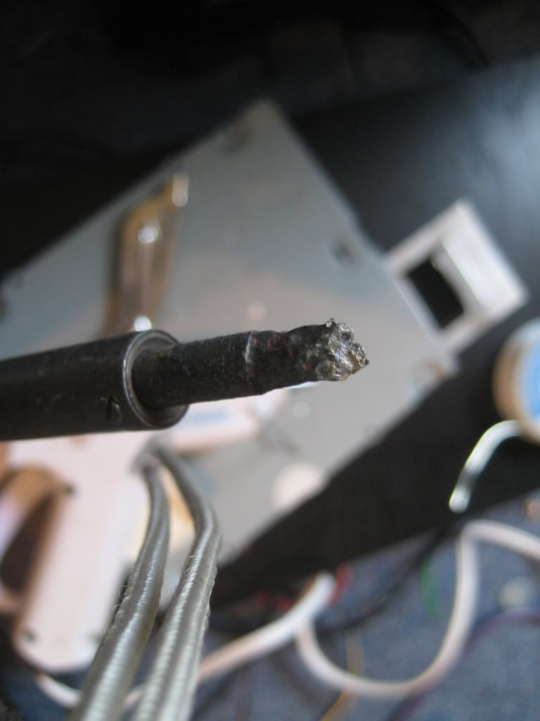

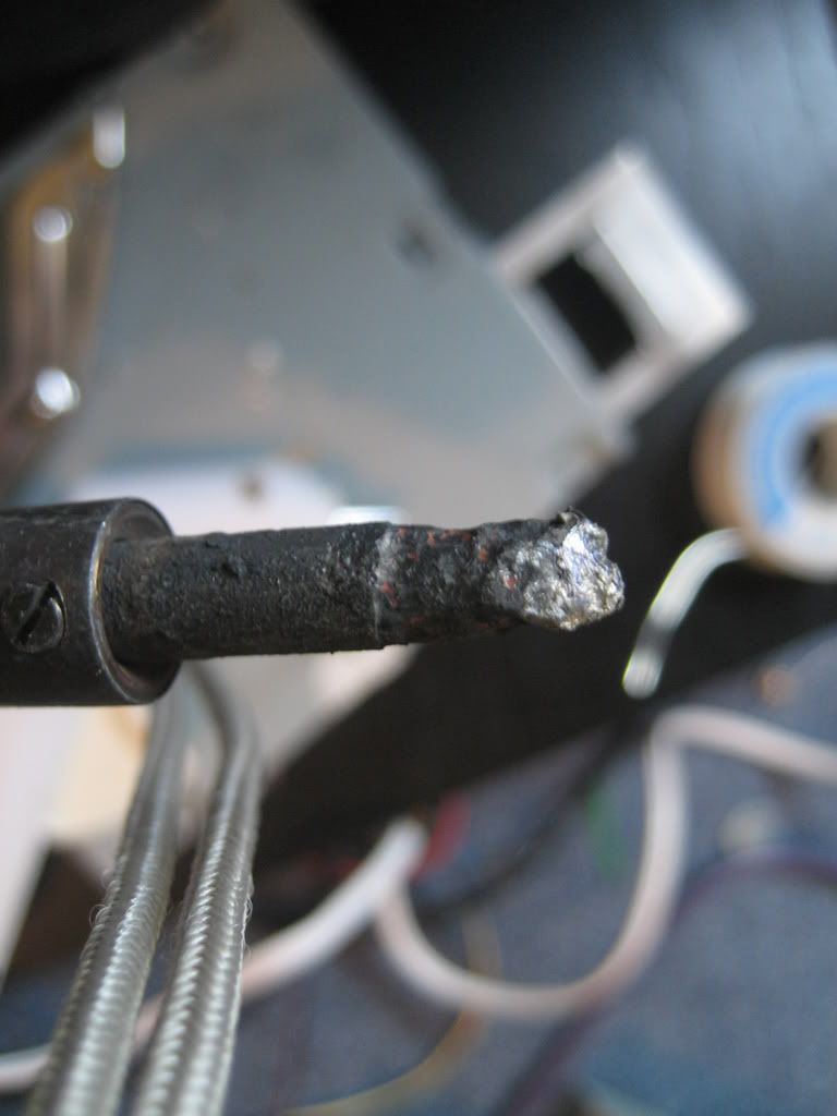

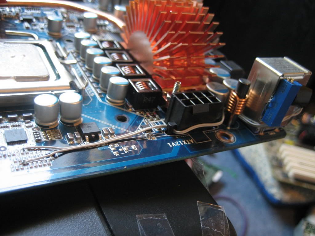

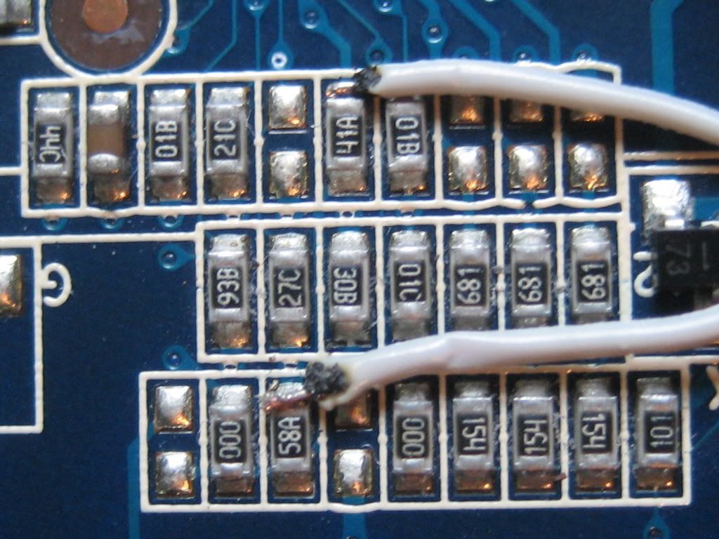

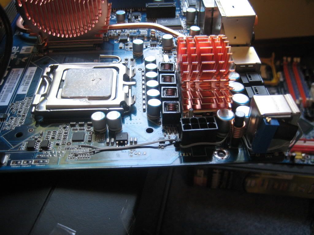

As for the voltmod, I find placing a couple of layers of electrical tape just below the solderpoint really helps... it also makes sure you dont let the same wire touch both sides of the resistor.... I used a cheap $10 iron but it came with a fairly pointed tip, I think the most important thing is to have a clean tip everytime you use it.... and never let the gun touch the resistor too long, the solder should melt as soon as you touch it.....
