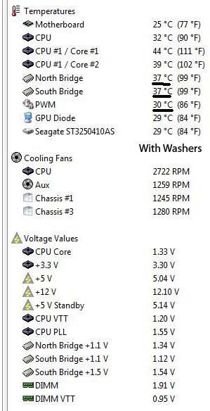

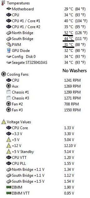

Much better George, good work. Made a big difference to my board too.
Thanks Cryptik..:cool:
I forgot to mention that i use a BTX case...!
Yeah quiet better like that m8...+1 for the WasherMod \o/

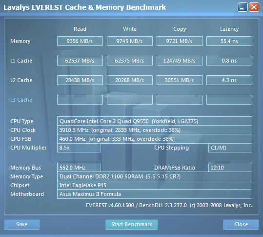

Bandwidth --- unchanged altho my copy speed is up about 300mb/s

Pull-Ins still do not work, tREF is unlikely to change for ram compatibility, seems to boot faster altho I did not time it, I have 1307 on bios 1 and 1802 on bios 2 so maybe later I will measure boot time. Going to try and lower volts now will edit and update this post if I can run lower on any setting.

Very nice George! Seems that washers did the job. :)
Seems like my board should also benefit from them but there's no way i'm unistalling it... :p:
Thanks for sharing your findings m8! :)
