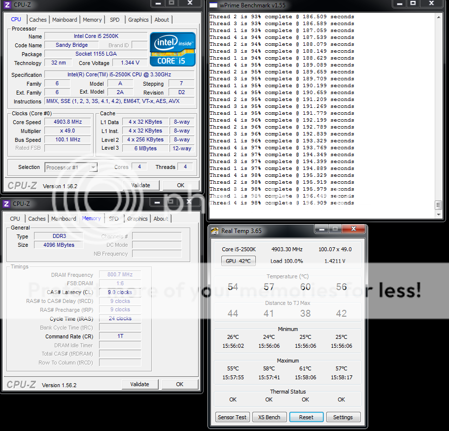

I picked up a C batch 2500K close to Alex-Ro's chip. Mine is L041C123 and it seems to be a decent clocker. Initial testing... WPrime 1024M but I'm also posting a LinX run in the official SB FPO Batch list. TP67XE and Noctua NH-U12P with push/pull.
http://i695.photobucket.com/albums/v...e1024Mload.png
Looks like you got a very good chip, Congrats!!
