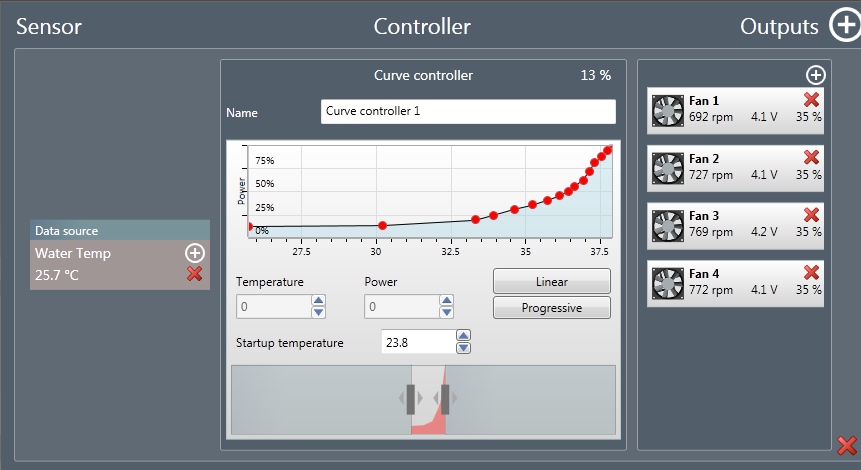

Yeah i'm going crazy with the curve controllers now. Tried the PID but i'm not sure what is the control variable (integer ? % as in 10% = 0.1 ? is it relative to fan minimum or absolute 0-100 ?), and not sure what is the 4th variable (the delay for D ? is it a sample time in order to avoid peaks ?). Went through a square impulse measurement (thats a good one hour experiment here for just one impulse) and applied some known PID recipes, but ended up with too slow response and oscillation...
I used a progressive curve too first but that leads to oscillations, and the fans i use (gentle typhoons) have resonant frequencies, that's quite unpleasant. I went to a stepped curve instead, it works rather well, no more fan speed oscillation and they dont dwell over resonant frequencies (i adjusted each step so the fan speed results in a smooth noise):
http://gmat.free.fr/pix/curve.jpg

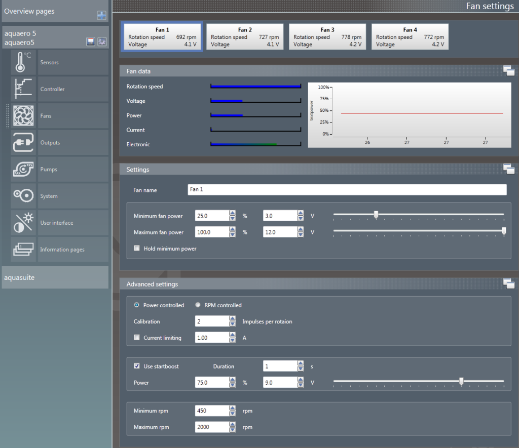

Also since you have the Aqua pump, can you show a screenshot of the pump setup menu please? much appreciated and Thanks.. I'm curious if it will be worth switching over from my dual D5 to the Aquapump just for the sake of ease of use and the customize features..
Yeah, I figured I'd get familiar with the unit interface and menus first, then the Aquasuite, and finally sort out what if any settings are specific to one or the other. The Aquasuite is definitely the easier way to go for the basic settings, but I can't seem to figure out how to create a logging chart in there yet.
Played a little bit with the pump screens in both, but all I can figure out is how to manually control the pump speed and it doesn't appear the aquabus is picking up RPM. Guessing you have to run the RPM out on the pump and use up one of the channels to read that. I also can not find where you can dynamically control the pump via controls. I would have figured you could plot a curve for speed in Hz relative to water temp, but I'm not seeing that option yet.
Here are a few screens I could capture:
http://img822.imageshack.us/img822/6874/aquaero512.jpg
http://img403.imageshack.us/img403/6890/aquaero510.jpg
http://img404.imageshack.us/img404/8422/aquaero509.jpg
http://img220.imageshack.us/img220/8859/aquaero511.jpg
http://img214.imageshack.us/img214/9656/aquaero508.jpg
Maybe there is more I haven't found yet...still figuring out where things are at and have a ways to go.

I feel like a kid with the cookie jar. I finally see how you can create charts on your own page...:up:
http://img11.imageshack.us/img11/1374/aquaero515.jpg
Have you tried virtual sensors yet, I prefer using air-water delta as "control" value since temperature in my room changes all the time.
http://i826.photobucket.com/albums/z...67/virtual.png

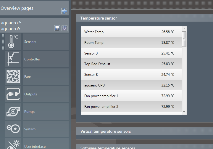

(1) What exactly is "Fan 1 Amp Temp?" What do you have hooked up to that sensor?
(2) How are you measuring air temperature ("Air Sensor 1")? What type of sensor are you using?
(3) What type of sensor are you using to measure water temperatures ("Water Sensor 1")?
Thanks.
1) That's just the built in AQ5 sensor they normally call "Fan power amplifier", I just renamed it. It has one for each of the four fan channels and also an aquaero CPU temp sensor already built into the unit.
2) I just used one of the included flat style temperature sensors. It's hanging freely in the air, so I called it air. In actual use I could see running a few of these out to the radiator inlet "Air In" side and maybe using another to measure case temp, etc.
3) That's the built in water sensor on the aquastream XT, it comes through with the aquabus connection.
I'm still just tinkering with a demo type setup on my work bench. It's just a small simple loop with the pump/flow sensor/king flow meter and a couple of fans just sitting there. The software sensors (CPU,GPU,MB,HD) are coming from my normal test PC through the USB, but I don't actually have the AQ5 mounted yet...just tinkering so the actual charts are not going to make much sense with the demo setup I'm playing with.
I like the idea of using one of the temperature sensors as an air temp sensor. :up: I'm going to borrow that idea.
In regard to point (1) the temperature one sees when connecting a fan to each of the fan channels is actually the temperature on the AQ5 side? At first I thought the AQ5 was somehow reading a temperature from the fan which made no sense to me. Also, what do you mean by "aquaero CPU temp sensor already built into the unit?" Is the AQ5 reading the temperature of the AQ5 processor?
Thanks.
Yeah, I could be wrong, but I'm seeing 5 temp sensor's built into the unit, one for each fan amp and one for the AQ5 CPU. I'm currently only using 2 fan channels and I can clearly see the higher temp of those two amps vs the last two. I don't think it has anything to do with the fan, it's just the heat being dissipated based on the current and reduced voltage setting.
These little fan amp temperatures are what I figured will be the limiting factor in how much fan you can string together and how well the heatsink or waterblock works. I'm not sure the AQ5 CPU temperature is ever a limiting factor, but I haven't really watched it as it's loaded. Perhaps logging all the channels possible, etc might start raising temps...not sure.
