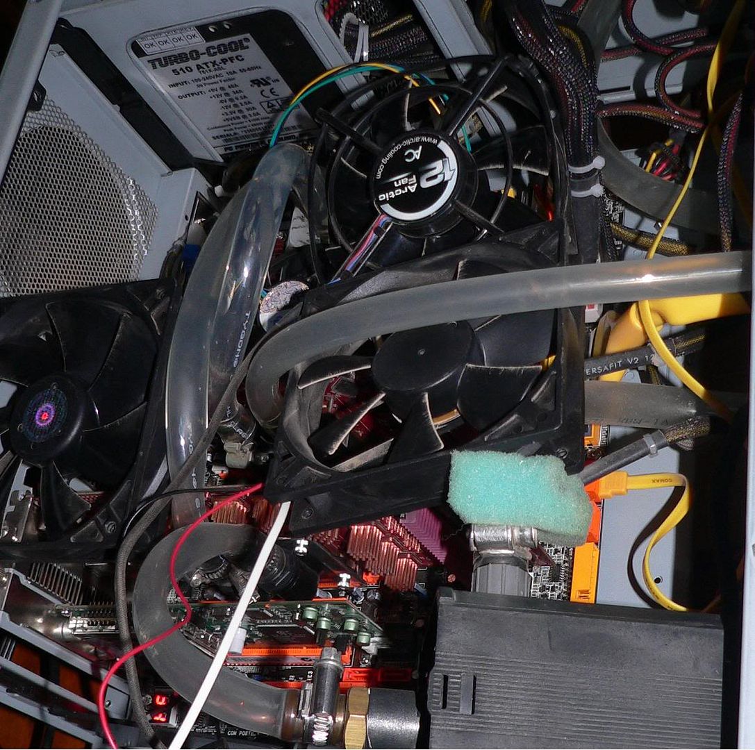

Maybe so, but its the stock cooler. 120mm over the ram likely helps alot though. :D

lol i figued, as that 26c PWM temp betrayed you. How about temps without the fan?BTW, what's up w/ that ram? No Mushkin?:D

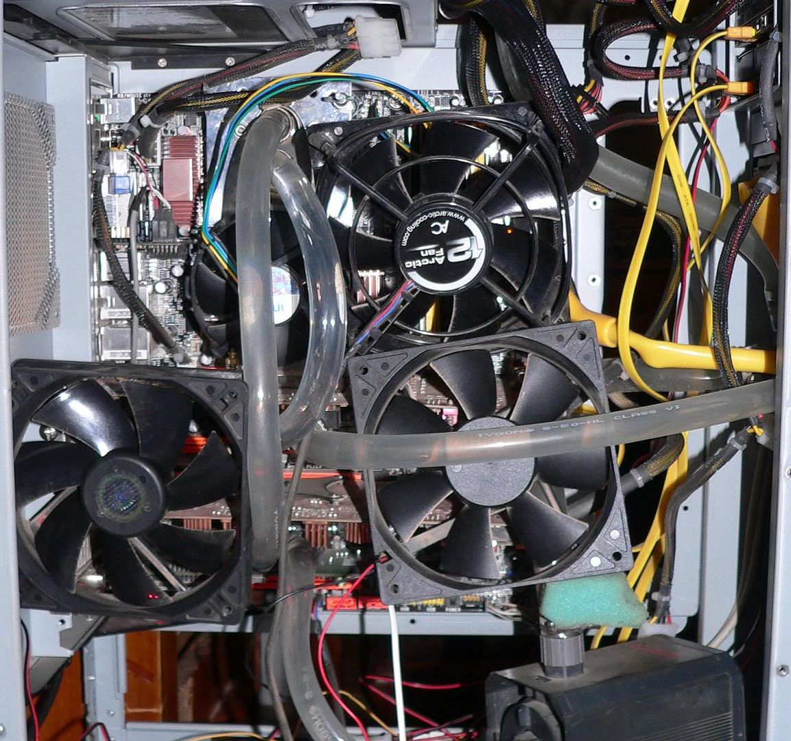

e6600
2x1g TEAM XTREEM 800@4-4-4-12 D9GMH
http://i3.photobucket.com/albums/y83/dasa09/pc.jpg
http://i3.photobucket.com/albums/y83/dasa09/pc1.jpg
Control CPU Frequency: Manual
x CPU Frequency (Mhz) 390
PCI-E Overclock: 160
Software Reset Clockgen: Enabled
Memory Overclocking: Enabled
Overclock Frequency (Mhz): 475
CPU Vid Control: 1.5v
CPU VID Special ADD: AUTO
DDR2 Ram 1.8 Voltage: 2.34v
CPU VTT 1.2V Voltage: 1.31
NB Core 1.2V Voltage: 1.48
NB PLL 1.8V Voltage: 2.13
NB PLL 1.2V Voltage: 1.21
NB PCI-E 1.2V Voltage: 1.22
NB Core 1.2V convert from: 2.14
SB Core 1.2V Voltage: 1.23
CS Output Timing: Delay 1/4 Clock
CK Output Timing: AUTO
Dual channel Split Mode: Auto
ADDR/CMD Driving Pre-AMP: Disabled
ADDR/CMD Driving Strength: 15
Clocking Driving Pre-AMP: Always
Clocking Driving Strength: 15
Address/Command Timing: 1T
Memory Timing Select: Manual
CAS Timing (TCAS): 4
Read RAS-CAS Delay (TRCDR): 4
Write RAS-CAS Delay (TRCDW): 2
RAS Precharge Time (TRP): 4
Cycle Time (TRAS): 8
Row Cycle Time (TRC): 12
Refresh to Active (TRFC): 28
Bank to Bank CMD (TRRD): 3
Write Recovery (TWR): 5
Read-Write Command (TRTW): 3
Write-Write CS (TWTW_CS): 2
Write-Read Command (TWTR): 3
Write-Read CS (TWTR_CS): 2
Read-Read CS (TRTR_CS): 2
Read Data Transfers: 5
you are at the edge for Micron. I've seen 12 and 2.4v kill a set ;)

That's correct, it's best for your mem to use the lowest drive strength you can without losing stability.
ok thanks for the info
shame this stuff isnt as tough as bh-5 it could handle just about anything :)
guess ill play around with a lower 1t speed or higher 2t
but for now 500mhz 2t 2.3v strength 5 will do
