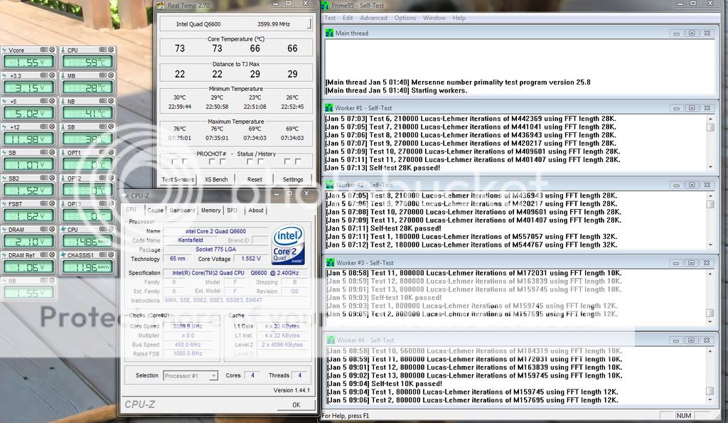

I got an error in Prime after an hour and a half but it did make it through the 8k range. From there I cut the PLL a bit (per Grnfinger's earlier recommendations), ran Prime, added to VTT, ran Prime, cut PLL again, more Prime, then bumped vcore and ran Prime again. That last move has been stable for almost 6hrs (once through Prime) and is still going (settings below)
CPU Voltage : 1.568 / actual : 1.552 (raise of .02 didn't show an increase in bios hardware)
CPU PLL Voltage : 1.52 / actual : 1.61 - 1.63
North Bridge Voltage : 1.53 / actual : 1.55
FSB Termination Voltage : 1.54 / actual : 1.616
http://i713.photobucket.com/albums/w...er/1-5pass.jpg
Assuming Prime is stable for 24hrs, I'm tempted to leave things where they are unless someone sees an error in my setup process, something alarming or something that could or should be improved.
EDIT: I'm kinda worried about my temps. I know they don't get to the 76 degree mark during normal use but is this something I should be fearful of? Considering every attempt to run a lower vcore results in Prime failures, I'm assuming I just happen to have one of those chips (or motherboards) that needs a lot of juice to OC.

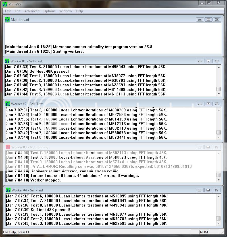

Ugh...... I'm about to throw in the towel after yet another Prime failure last night.
CPU : 1.575 (actual 1.56)
PLL : 1.52
NB : 1.49
FSB T : 1.52 (actual 1.62)
http://i713.photobucket.com/albums/w...owler/fail.jpg
Before I go crazy I think I need to get some clarification. As you can see, I've got my voltages pretty high as it is (max temps were 80 in 2 cores with 15 degrees to tjmax) and I think I'm at the level where pushing my cpu or vtt with any more juice might start doing some damage (although, I may be off base here).
Is it likely that the 48k error I had was due to something else like my RAM, graphics card, PCI-E frequency, or maybe even Windows? I ask because when I woke up and turned my monitor on to see how the night went with Prime, Windows was acting "funny." I was as if someone was hitting Alt/Tab all the time because every time I'd click on the prime window, the realtemp window, or even the start "button," within a few seconds that window would de-select itself. Just shutting down without resorting to holding in the power button took some quick finger speed to key the windows key, arrow down and hit enter to get "shut down." This may have been because of a Tivo Server program that I had installed because there were half a dozen Tivo Server error boxes open as well - I uninstalled it this AM.
