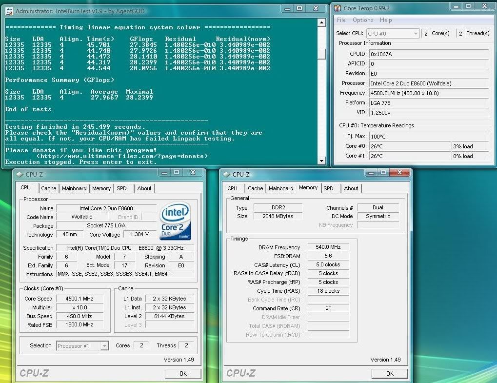

After a few adjustments i have seen some amazing O/C's with my E8600.
Mind you that this is on air and max load temps were 69c at 1.42v (bios)
http://i150.photobucket.com/albums/s...40-2000fsb.jpg
http://i150.photobucket.com/albums/s...aw/44-2200.jpg
http://i150.photobucket.com/albums/s...45-1800fsb.jpg
http://valid.canardpc.com/show_oc.php?id=471360
http://i150.photobucket.com/albums/s...46stable-2.jpg

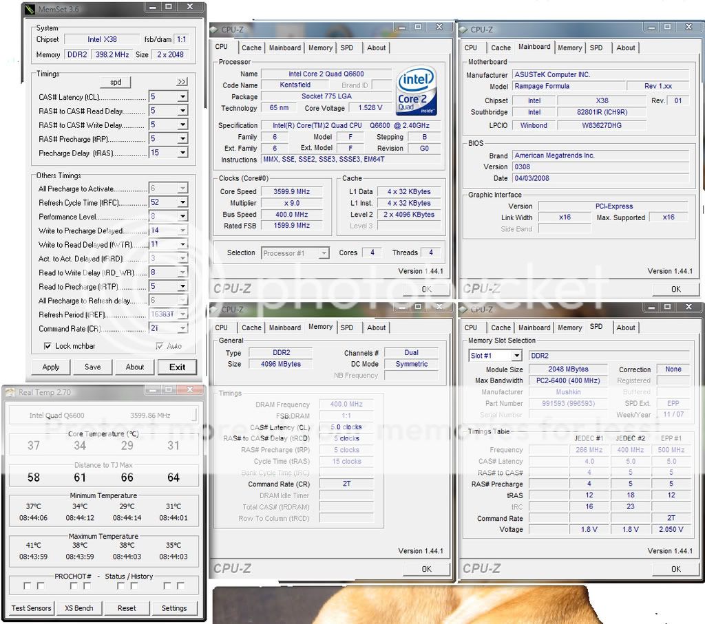

When I set the FSB to 425, it hangs at DET DRAM. So I looked at the OCZ site for my ram, and it says 2.1v - 2.3v, but not to exceed 2.1v if it says so on the lable. Mine seemed perfectly stable at 2.1v, so I didn't think anything of it before. I looked at the stickers and it says 1066, 5-5-15 at 2.2v. So I bumped up the juice to 2.21v and it posted, but locked up on the post screen. I reset it and upped the voltage again to 2.3v, and it posted again, at least occasionally. Sometimes I would get a weird error saying "New CPU installed. Update the BIOS to take full advantage of the features for this CPU." Other times I got a Bootmgr error and Windows wouldn't load :eek: The CMOS wouldn't reset right away for that one either - it took a little trying :(
I was up to almost 2:00 am last night working on the FSB issue. I got tired of trying to figure out why it wouldn't hit 425 FSB and ran Prime at 9 x 424 (3.8 GHz). It went for over 9 hours error free. :confused:
Included for your viewing pleasure is a MemSet ss. Any suggestions for getting over the 1063 MHz wall would be appreciated.
I tried every one of them and either hung at DET RAM or had stability issues. I was eventually able to get things stable at 8x450 for a 24hr Prime run by increasing my voltages one by one but they had to be much higher than any others I saw around here/the net and my temps got pretty high during the stress test. Here were my 8x450 settings from a previous post here...if you see where I might have messed something up please feel free to correct me:
http://www.xtremesystems.org/forums/...postcount=7647
For now, I'm using all my 9x450 settings but had to change CPL from 8 to 9 or I got BSOD when the OS tried to load (post was fine). I'm wondering if I had one of my CPU Config settings different than I do now or had something else changed because I didn't figure I'd get anything other than BSOD with these CPU, PLL, NB, and so on volt settings. Will start Prime and see what happens.
I think both your nb and cpupll volts are too high for that overclock. You'll be surprised, but I'm sure even all auto settings would give you lower volts and still stable.
First off, run on the 333 strap, set both gtls to 67, advance both DRAm clockskews to 300 each
Set PL to 8
Too high vcore can also become a problem but you should generally add .40v for that 400mhz difference between 3.2 and 3.6ghz.
I'll set pll to 1.60v (real), check hardware info section in bios
NB to 1.55v
Run ram 1:1 so 900mhz 5-5-5-15 (you can tighten things later) set full max recommended volts too; test later with memtest if you're still having problems
Hopefully, this is not a cpu wall. remember, not all chips can do 3.6ghz stable. Goodluck.

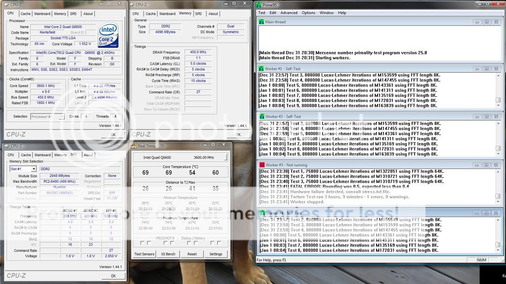

Prime went for 5 minutes then got an error.... suggestions?
Attachment 91625
EDIT: just noticed the post above this one. Will try those recommendations.

made all your recommended changes but I have 2 questions:
1. Re. vcore... you suggested adding .4v because I moved from 3.2 to 3.6ghz. Are you suggesting I increase the vcore from 1.54 to 1.58? --- just want to clarify
2. My PLL voltage... No matter WHAT I change it to, when I check the hardware section in the bios to see what it's 'really' at, I get the same reading: 1.68 or 1.69. I changed it down and checked, moved it down/rebooted/rechecked and still the same thing..... it always reads 1.68 or 1.68.
Other than that, all the other suggestions have been applied and I'll give Prime another shot.

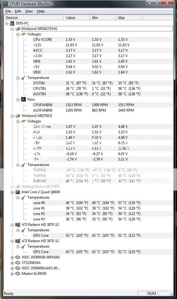

Does this help:
http://i713.photobucket.com/albums/w...aremonitor.jpg

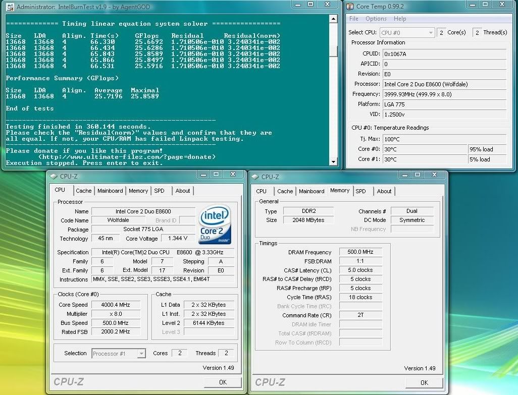

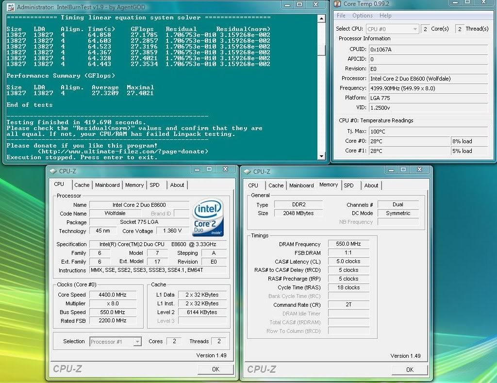

Hello guys,
Well after the fist post i did in this thread (post #7706), i did some voltage changes at the heart of the board.
Surprised myself with my findings.
I thought i would run a couple of tests to see just what voltage it took to make my O/C's stable.
As you can see from my last post that my voltages were kinda high to start with. But after adjusting most of the settings that count, i ran with it.
So these 2 tests were done with IntelBurn software, 10 irritations to be sure of stability 2X.
For each test run, i dropped the voltage to CPU 1 increment until i came up with the correct voltage required for my CPU.(Screen shots provided below)
Asus Rampage Formula
Intel E8600
Voltage as follows:
CPU ********
CPU PLL 1.50v
NB 1.55v
Dram 2.14v @ 2T
FSB Term 1.36v
SB 1.050v
SB 1.5v Voltage 1.50v
Load Line Enabled
All other voltage settings set to auto.
All the setting above were left alone on these tests, only adjustments i made were to CPU voltage.
(1.33750v to CPU bios)
4400mhz x 8 @ 2200FSB, Bus speed 550.0mhz @ 59c load temp.
http://i150.photobucket.com/albums/s...b133750v-1.jpg
http://i150.photobucket.com/albums/s...133750v2-1.jpg
(1.24375v to CPU bios)
4000mhz x 8 @ 2000FSB, Bus speed 500.0mhz @ 50c load temp.
As you can see i threw the Asus Probe software in there to help with CPU voltage confirmation. Yes it is a bit buggy as well.
http://i150.photobucket.com/albums/s...sb124375v2.jpg
http://i150.photobucket.com/albums/s...fsb124375v.jpg
As you can see in the screen shots i managed to get my CPU O/C'd stable with a huge decrease in voltage to CPU. :)
A Thank you to Renegade5399 @ BPC for the voltage help :)
I hope this will help others in the long run with there o/c's.
Source thread @ BPC
Enjoy :)

--DRAM set to 2.20 by me (this is the max Mushkin "recommends")
In AUTO for those 3 settings (and FSB Strap @ 333) I tried Prime and after about 1 minuted I got BSOD.
Thanks again guys.

Prime didn't error, but it looks like my 3rd core (normally the one that errors) stopped.
http://i223.photobucket.com/albums/d.../OCing/new.jpg
Thats odd my q6600 does 3.2 at 1.225v (stock VID) and the board undervolts it to 1.208.......then again it is #47 out of a batch but I didn't think batch really mattered when they glue 2 dies together from other batches.
You sure it not you memory settings?
I figured out why windows was sluggish, Hosed my OS with a couple BSOD's finding stable settings, reinstalling now, appears alot snappier.
Might be, but I upped my CPU V and I think that fixed it.

These settings ran stable for about 4 or 5 hrs and even though I worked up very slowly to them, I hoped to bring some of my temps down (maxed out around 74 degrees in 2 cores / 69 degrees in the other two) from Real Temp. If I bumped Vcore, PLL, NB or FSB down even one step I'd get an error in the 3rd core of Prime. So, I went back to my original settings and am running Prime again just to be sure I don't get any errors.
Assuming this looks OK, I'd like to get into improving my RAM but, much like what I've done so far, I'm rather in the dark about where to start, what to adjust and so forth so some advice (even if it's something to go read or research) would be great.
Mike

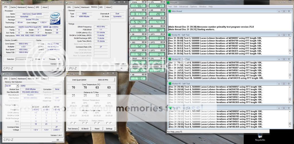

EDIT : Got the following failure
http://i713.photobucket.com/albums/w...450failure.jpg
Those redlines should do 1081 @ 5-5-5-15 easy
run the 12:10 divider and bump up the ram to 1081MHz
Next change these settings
Ai Clock Twister : Stronger
Transaction Booster : MANUAL
Common Perf. Level : 7
retest your ram if it craps out try clock skew first and alittle more volts, I think there safe to 2.2 volts so set max in bios to 2.12 if required

Figured out my crysis bench problem. Won't even bench at stock, either the bench is screwed, the game is screwed or my dx10 is screwed because it benches in DX9 fine.
got a Fatal Error 2 1/2 hrs into Prime95 "Blend" test (usually I'd just run the Small FFTs) in core #2. When I was running the Small FFT tests it was usually core #3 that would get the error.
http://i713.photobucket.com/albums/w...re2failure.jpg
Its vcore or pll, up pll first if that wont help, you'll need a drop or 2 of vcore
usally 512 errors its pll
Sweet! I didn't realize the iteration gave a clue as to what went wrong. Now I wish I would have been posting up my Pirme screenshots a week ago when I started this mess.
Had CPU Voltage : 1.5625 & CPU PLL Voltage : 1.60. Just bumped PLL to 1.62 and rerunning Prime.
