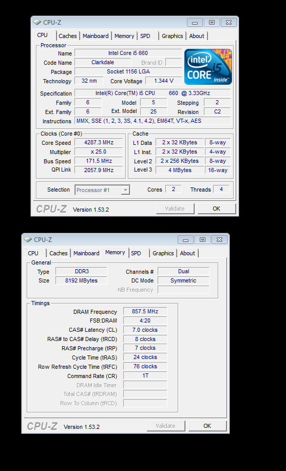

thanks T! Finally. cpu tweaker beta 1.4 worked too but you really need cpuz for the submissions. THis changed my life.

Playing around some more today with the 660, put it on water. Am working on lowering vcore a bit but so far this is where I'm at with it. Just doing short Linx runs, its stable at 4600mhz 20+ passes. The sensor on core 2 is a bit buggy I think.
http://img41.imageshack.us/img41/3294/4650mhz660.png
http://img687.imageshack.us/img687/1324/4650mhz6601.png
Put my 2x1gb of hyperx back in for 4700mhz, the 4gbkit requires more voltage. Still pretty happy with this.
http://img534.imageshack.us/img534/8...mhz660linx.png
http://img682.imageshack.us/img682/8...00mhzlinx1.png
