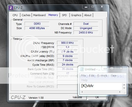

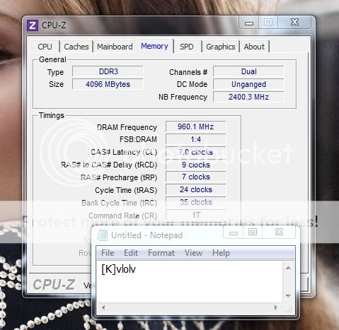

my Eco vdimm 1,65v
http://i798.photobucket.com/albums/y...a_eza/uhuy.jpg
more and max push at same vdimm
http://i798.photobucket.com/albums/y...za_eza/980.jpg
i bet can reach timing Flare @2000Mhz but i can't got stable :rolleyes:
please run 32m and see how far it can go regarding Eco.

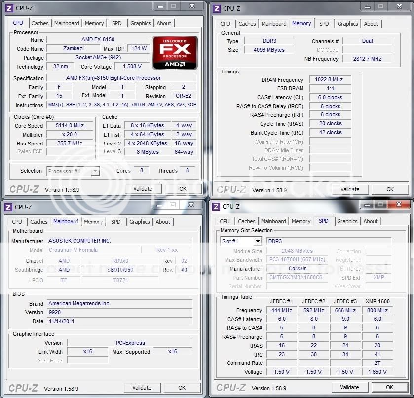

Here is my FX-8150 with my Corsair Dominator GT-1600mhz 6-6-6-20 hypers from my X58 setup
http://i438.photobucket.com/albums/q...katoft/mem.jpg
any effect if for tRAS & tRC if both is below18?
tRC =11, easier on Thuban IMC = sometimes more ram clock to offset bandwidth losses. chew* described it as your heart skipping a beat, it won't kill you but its not optimal for efficiency. Keep it at tRCD+tRAS.
As far as tRAS goes, on Hypers above 1800 Mhz you MUST slacken to 17 in most cases, my ram definately didn't pull 15 much over 1600. I could run 17 until 1900 though. It will continue to need slackened as Mhz increases.
I would have to guess that Riska is up in 1.85v-1.9v land with his sticks. My STT 2000 C7 needed 1.91v to validate 2022 Mhz CL6-6-6 on Thuban. My kit is a little better than average Corsair 1600 C6 looking at other results.
My sticks is getting 1.7825volts and they have never gotten more than that. On my Rampage black edition with my 980x id did nearly the same speed at same volts
Crosshair V Formula is overvolting Dram quite a bit, real voltage on the rams was at least 1.8V i guess. Never the less, very impressive frequency for 6-6-6 timings.

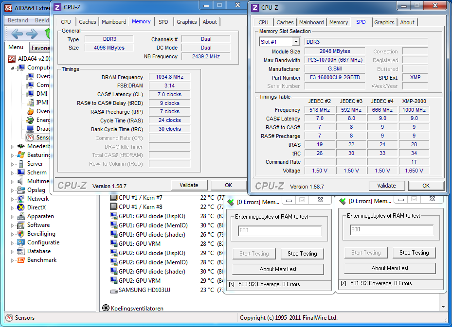

I got me a kit of Gskill Tridents 16000 C9 i planned to put into my mom in law's computer but after testing i think i am gonna keep them myself:
http://img.photobucket.com/albums/v6...mtestsmall.png
I think 500% HCI memtest can be considered stable.
I tried higher but it errored, more volts backfired badly, 165V in bios which is approx. 1.675V real seemed to be the sweet spot. It booted at Trcd 8 but it wasn't even remote stable.
From what i've read these babies should contain Elpida BBSE chips.
Only paid €60,- for this kit so not too bad i think. :)
Very nice.
better BBSE was able to pull just about 2000 7-8-7...
I'm eying a Team LV kit, 2000 9-9-9 ;)
Thanks.
I think this kit can pull that off too but not stable and i prefer to have my ram fully stable to avoid a corrupt OS.
I tried DDR2000 7-8-7 with 1.625V in bios and it did boot but once i tried to set trcd back to 9 and tried to save and exit it frooze. Some more volts will get me into Windows i'm sure but not as stable i would like.

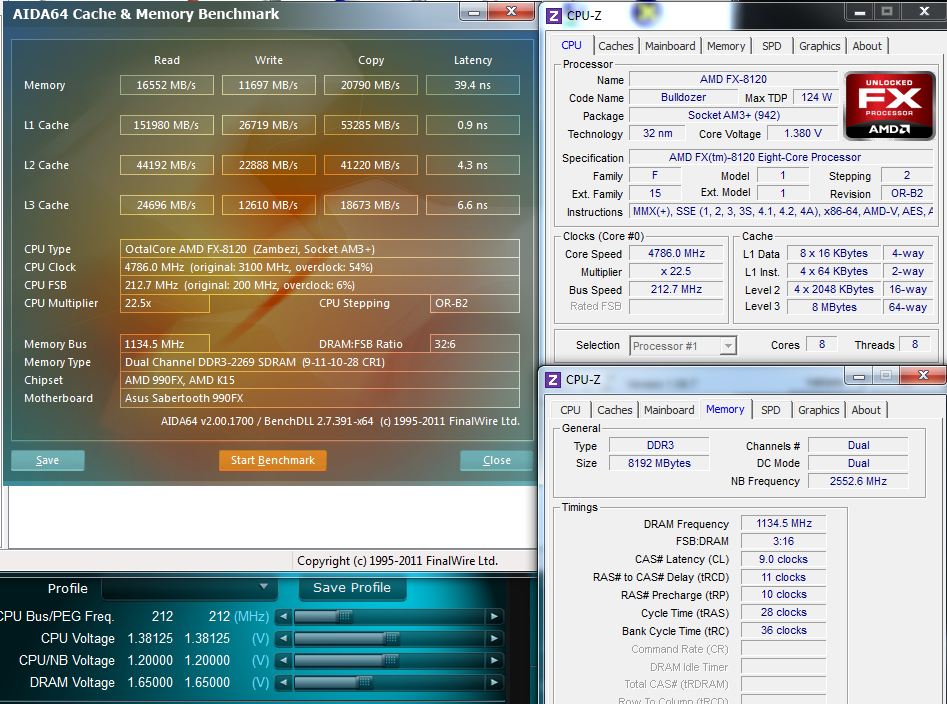

very nice RAMs here...I dont tried much some max RAMs at FX, for daily use Im at 1134.5 MHz( so 2269 MHz) 8-10-8-28-44-1T
It seems to me that GSkill is doing a pretty tight binning process for the ic on their kits. I think the good strong clocking ic are binned and held for their more expensive offerings. Their more pedestrian everyday kits seem to perform up to spec along with perhaps a nominal overhead.
