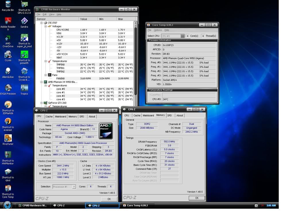

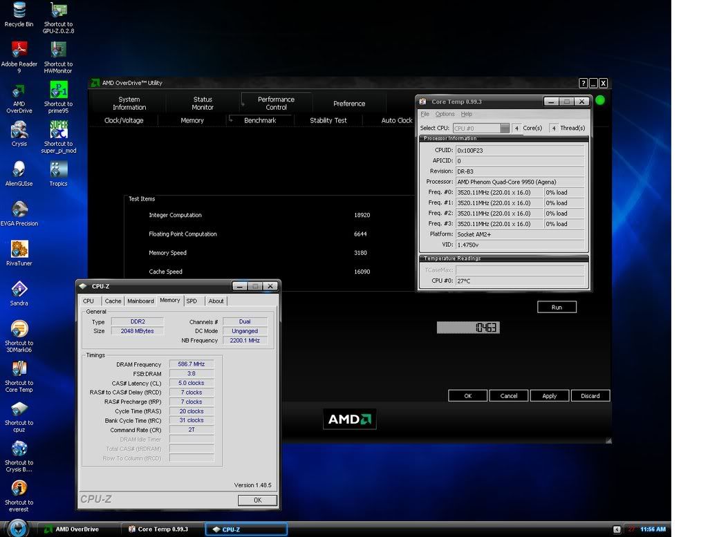

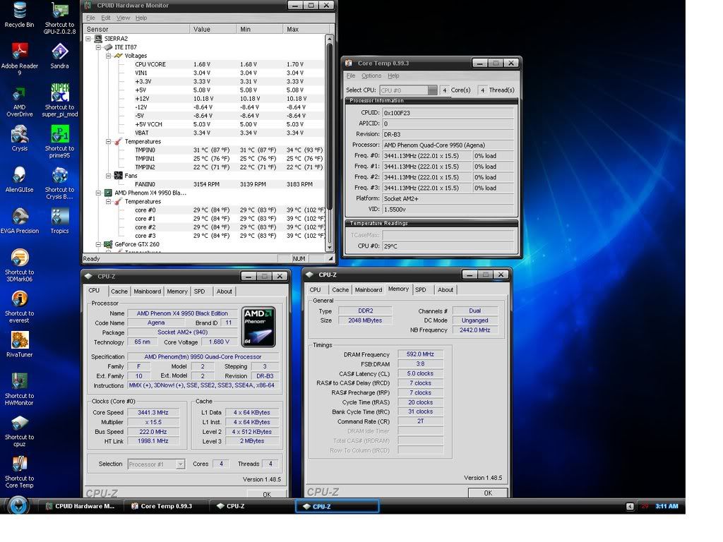

CPUTweak On or Off,, Seems when its Off its just as good as when its On for B3's..TLB fix dosnt apply to B3 only optimization tweaks do .Thus CPUtweak is Optimal but with only more Heat involved it seems.,,
The CPU tweak Disabled should ENABLE TLBfix with B2 but Not B3..
B3 will run In a normal powerstate but with performance tweaks disabled when CPU tweak is OFF..It will also not be affected by TLBfix using this Mobo..
Comparison ,,
HWmonitor,, CPU-Z and Coretemp .
Even AODshows a Temp differance Going Red to Green Circle.
CPU TWEAK ON
http://i168.photobucket.com/albums/u...CPUtweakON.jpg
CPU TWEAK OFF
http://i168.photobucket.com/albums/u...PUtweakOFF.jpg

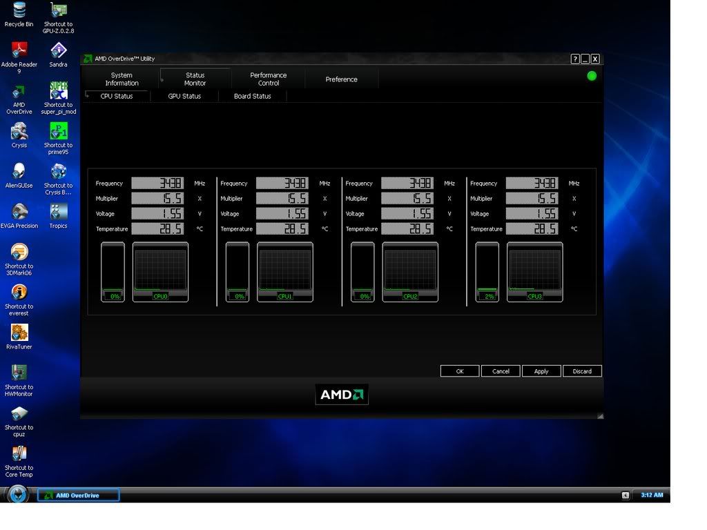

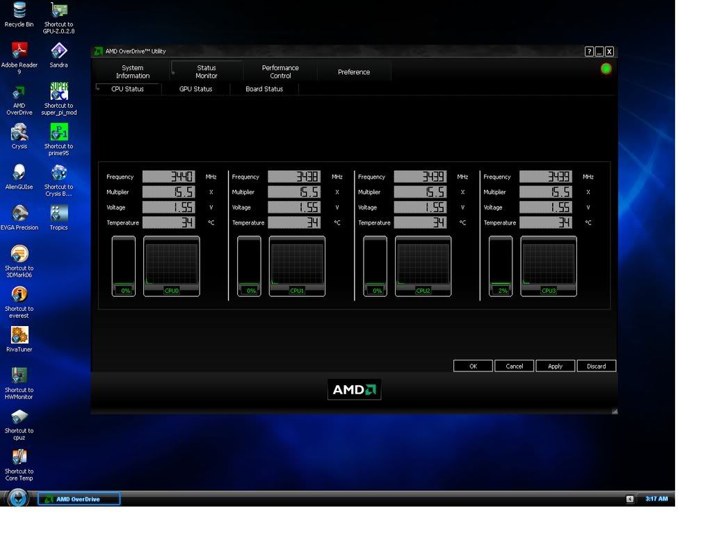

CPU TWEAK ON AOD monitor Red Circle.
http://i168.photobucket.com/albums/u...tweakONAOD.jpg
CPU TWEAK OFF AOD monitor GREEN Circle.
http://i168.photobucket.com/albums/u...ODgreenTLB.jpg

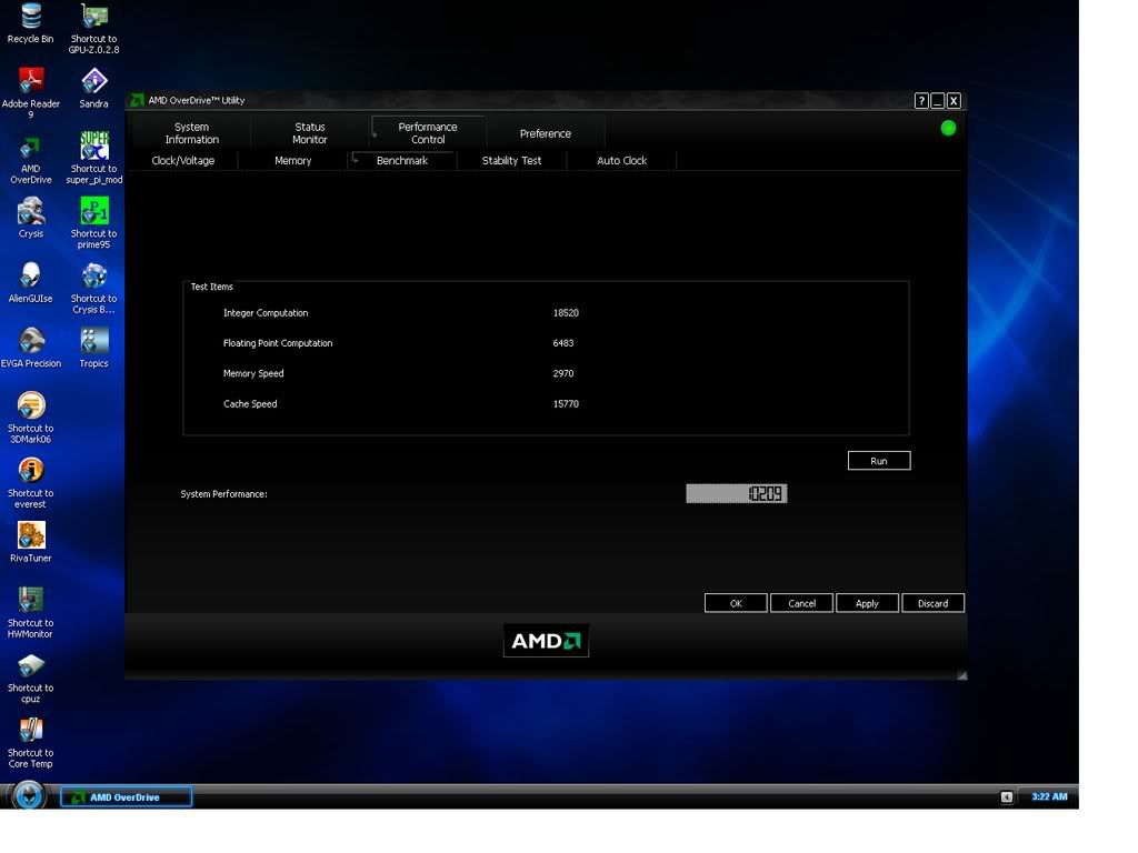

CPU TWEAK ON AOD Benchmark. Red
http://i168.photobucket.com/albums/u...ONbenchAOD.jpg
CPU TWEAK OFF AOD Benchmark. GREEN
http://i168.photobucket.com/albums/u...FFAODbench.jpg
Im not one to use AOD ,,but i had to see if i was right about the TLBfix being apart of CPUTweak.. For now it seems TLBfix is 100% disabled with it ON/OFF. For B2's you should see a decrease in Performance with AOD Benchmark tool .. It will be a big reduction like 10% if TLB is enabled vs Disabled.
As you can see (CPUtweak) is performance tweaking the CPU and not using TLBfix(disabled for B3 in OFF or ON mode)..
I would run Everest and other programs but wanted to keep this as short as possiable..
In the End CPUtweak OFF will lower the Temps with out a big impact on performance..Matter of fact some may be able to Overclock Higher with it Disabled..
This is the First time ive ever Turned CPUtweak off and with it on i still achieved 3.5ghz..
So Now i guess ill have to see what i can do with it off:D
Note: OFF vs ON didnt Impact my Voltages r.. if anything im shure it changes how much Power the CPU uses @idle and Under load .
Hope this helps some of ya get higher clocks with out worring about a performance hit from TLBfix,,B3's will be just fine,,

Yeah the AOD color thingy changes when the tweak is on or off.
Just tested with 3Dmark06, without the tweak(i pushed the circle in AOD, I think its the same?) it gave 12900 and CPU 4480, with tweak its 13100 and 4580, so little raise yes. And maybe the temps arent really so high even though what the board gauges tells. Leaving it on.

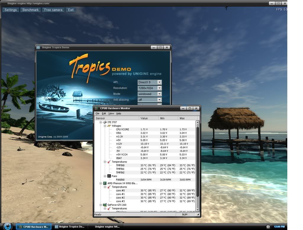

Using NO CPU TWEAK(OFF) update Amazing and performs nice too
After about two hours of fooling around with Crysis ,, Tropical and playing everything else such as DVD's to mp3's to just Surfing ,Ive noticed no impact on performance by not USING CPU tweak..My Temps are Night and day.Compared to my 3.45ghz post above. Im even using 1.70volts to heat things up,AMAZING i must say just AMAZING.
My Temps are The Lowest ive ever run @ 3.52ghz with No ACC an NO CPU TWEAK.:shock2:
http://i168.photobucket.com/albums/u...c_167volts.jpg
With Tropical running my GTX260 was butter .Almost No load on CPU ..Even though its a GPU test ,,
i xspected my temps to be way higher running this bench in 1280x1024 windowed with HWmonitor running.
http://i168.photobucket.com/albums/u...ra/tropics.jpg
Im really liking this 9950 and Most off all this MOBO..Once you get to know the Bios and such the ASUS 79-T really comes alive;)

XP64bit could be that factor..
I also am using 1.67v CPU and 1.5vnb ATM for those screens..my NB is only @2200mhz ..Although ive run it @ 2675mhz @ 3.5:D

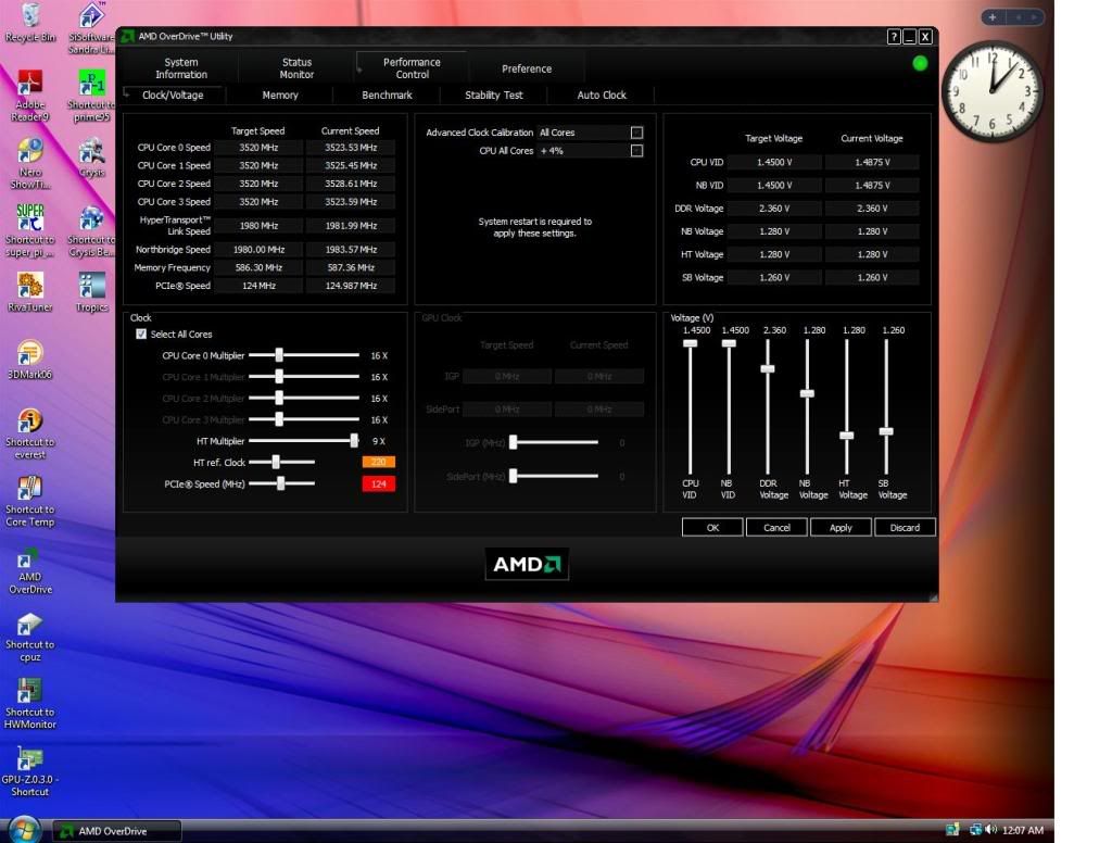

I'm going to go in the BIOS now and raise the multi a bit. Set the voltages accordingly to how you stated and, i'll post back, i'll take some pics if my cell phone can capture something worth taking, as I dont have a cam.
here you go got voltage, cell phone pic, so not great. Check it out, I am posting right now with those settings, ACC +4, I tried disabled and it didn't boot, maybe +2 will do, but I didn't try it.
any suggestions???
http://img389.imageshack.us/img389/1...1446hw6.th.jpg
^^^and it crashed shortly after :(
oh your right :/ damn this chip.

Raise your NB volts to 1.45v keep ACC+2 and keep CPUv the same ..Try some benches and let me know ..
Also make shure your HT is @2000mhz(2.0) NOT(2.4)ht..it has to be 2.0 if you raised your NB to 2400.

I finally was able to get 3.52ghz with Both Oses .. Vista is more demanding and to achieve the same 3.52ghz as XP32 i had to lower the NB to use the Same CPUclocks and Ram speed and Divider.

Update ASUS 79-T using ACC+4 and lowest volts i can use in Bios..
Hope This is Good for Vista32bit @3.52ghz:D

Now..what I find odd...I can boot into Win XP 64bit @ 3.4ghz...the exact same setting on Win XP 32bit and blue screen. 3.3ghz is 100% stable..but 3.4 no go..
Any know of a means to get more voltage beyond the bios max? vcore is capped at 1.7 and vdimm at 2.5, kind of a low cap to put on vdimm... maybe a modded bios in the wild?
Yep, got my new PSU (Enermax Modu82+ 525W with 3x25A 12V rails) and Thermalright Ultra Extreme 120 cooler, btw dont :banana::banana::banana::banana:ing buy this cooler for this motherboard.. it gets wrong way(the fan blows against the VGA-card) and didnt almost not fit to the board at all, also 1 memorystick place cannot be used at all with this. And was very very hard to attach the screws(althought didnt have to remove the board from the case).. and the case didnt almost not fit to close with this :D 1mm space between them.
But, some good things too.. idle now 39C without CPU Tweak option and with it 45C, old temps were 45 and 51C, also load dropped from 62C to 52C.
And the problem with the overclock, black screen etc .. it is still there with new PSU :( Im gonna try older bios if it fixes it.
Heres a pic from the comp. .. perhaps I should by a new Case :D
well i was able to boot into windows 32bit @ 3.4ghz...I am going to try some benching and see ow it does..I am sitting at 31*C at 1.55v 3.4ghz right now. I thought my wPrime score would have been better....
http://3800z24.info/Phenom/9950/32bit/3.4ghz_wPrime.JPG

Post a AOD or CPU-Z sreen of Ram and CPu settings along with Idle Temp and LOAD temp..
If your Temps are really High that might explain why your Oc is capped @3.2ghz.. Im shure between all of use here we can help to get you Higher in CPUclocks:up:

Ive benn running CPU @1.65v - 1.6875 with ACC+4 @3.52ghz and it gets me 1.73v Idle and 1.74v load.
My NB is @ 1.65v for up to 2600nb@3.5ghz this will give 1.55vid.. if you go above 1.65v the mobo will start setting Lower VIDs and Use More Vcore.
ASUS 79-T Max Volts for CPU and NB will cap @ 1.7v if you use VDD @ 2.8v it will allow 1.74-1.75 under load and 1.72v -1.73v idle. Also ACC + settings can raise this a little more under load. I dont know of a Bios Mod to get higher Volts ATm.
