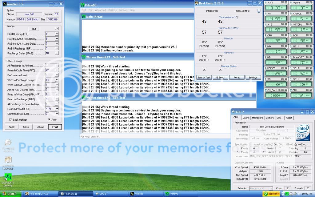

Originally Posted by
CryptiK
Try:
Ai Overclock Tuner: Manual
OC From CPU Level Up: Auto
Ratio CMOS Setting: 8
FSB Frequency: 475
CPU Clock Skew: Normal
NB Clock Skew: Normal
FSB Strap to North Bridge: Auto
DRAM Frequency: DDR2-950MHz (lowest choice)
DRAM CLK Skew on Channel A1: Advance 300ps
DRAM CLK Skew on Channel A2: Advance 300ps
DRAM CLK Skew on Channel B1: Advance 300ps
DRAM CLK Skew on Channel B2: Advance 300ps
DRAM Timing Control: Manual
1st Information:
CAS# Latency: 5 DRAM Clocks
DRAM RAS# to CAS# Delay: 5 DRAM Clocks
DRAM RAS# Precharge: 5 DRAM Clocks
DRAM RAS# Activate to Precharge: 15 DRAM Clocks
RAS# to RAS# Delay: Auto
Row Refresh Recycle Time: 55 DRAM Clocks
Write Recovery Time: Auto
Read to Precharge Time: Auto
2nd Information:
Read to Write Delay (S/D): Auto
Write to Read Delay (S): Auto
Write to Read Delay (D): Auto
Read to Read Delay (S): Auto
Read to Read Delay (D): Auto
Write to Write Delay (S): Auto
Write to Write Delay (D): Auto
3rd Information:
Write to PRE Delay: Auto
Read to PRE Delay: Auto
PRE to PRE Delay: Auto
All PRE to ACT Delay: Auto
All PRE to REF Delay: Auto
DRAM Read Training: Disabled
MEM. OC Charger: Disabled
Ai Clock Twister: Moderate
Ai Transaction Booster: Manual
Common Performance Level: 10
Pull-in of CHA PH1: Disabled
Pull-in of CHA PH2: Disabled
Pull-in of CHA PH3: Disabled
Pull-in of CHB PH1: Disabled
Pull-in of CHB PH2: Disabled
Pull-in of CHB PH3: Disabled
PCIE Frequency: 100
CPU Voltage: 1.4250
CPU PLL Voltage: 1.50
FSB Termination Voltage: 1.33850
DRAM Voltage: 2.14450
North Bridge Voltage: 1.39150
South Bridge 1.5 Voltage: 1.50
South Bridge 1.1 Voltage: 1.10
CPU GTL Reference (0): +20mv
CPU GTL Reference (1):-15mv
CPU GTL Reference (2): +20mv
CPU GTL Reference (3): -15mv
NB GTL Reference: Auto
DDR2 ChA Reference Voltage: Auto
DDR2 ChB Reference Voltage: Auto
North Bridge DDR Reference: Auto
CPU Configuration:
C1E Support: Disabled
Max CPUID Value Limit: Disabled
Intel Virtualization Tech: Disabled
CPU TM Function: Disabled
Execute Disable Bit: Disabled
Load-Line Calibration: Enabled
CPU Spread Spectrum: Disabled
It may be your CPU limiting you through, that is a fairly high vcore you have for 3.7GHz already, if going any lower on the vcore makes you unstable at 3.7GHz, I'd say you are actually CPU limited.
