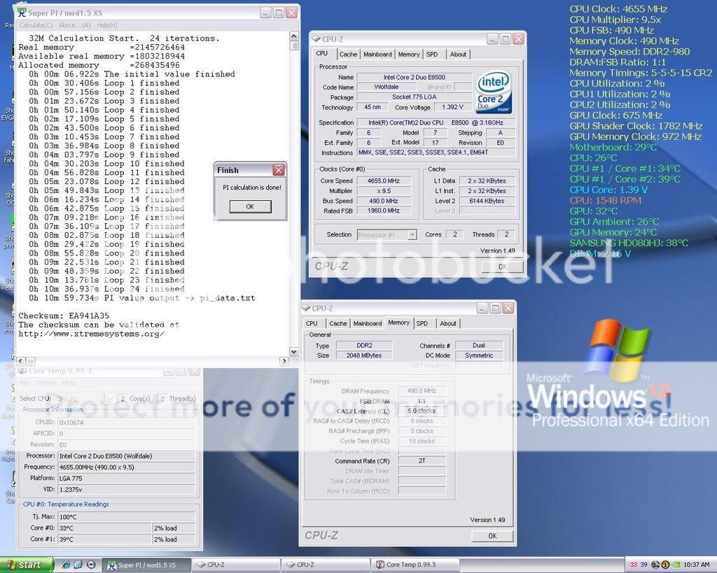

I ran IBT but after that i ran prime95 but computer just froze after 20min, then i tried to restart and when it got to windows it just restarted by it self... damn :( whats wrongs? what am i doing wrong here? do i need more volts anywhere? those are my latest settings but couldnt get it stable...
Here is mine
Batch# Q831A779
I will try to push it further, still learning about all of this so ill get there eventually.
I thought it wasn't too bad for a days effort :D
Its stable with Linpack/Prime95 etc etc. Can run for hours no problems
Thats what i wanted on mine but seems like im the only one getting problems getting there, if there were people here with a P5Q Deluxe and a 8400 that could give me a hand...
Thanks :)
I will drop the vcore a little as i go, its stable as it gets for now.
I did attempt 4.5ghz, but keeps crashing on SuperPI 32M
So ill have to do some more reading i think and work that out.
Boots to windows no worries @ 4.5, just not stable but then i might need more volts still. Something for another day
Actually under load its 1.296vcore - seems it wasnt loaded enough when i took the screen dump :)

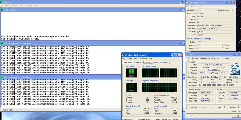

cranked this out yesterday
http://i48.photobucket.com/albums/f2...table45ghz.jpg
crap vid cpu though 1.25 but its low volts high oc so whatever.
batch q824a540
E8400 Q832A446 : stable at 4.3 with 1.22 under load, and boot Windows at 5 with 1.37...in progress

A little more playin around this morning. This is not prime stable but enough to pass 32m and surf :)
http://i544.photobucket.com/albums/h...95x490_32m.jpg
nice. looks like similar results to my chip, what is your stepping?
I got my new E8400 E0 this afternoon, and so far I'm pretty amazed. I thought this cpu was a dud at first, as it would not boot above 4.0 GHz at any voltage. Then I turned down the VTT to 1.1v and now it o/c like crazy! Here is as far as I got with the ram @ 585 Mhz with 2.1v. I tried 4460 MHz with the same settings, but Orthos crashed...still much tuning to do!
This thing really likes Vcore over 4.6'ish:
http://www.myalbumbank.com/albums/us...0/4811CPUz.jpg
Validation.
http://www.myalbumbank.com/albums/us..._4-811sp1m.jpg
Not a great E8400, but at least it's not a C0! :)

E8400 Q828A351 and a couple of hours of Prime95 at 500x8 @ 1.31v
http://img253.imageshack.us/img253/2...0x8rln9.th.jpg
