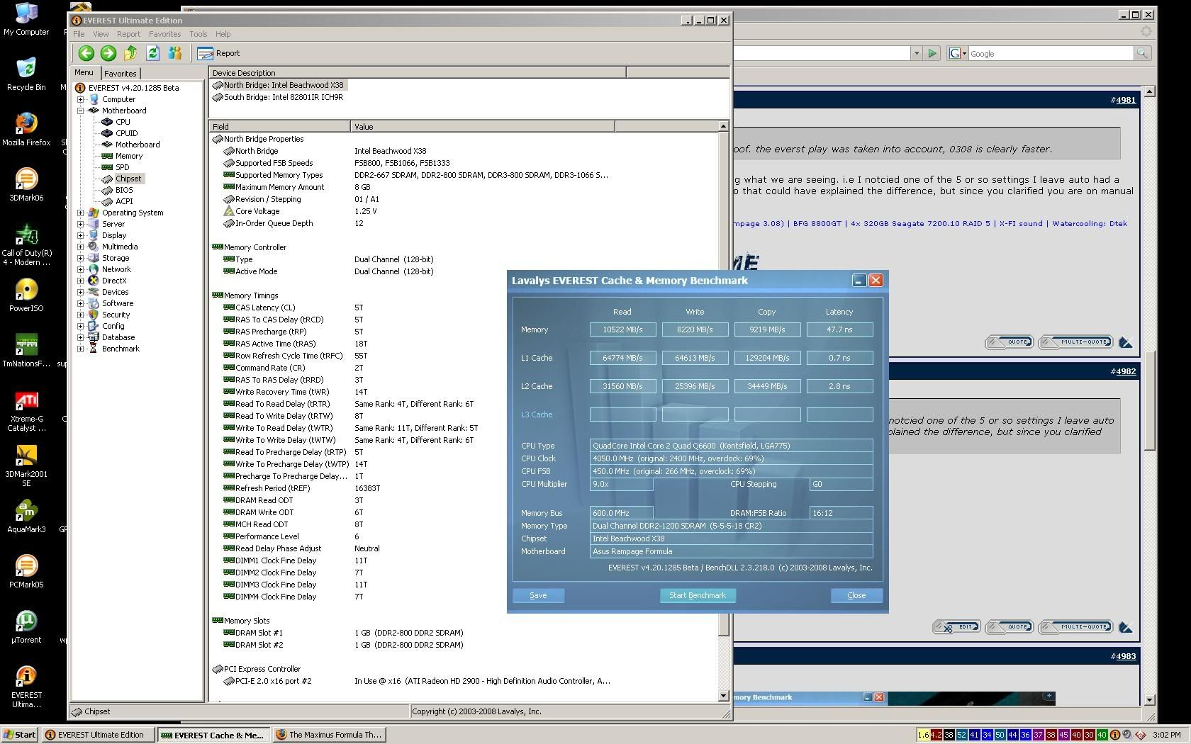

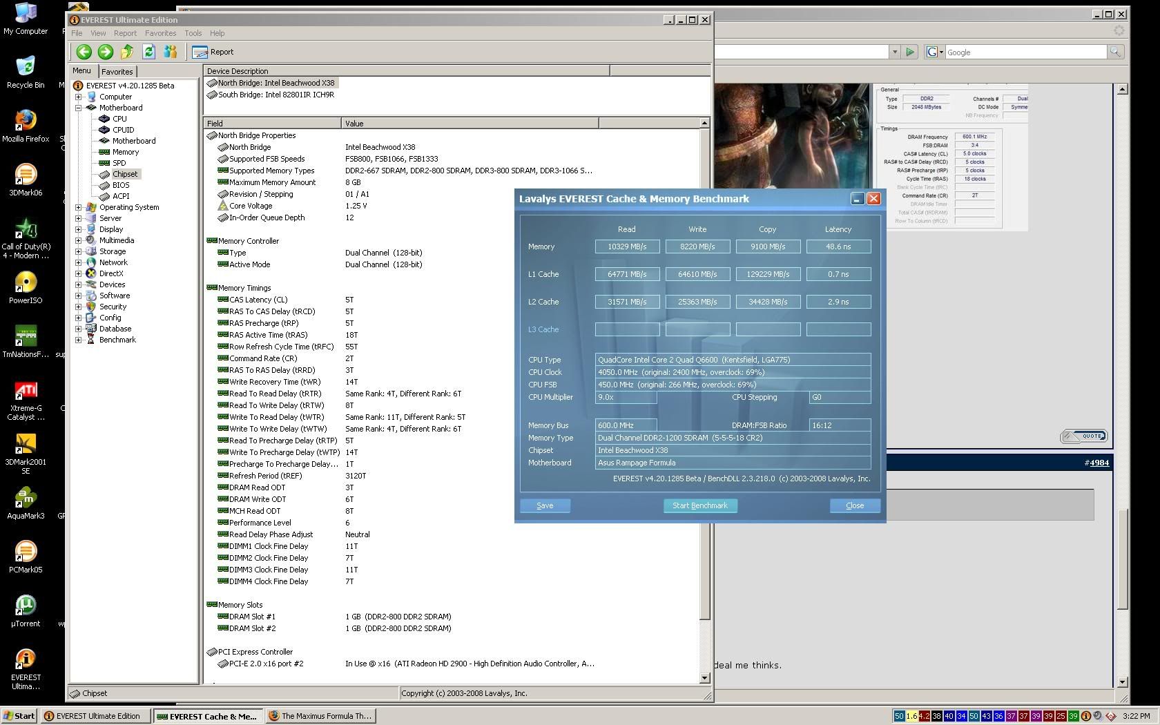

grnfinger
http://i48.photobucket.com/albums/f2...2976/prime.jpg
you want settings now or shall i prime longer? :shrug:
this is on bios 0308 btw. i get lower latency and slightly better bandwidth with this bios. i could let it prime for days, the temp wont budge :yepp:

0401
http://s48.photobucket.com/albums/f2...1revisited.jpg
0308
http://s48.photobucket.com/albums/f2...8revisited.jpg
same exact settings in bios. you are right, tref changed :)
