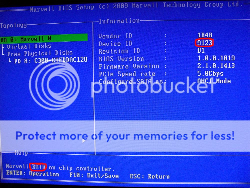

now Im up and running Ive looked in the marvell controller on post, now Im more confused than before.
As we know marvell 9123 does not support raid, 9128 however, does.
see here
http://www.marvell.com/products/stor...duct_brief.pdf
well check this
http://i696.photobucket.com/albums/v...ek/marvell.jpg
no doubt what that says right ??
So why then on the support cd and on the Asus download site, they are offering driver version 9128 in the sata section and in the "others" section they offer 9123.
any one have a clue ??
cheers
Rick

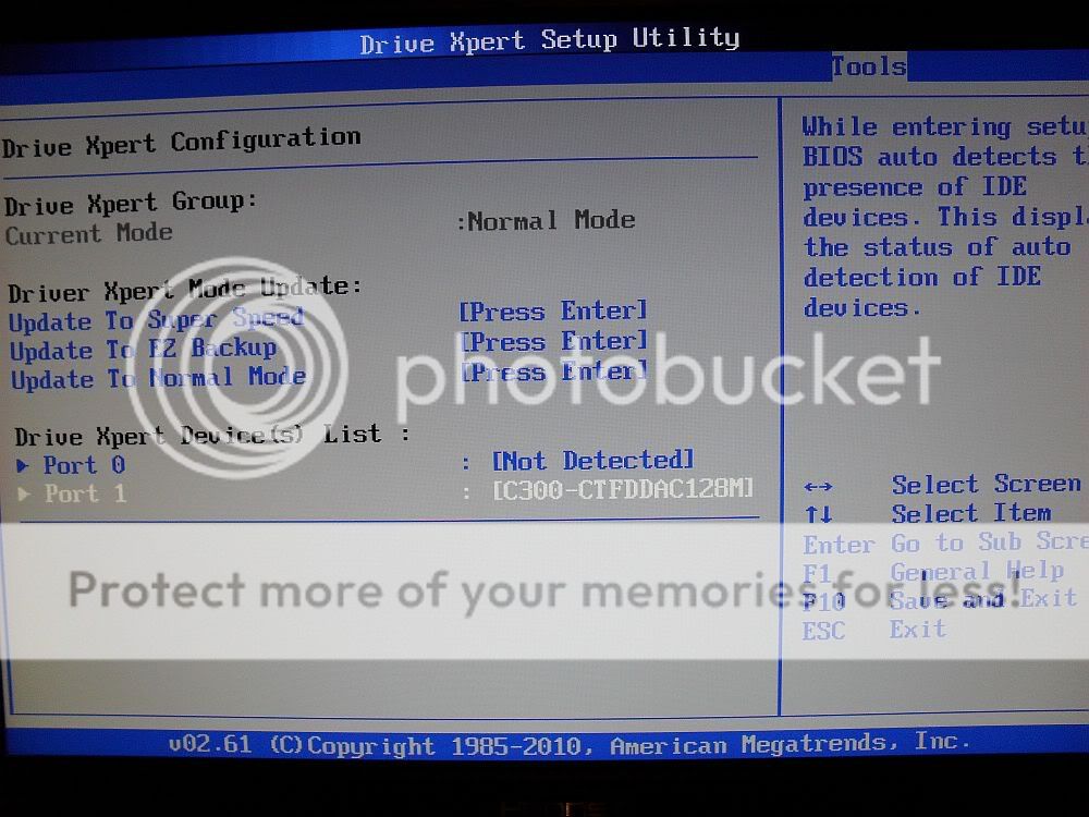

What options are in the drop down under "Configure SATA as:" Does it have a RAID option? I have seen people say they have it setup as raid, so yeah this is very confusing. its almost like maybe some boards came with raid and some didnt, lol....
nope achi or ide but check this out,

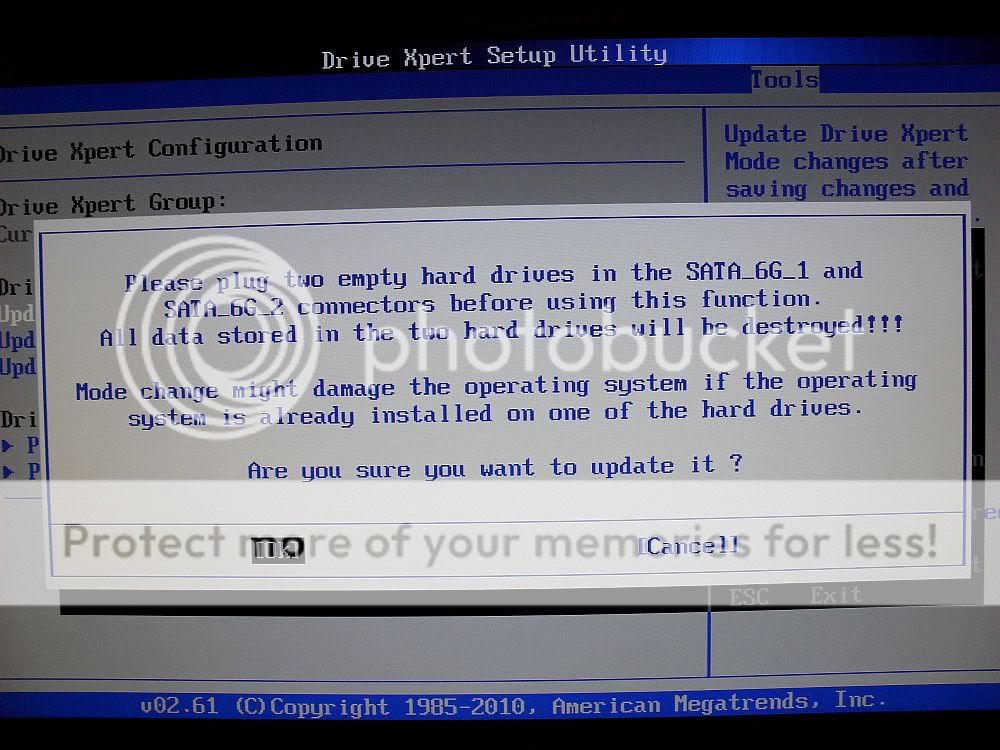

I was digging around and found drive expert and it gives the option to upgrade to super speed mode, dont forget this is shown as 9123, it says plug in 2 identicall drives blah blah .... well if that aint raid then my c..ks a kipper !!! :-)
http://i696.photobucket.com/albums/v...20ek/raid1.jpg
http://i696.photobucket.com/albums/v...20ek/raid2.jpg
make of this what you will, this is raid all day long

fmsam, hey I just looked at the marvell chip on my board and it very clearly says 9128 on it.
So theres our answer.... Typo in the bios bud... Its a raid chip....
EDIT a friend says he pretty sure Normal Mode is JBOD.
