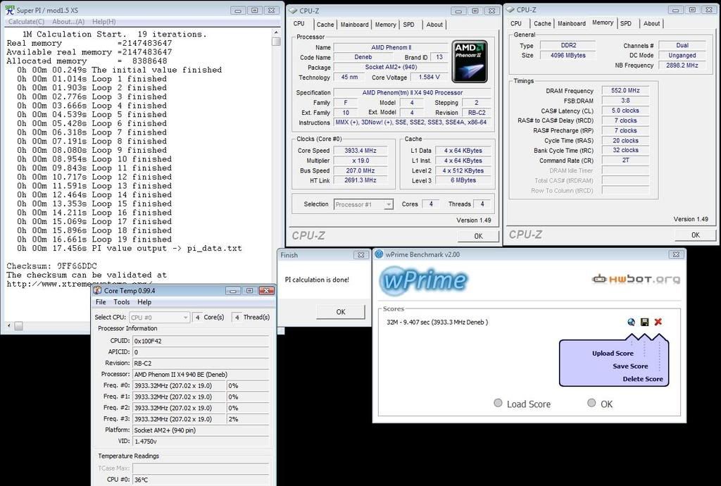

Ok try this for timing...
In Manual timing Mode @ the same Freqency your Ram is at Now,, Adjust Timing Use DTC0 mode only and change as follows.
Using the 800/667/533 or 400 ram divider you can run cas 4 pretty easy in Unganged Mode. Gives me best performance with 2700+ nb on my little B3:D
CAS ,, 4
TCwl ,, 5
Trcd ,, 4
TRP ,, 4
Leave eveything else on Auto even TRC...and yes you must use 4-5-4-4 for it to work , dont set 4-4-4-4 timing.

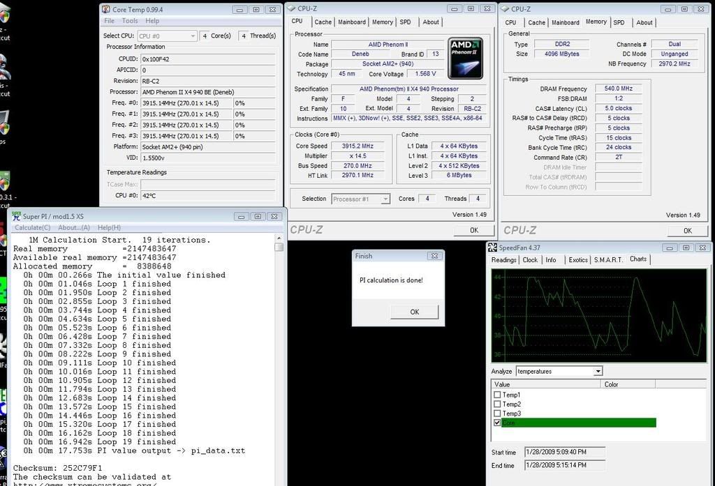

This will set 4-4-4-15 on any ram up to 1100mhz ..
The little lower Latency may help ya bust 17's,,
Hope it works for ya.
