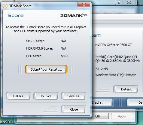

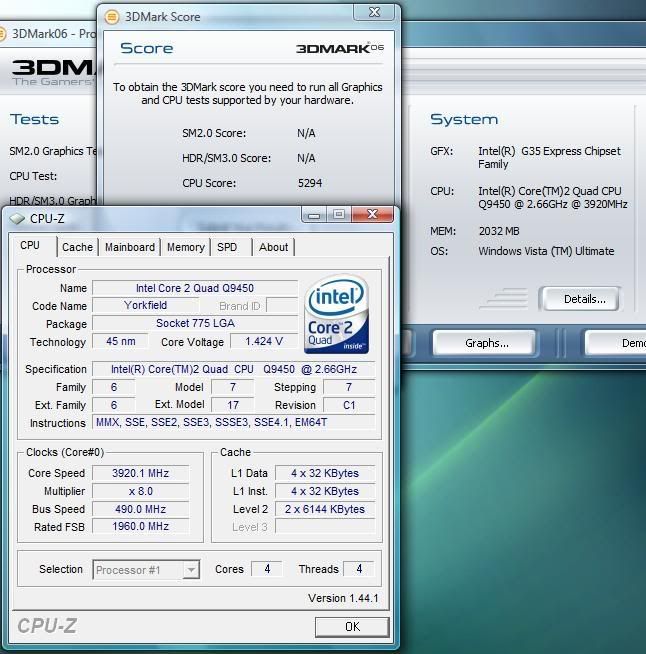

And... update. :) I find the CPU score significantly lower than 3.90GHz on the X3350 for some reason.
http://i235.photobucket.com/albums/e...06CPUScore.jpg
Edit: No GPU score yet... unless you want me to bench the onboard X3500 GPU?
Yep... definitely lower than X3350. Then again, I haven't... changed any GPU settings yet. Maybe the onboard GPU is limiting me. :D

Hi , is it worth me getting a X3350 chip to replace my 6600 go at the moment then or should i wait for better bios or a better board , got the maximus with rampage bios mod at the moment steady at 3.8 gig
@RunawayPrisoner, I dont think its the onboard GPU cuz I get around the same score @3.2GHz in 2D, 3D, Overclocked, Underclocked
51XX-52XX range even Underclocked got 5220 :shrug: 300-300 on the Gpu

X3350 3.9ghz @1.3875vcore in bios. Haven't tested for full stability yet. Thought about 4ghz, but not willing to go above 1.4vcore in bios. I will post screens when I get home later tonight. Its on a true Asus Rampage (X48) with bios 0219. Just did a quick prime run and it seems to be stable though.
Can you post your settings? Maybe it's worth picking up another P5K Premium again...
I'm not on the Premium. Bought a new board. Pretty much everything is on Auto since I have no clue what they mean or do.
Second Rampage board to get so far. Maybe it's not entirely hopeless. :)
As for what kind of voltages I need, stock on everything but northbridge volt, which is around 1.4-1.5 range for either 450 or 475. 1.6 for 500. vCore is in sig.
Edit: Oh yeah, RAM sticks are at 450MHz.
Which leads me to believe its all in the bios. The Rampage fully supports the chip out of the box, where as older boards simply have poor bios support.

This is how far I am willing to push. If anyone wants to push this chip any farther, drop me a PM. THis is on a true Asus Rampage. Not sure why flashed RF doesn't oc as well, perhaps it just wasn't designed to be that way? Who knows. Rampage feels even more solid than my P5K Premium and the Rampage is on the shipping bios.
Btw, its Prime overnight on Large FFT stable. I'm pretty happy at this speed.
