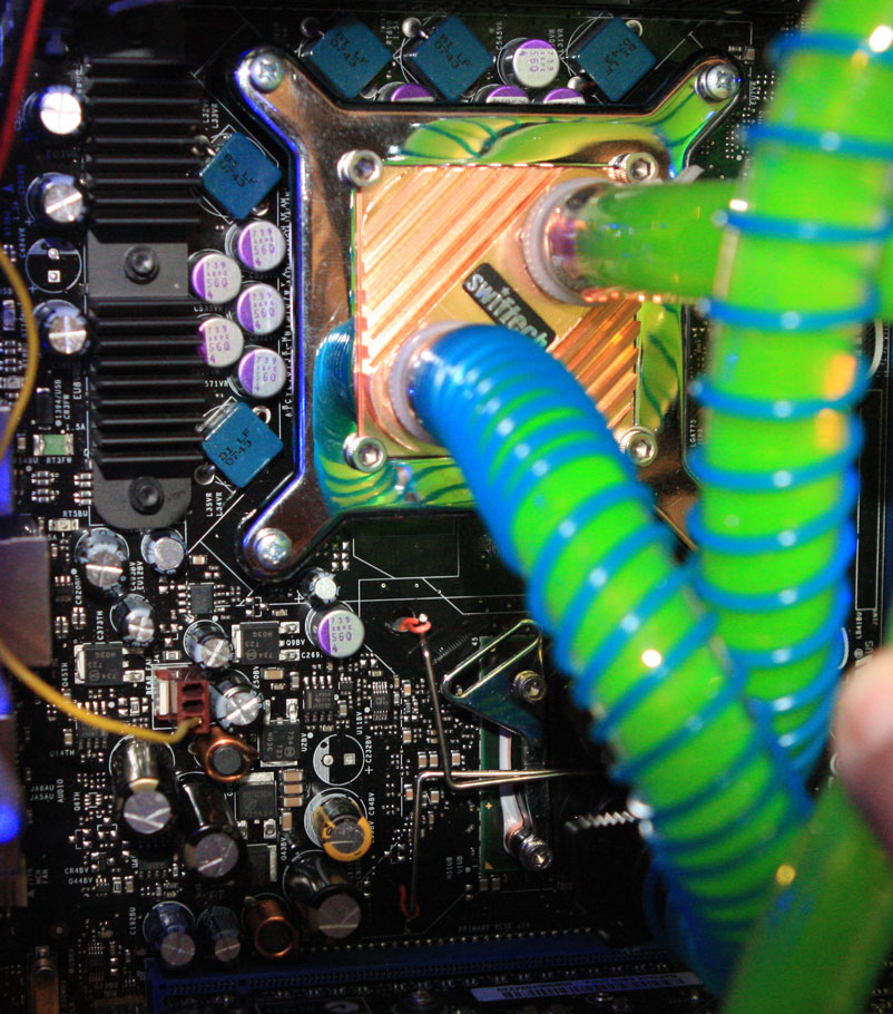

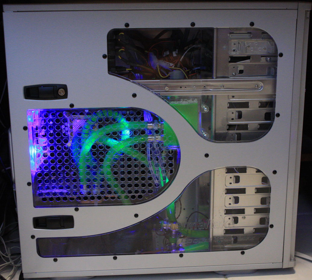

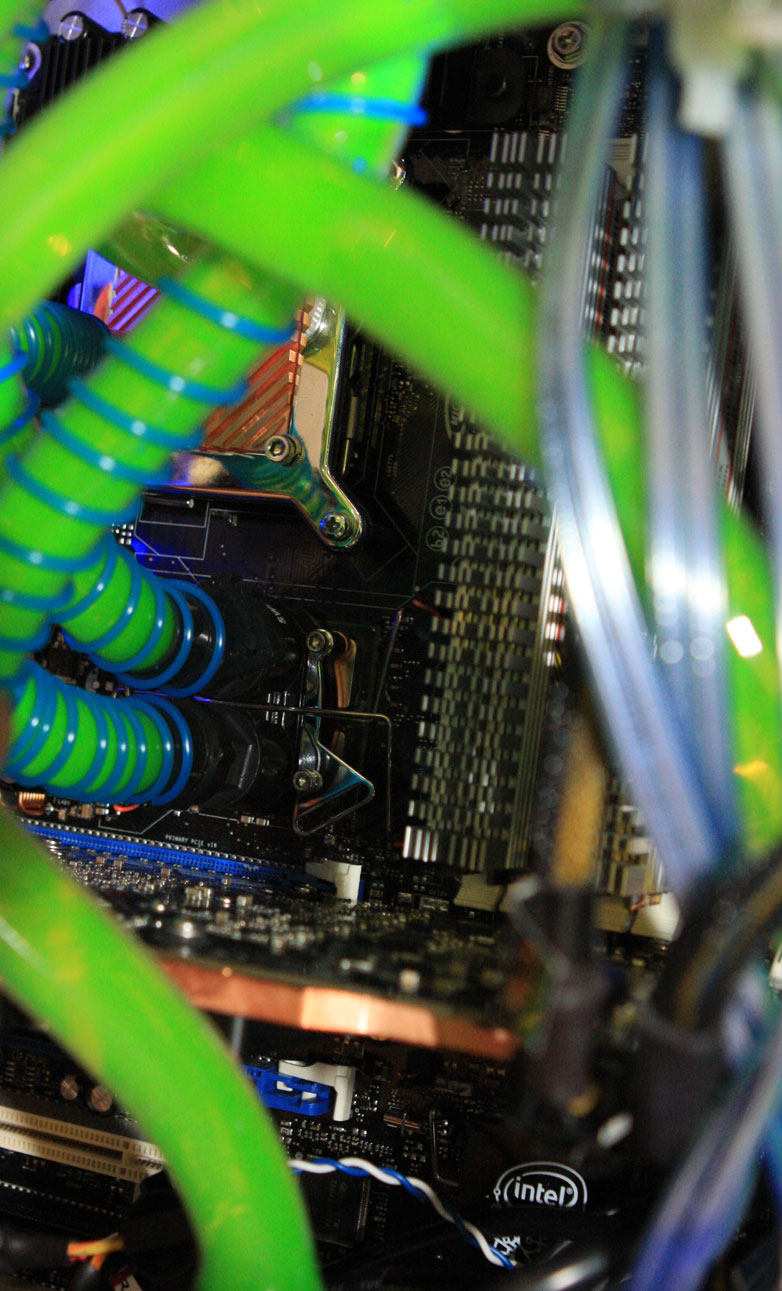

Below is my second WC setup, my first build was on a Maximus Xtreme. I get better stability on the DX38BT hands down. I would like to get some beter mem on board though.
http://www.dispensamatic.com/dx38bt1.jpg
http://www.dispensamatic.com/dx38bt2.jpg
Notice the MCW60... I used ethernet wire to make loops through the holes in the board :) ^^^^^^^
http://www.dispensamatic.com/dx38bt3.jpg
http://www.dispensamatic.com/dx38bt4.jpg
