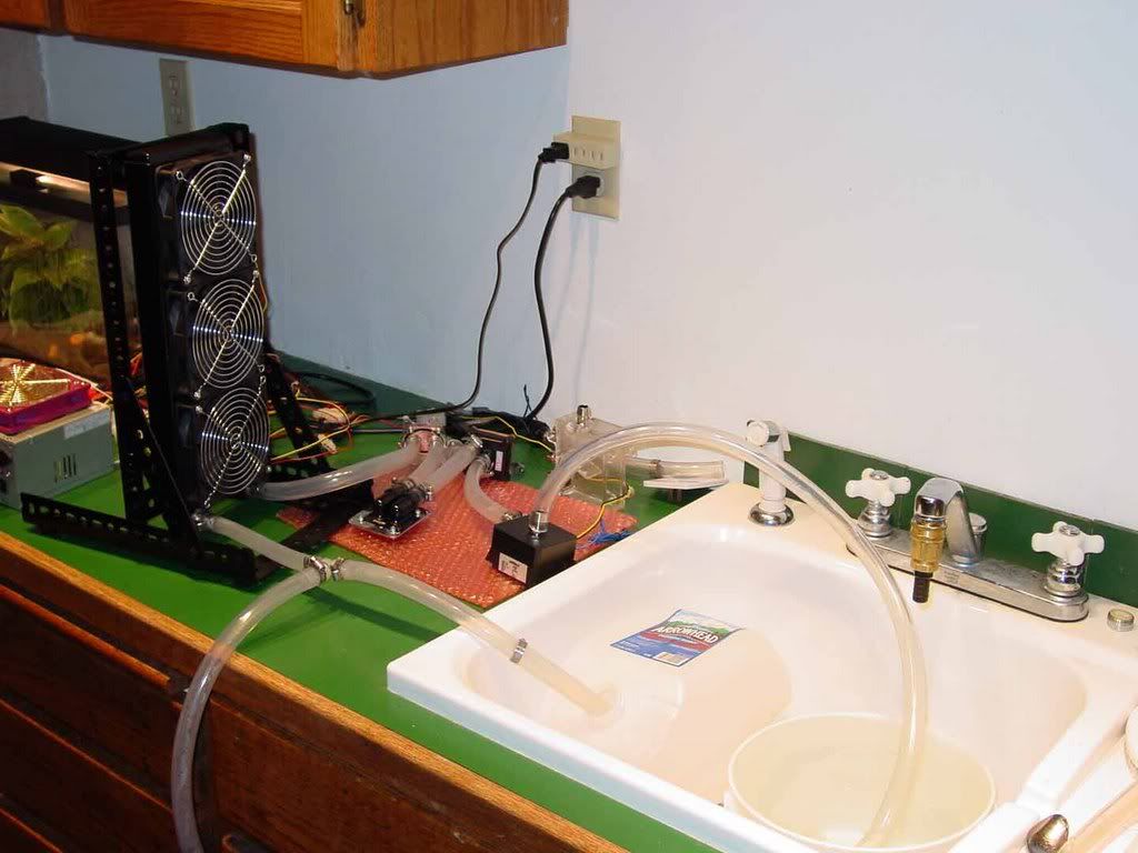

I'm flow testing my loop before putting it in the machine. Figured I’d add the data here since it involves Petra’s top. I’m strictly looking a flow, with full power to the pump. I used the actual parts of my loop to get a feel for what the pump does on it’s own vs what load the loop puts on it.
The full loop is;
MCR320 Rad>MicroRes>DDC2 pump w/ Petra top>Fuzion CPU block>MCW60 GPU block>DD Maze4 SPP (aka NB) block>Rad.
Test setup pic is below
http://i149.photobucket.com/albums/s...wtestsetup.jpg

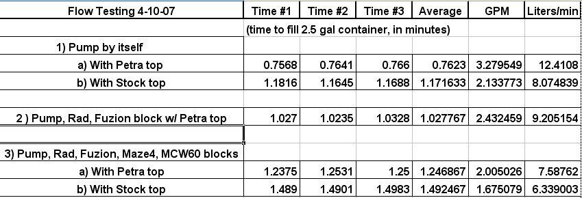

Here are the results.
http://i149.photobucket.com/albums/s...estresults.jpg
Edit - test #2 was done with only the Petra top.
Note that the Petra top kicks butt compared to the stock top. [:D]
Flow is very good across the board with the Petra top. I'm a believer....[:)]

I thought so too. I must say I was surprised that the full loop performed that well. That's why I did the setup carefully and with three time trials. The container I'm filling is a 2.5 gallon distilled water jug. Note that I'm running full bore on the power supply pictured. I was most pleased by the full loop numbers. I'm on generic 1/2 inch tubing on the test, and the only other thing is that I don't have the tube bends I will have in the case. The full loop test is repeatable, with consistent numbers. I've run this case before. I think the fuzion block is a wonderful thing....:)
Note that I'm sucking the water out of the bucket in the sink, therefore it's experiencing atmospheric pressure only, not city water pressure as if I connected straight to the faucet.
That being said, if you look at Alex's opening flow numbers on page 1, my pump-only number is actually a tad lower than Alex's result.

Yup the pump is sucking up...(no pun intended). But also look at the discharge tube. It going into the container at roughly the same level down from the pump. The siphon effect on the downhill side should negate the uphill pull on the inlet side, right?
Anyway, I just checked the 2.5 gallon container to see how close it was to 2.5 gallons. Using a measuring cup, it is 41.5 cups from empty, right to the tippy top, overflowing point. (Nice to know I'm not getting shorted distilled water when I'm buying it. :p: ) Therefore, do the math and you come up with me filling 2.5 gallons, plus 1.5 cups. So, my numbers are actually a touch low. Not enough low for me to go recalculate the spreadsheet (though I probably will anyway....).
For timing, I bought a digital stopwatch just for this test. My lab assistant operated the stopwatch while I yelled "go" and "stop". I think the times are good since there is fairly small variance in the numbers. I also double checked the math. It's good too. So, there you have it. The flow is the flow.
I think this also possibly shows that the FuZion kicks butt on flow?
I would like to see others get in the "lab" and do this. So far, I only know of Alex that has posted actual flow data. I would be curious to know how other blocks and configurations perform. Please point me to the thread if others have already done this. Thanks.
