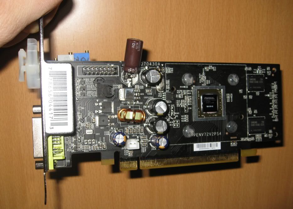

got my mutant in today
oohms you're a pro man :shocked: :up: :up: :up: :up:
http://img138.imageshack.us/img138/5469/56056298pd8.jpg
What brand is that?

My XFX GS got the full treatment last night, will post photos tonight to show my overkill.
Basically doubled every capacitor and put some even where there were none, the choke got a buddy, fully vmodded, and prepared it for LN2 pot mounting.

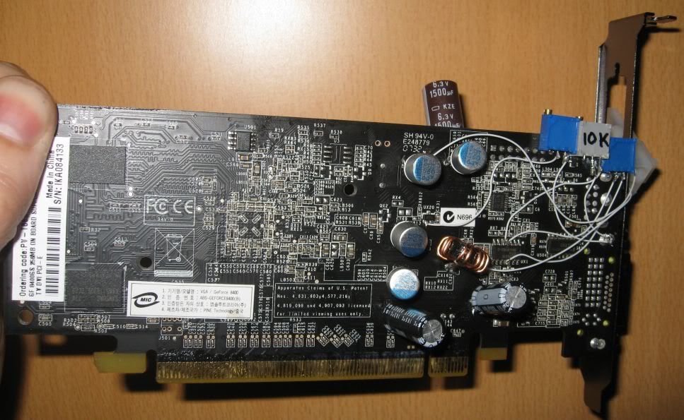

I realised that i forgot to post my OVP mod for the gigabyte:
http://www.xtremesystems.org/forums/...&postcount=301
(Updated my earlier post)
Tested up to 2.3v (on dinos' card :D ) but mosfets get pretty hot

Gigabyte ready to go :)
http://img134.imageshack.us/img134/5382/11111111is4.jpg

Watch the temp of those 2 mosfets who are on the left side of the coil, those fellas getting realy hot at high clocks and voltage, some cards died at 2.15v and some not even at 2.6....it's a bit of luck....external psu works a lot better.
Cool thanks for the tip there Rol-co, guess ill sink them with some stupidly oversized copper :D
Here's my first nights modding effort.
Looking now for any other cap locations i can add heh.
Once its all modded up it'll be completely plastic coated and stuck under LN2
http://img.photobucket.com/albums/v310/T_M/IMG_2835.jpg
http://img.photobucket.com/albums/v310/T_M/IMG_2836.jpg
hmm the only 2 caps on the right of the coil might be a little help.....the rest...dunno.
good luck.
