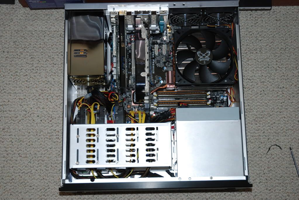

Edit: Put the new Zipang on the P5K premo, thought I should post a pic :)
http://img.photobucket.com/albums/v6...DSC_0022-1.jpg
