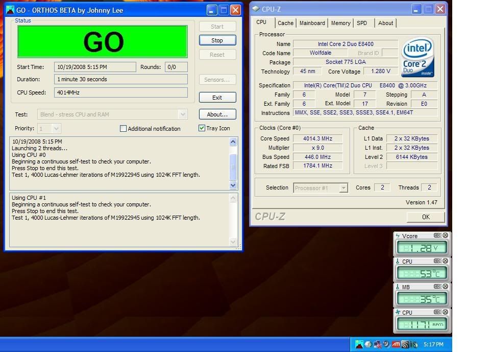

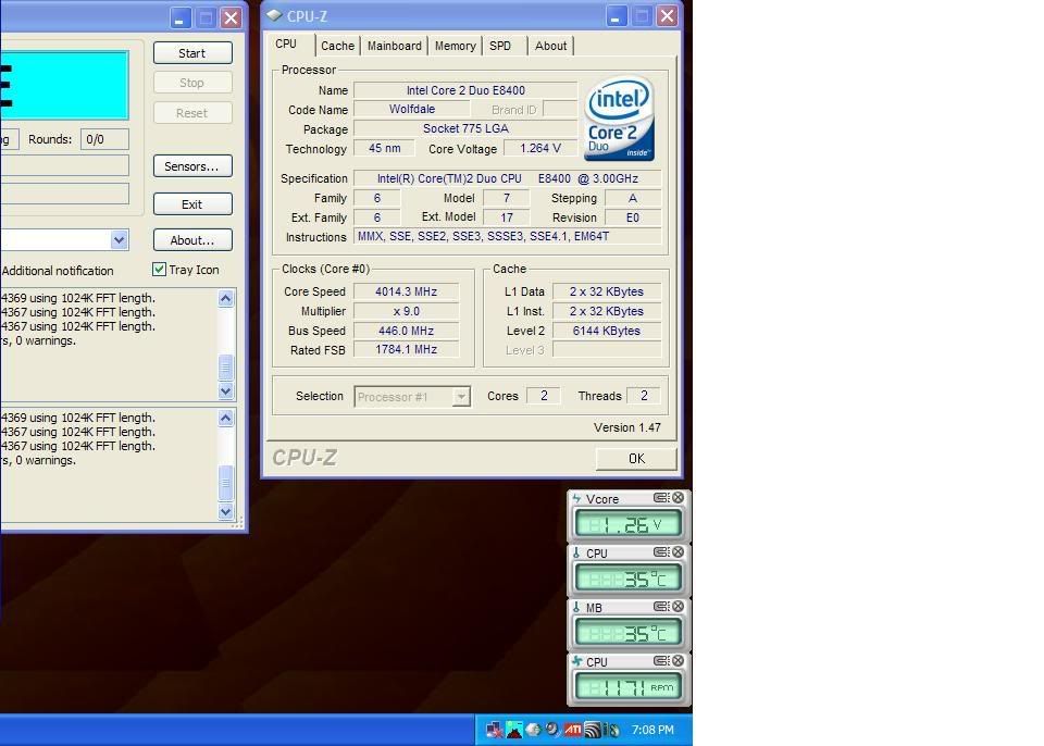

got mine a couple of weeks ago, and I have it pretty nice where I want it for 24/7 use, but would like to get it a little faster while maintaining lower Voltages and Temps...any help appreciated:
Antec P80B
ASUS P5Q-E Rev A3 Motherboard
E8400 E0 cpu
4x1GB Crucial Ballistix PC2-6400 4-4-4-12 (2.0v)memory
Scythe Infinity + 120mm
Radeon X1900XT 512mb (OC'd to 692/712)
XP Pro SP3
AI Tweaker
AI Overclock tuner: MANUAL
CPU Ratio Setting: 9.0
FSB Frequency: 446
PCI-E Frequency: 100
FSB Strap to North Bridge: Auto
DRAM Frequency: Auto
DRAM CLK Skew on Channel A1: Auto
DRAM CLK Skew on Channel A2: Auto
DRAM CLK Skew on Channel B1: Auto
DRAM CLK Skew on Channel B2: Auto
DRAM Timing Control: MANUAL
1st Information :
CAS# Latency: 4
DRAM RAS# to CAS# Delay: 4
DRAM RAS# Precharge: 4
DRAM RAS# Activate to Precharge: 12
RAS# to RAS# Delay : Auto
Row Refresh Cycle Time: Auto
Write Recovery Time: Auto
Read to Precharge Time: Auto
2nd Information :
READ to WRITE Delay (S/D): Auto
Write to Read Delay (S): Auto
WRITE to READ Delay (D): Auto
READ to READ Delay (S): Auto
READ to READ Delay (D): Auto
WRITE to WRITE Delay (S): Auto
WRITE to WRITE Delay (D): Auto
3rd Information :
WRITE to PRE Delay: Auto
READ to PRE Delay: Auto
PRE to PRE Delay: Auto
ALL PRE to ACT Delay: Auto
ALL PRE to REF Delay: Auto
DRAM Read Training: Disabled
MEM. OC Charger: Auto
AI Clock Twister: Moderate
AI Transaction Booster: Manual
Common Performance level 10
CPU Voltage: 1.28500
CPU GTL Voltage Reference (0/2): Auto
CPU GTL Voltage Reference (1/3): Auto
CPU PLL Voltage: Auto
FSB Termination Voltage: Auto
DRAM Voltage: 2.02
NB Voltage: 1.28
NB GTL Reference: Auto
SBridge Voltage: Auto
PCIE SATA Voltage: Auto
Load Line Calibration: Enabled
CPU Spread Spectrum: Disabled
CPU Clock Skew : Default
NB Clock Skew : Default
CPU Margin Enhancement: Optimized
http://i44.photobucket.com/albums/f3...0OClowtemp.jpg
http://i44.photobucket.com/albums/f3...ghze8400OC.jpg

ssabripo: I would drop your performance level to 8. You might need to increase NB voltage a tiny bit or run your memory at 5-5-5-12 or 5-5-5-15 but you should see better performance. Do some benchmarks though, don't take my word for it since I don't know what you do with your machine.
I'm doing about 11.5secs on 1M superPi, so it's not too bad.
I like that it is running pretty cool temps considering everything. Since I have an E0, I was hoping to goto 4.2ghz on air at pretty low Voltages and Temps, but 4ghz is fine for what I do.
just want to see where the limits of this machine is with as low temps/voltages as possible.
