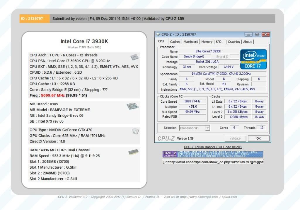

Spent a couple of hours messing around and here's what I got so far.
http://i1184.photobucket.com/albums/...0K/3930_51.jpg
http://valid.canardpc.com/show_oc.php?id=2139797
Tried to go higher (x53 @ 1.55v) but hangs on windows startup. Am using my "old" X58 G.Skill RAM DDR3-2000 in dual channel.
Cooling wise, I'm under water on a Koolance 370; load temps have yet to exceed 65 degrees (20 degrees ambient).

I'm now able to boot into windows with a 50x multi by setting clock gen to 20uf, llc to medium and vcore to 1.48. Run prime for 20min but crashes. Needs more vcore but temps are getting marginal; 74 on water. Would like to try running it with offset.
AI OC Tuner: Manual
Turbo Ratio: All Cores
All Cores: 50
Clock Gen Filter: 20UF (change from Auto)
Memory Fequency: Manually set to 2400
Vcore: Offset +1.05
VTT: Manually set to 1.25v
VCCSA: Manually set to 1.285v
RAM: Manaully set to 1.675v
PLL: Manually set to 1.95v
LLC: High
All other voltages and settings on Auto
Set DRAM timings manually to 11-11-11-31-2T (same as XMP but entered manually...all other settings on Auto).
