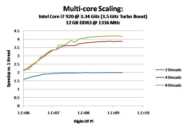

I ran some automated benchmarks on my Lan-Box to see how the new version scales with multiple cores.
Here are the results: Main Page
http://www.numberworld.org/y-crunche...raph_small.jpg
The graph shows how many times faster a multi-threaded run is than a single-threaded run.
Obviously, 2 threads cannot do any better than 2x improvement and 4 threads cannot do better than 4x.
When the computation is small, the amount of time spawning threads dominates actual computation time. Therefore it scales very poorly for small computations. The bigger you go, the better it scales.
Notice that below ~5 million digits, Hyper-Threading with 8 threads is slower than 4 threads without HT. This is because the benefits of HT is outweighed by the overhead of spawning double the threads.
So if you have an i7 and you want to get the fastest 1M, 2M, or 4M times, try disabling HT...
This wasn't the case in the older versions. Because of a number of optimizations and bug-fixes, v0.4.1 doesn't scale as well as the older versions for small computations. (But it scales slightly better for large computations.)

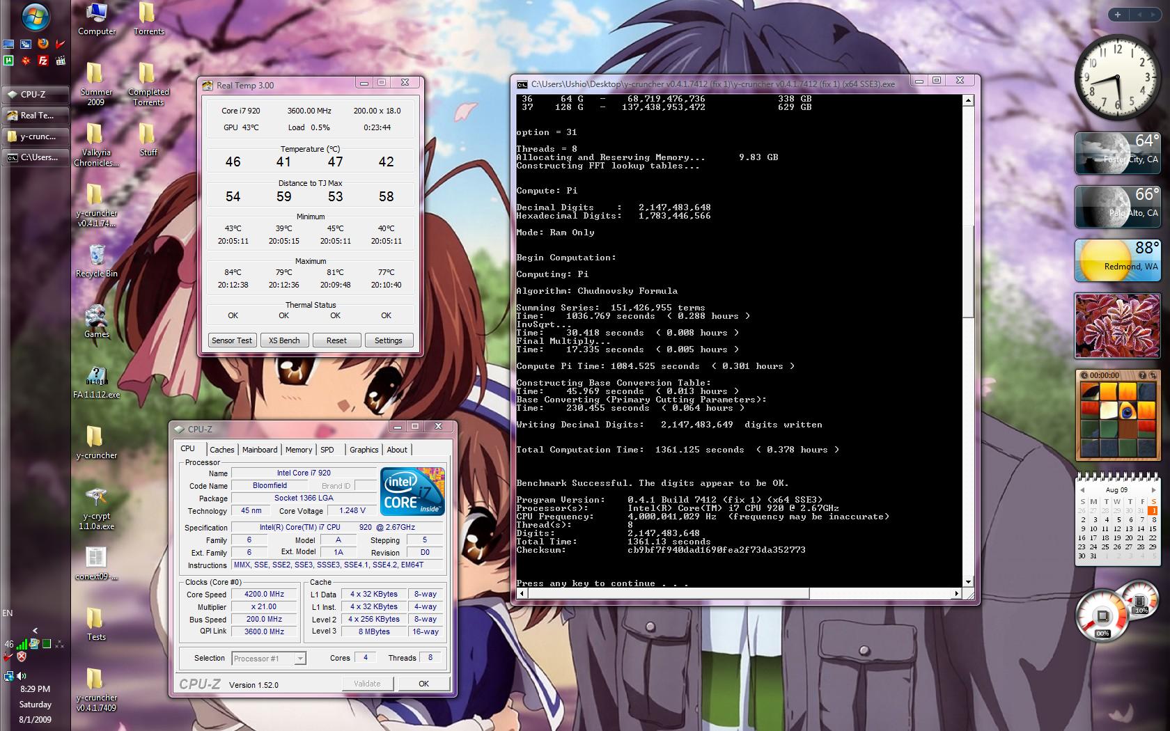

interesting results with SMT on i7. i think its hilarious your program can calculate 10 trillion digits of pi. is it stable after using more than 46 gigs?
That's 10 billion. Trillion has another set of zeros... (I lose count around that point too... :D)
Yes, the program is 64-bit. So it has no trouble using as much memory as it wants. As for the computer, it isn't even OC'ed so yes, its perfectly stable with 64GB no problems.
I know of one person who benched this program with 128GB of ram... (namely dual Xeon X5470 with 16 x 8GB DDR2 FB-DIMM)
The program will do a LOT more than just 10 billion.
The current version allows up to 200 billion digits. Though it's only been tested up to 31 billion.
As for what the "true" limit of the program is... I actually have no idea...
I don't see any major "wall" in the implementation until at least 10^16 digits...
But no computer in the world will have the ram or the computational power to test it - not even Road Runner.

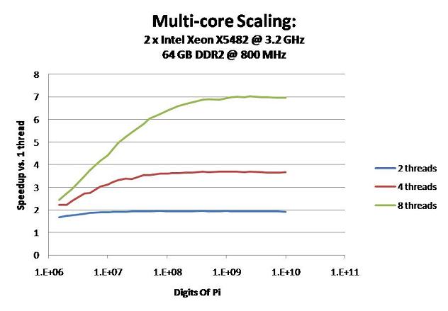

Main Page
Here's some very old results with version 0.2.1 on my workstation:
Scaling seems to hit a wall at 7x. I'm almost certain it's the memory bandwidth.
Main Page

Pi - by it's very nature doesn't parallel as well as wprime, or any other "artificially made" task.
Why your cores aren't kept busy 100% of the time can be due to several reasons:
- Load imbalance. Most types of scientific computing like this don't split evenly (or at least it's not easy to do so). So some threads will finish before others. When this happens, the threads that are done need to wait for the others.
- Not every part of the computation is paralleled. Fast operations like additions and subtractions are limited by memory bandwidth so they will not benefit from multi-threading.
- Thread creation and destruction have a lot of overhead. When the working size for a particular operation is small enough, the overhead of thread creation becomes greater than the benefit of threading. At this point, the program doesn't parallel it - hence less than 100% cpu.
- Refresh rate of Task Manager. Task manager and other monitors average cpu usage over a period of time. If the computation is small, there won't any period of sustained 100% cpu long enough to average a 100%.
The larger the computation, the smaller the effect of these inefficiencies, and the higher the cpu usage.
With 12 cores, you're probably gonna need to go above 1 billion digits to get cpu usage averaging > 90%.
You WILL need to go up to several billion digits to achieve sustained 100% cpu that can last a few minutes. Most people don't have that kind of ram so it isn't suitable as a stress-test unless you run multiple instances.
CPU usage can be improved if I allow multi-threading to increase memory usage... But that gets prohibitive after a while. This type of computing is already enough of a memory hog as it is. So I prefer the ability to hit larger sizes.
So in some sense, computing Pi is a benchmark that "more closely" resembles real-life scientific computing.

Core i7 920 @ 3.927GHz
SuperPi 32M - 9m31.187s
y-cruncher:
250M - 127.051s
500M - 280.013s
1 Billion - 616.635s
2.5 Billion - 4129.34s
http://i431.photobucket.com/albums/q...rsuperPi-1.png
It was trashing like crazy for 2.5b. I wasn't running anything else in the background other than my normal apps. I expected 2.5b to be hard on my system though.
